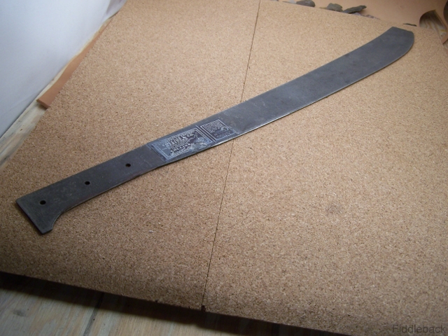

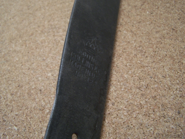

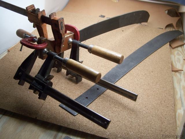

Some crazy machete loving dork found a good stash of 1950s collins USA manufactured machetes. He passed this wonderful information along to the back of fiddle, and a new sling blade modification was the result!

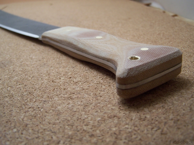

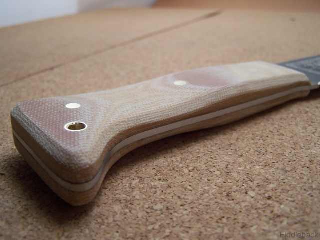

All done. Need thicker Micarta. 3/8" thick wasn't enough IMO, and so this one isn't going to last. But I'll post pics anyway. Later today.
Maybe you'll have to layer another set on there? By the way, do you have a bead blaster or sand blaster. Giving these a rough texture may save some time rather than buffing the micarta out.
I left the micarta at 80 grit. No sandblaster yet. Thats coming though.

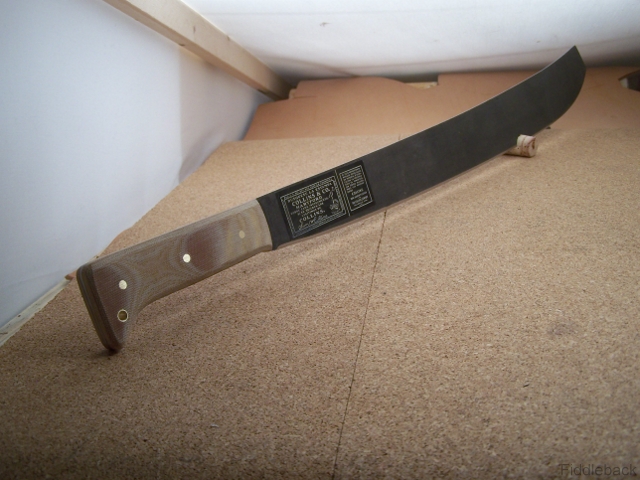

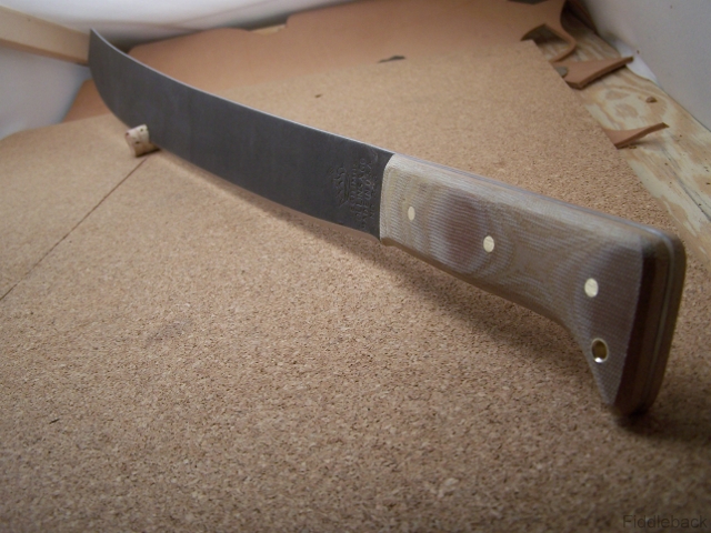

Eventually this service will include a bead blasted handle, and an oval section of the blade bead blasted so I can put a Modded by Fiddleback mark on it too. Right now this one is 3/8" thick natural canvas micarta with brass pins and a brass lanyard tube. I added the hole for the lanyard tube, so already, you can't get this anywhere else! This particular model is HUGE!!! 27" long OAL with a 22" blade. I left the original stickers on the blade. I've brightened up the spine, and sharpened and extended the edge. By extended, I mean I brought the edge down to the handle, so you can notch with the machete!
Works good. Took very few swings to get through this 1.5" sapling on my property.
Handle detail shots. Be sure to imagine the micarta thicker.
