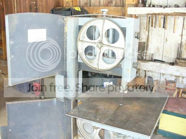

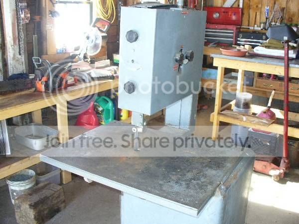

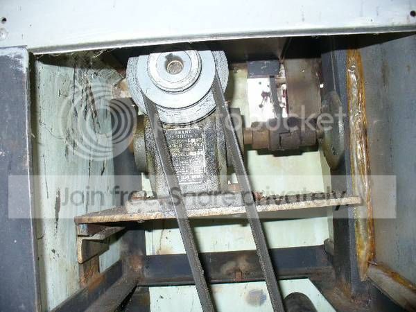

Anyone recognize this saw and more importantly does it look like a wood or metal cutting saw? check out the pulley pic?
OK, from those photos, I think that gear box shows it as a metal cutting band saw.
A photo of the gear box info, as well as a photo of the motor and its plate would clear up any other questions.
If it runs turn it on and see how fast it goes. That should help you determine its intended use.
With three speed ranges and a gear box, the only normal use would be metal cutting.
That's a metal cutter. Looks like an older Dake or Wellsaw maybe? Pretty standard vertical design across that style if you look at Jet verticals etc.
Nice saws. Long blades which means more real estate tooth wise so they last a bit longer than my little portaband... And the large work surface means you can fab up rip fences and such for nice straight cuts.
Good find.
-Eric
