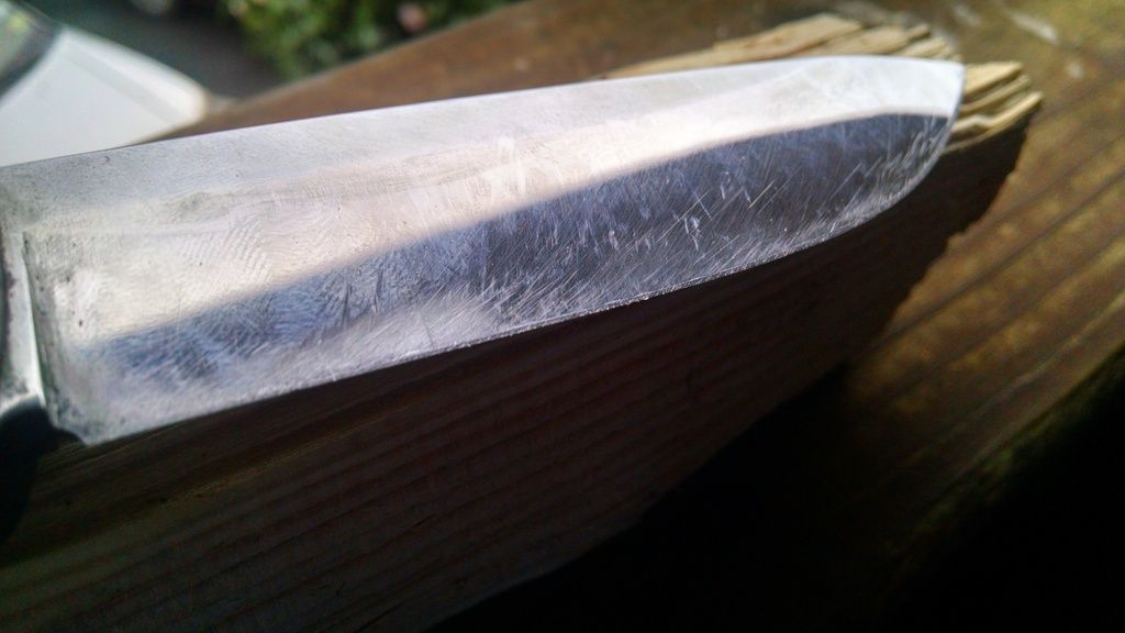

I'll update with progress
I use A2 steel frequenly when woodworking. I have A2 plane irons and chisels. I too got the same chipping out and had to resharpen at higher angles. That did fix it, but my conclusion was that A2 is not ideal for a good thin knife edge. I will never buy a knife in A2.
A2 is a very old steel, does well, but has been surpassed. Get the 3V version and never look back.
Shawn,
I did the same thinning out to my BR Bravo Necker 2 in 12c steel, only a little smaller than the Bravo. While not the same steel, a similar result when it saw a bit of lateral stress. Will hold up great anyway but only if I'm real careful with how I use it. I'm slowly thickening it up with each touch-up, am trying to keep it as acute as possible but build up lateral strength. I only want to make it just thick enough - it cuts so well when thinned out.
