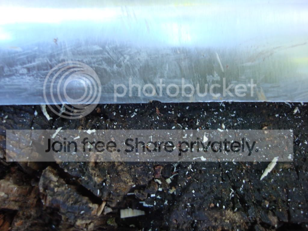

I have recently picked up a Bravo 2. Today I put it thru its 1st real work, I chopped a few hickory logs which were about 4 or so inches in diameter. The bravo 2 had a chip and several dents develop in the blade. What is Bark Rivers waranty? Will they take care of the chip. I did by no means abuse the knife. It is a great looking blade and I did not expect this to happen, but it did. I have many other knives that i have used much more than the B2 and they are fine. I did not expect chip just from some chopping, I guess I am asking you all where do I go from here? Thanks, BTW I will post some pics soon
here is 1 pic
From what I've heard, you should have no trouble returning it. BRK&T will likely re-sharpen it or provide a new knife if they deem it defective. It is an interesting observation. A2 rarely chips like you said it does. Pictures would be nice to see.

I will definitely keep you all informed, knife seemed to be awesome, until I put it to work. All I have used this blade for up to this point for is minor work. Hickory is hard, but no where near the hardness to cause blade wear.
I thought the B2 was stainless? That certainly looks like a chip and not 'damage' to the edge. But I bet that BRKT will grind that edge back to thicker steel and put an edge on it. It's still a serivceable knife once the edge is refreshed. Even Busse's have had similair damage threads and pictures.

The factory grind on the bravo 2 is very thin, more slice than chop. If you increase you angle when you sharpen that all changes, it will slice and chop.

Bravo-2 is made of A2; there is a SS-bravo-1 model though.
Wow, thanks for the picture. A2 shouldn't chip like that.
i've put my b2 through its paces and hasnt chipped. maybe yours was a fluke, atleast i hope so :D

I have beat the ever living hell out of many A2 Barkies. Even with thin edges, I never had one chip. My guess is it was an anomoly in the steel, or the edge was just a bit too thin on the grind. Regardless, even with "rotten in Denmark comments" which quite frankly need to be ignored given the EXCEPTIONAL reputation for customer service that Bark River has, they will make it absolutely right for you. Trust me, I know. I have many of their knives and every so often one will get through that just isn't quite right. You may have one of those, but it still sucks to be without it for a week or 2.

My guess is that the edge was just ground too thin - since all the blades are hand ground, it does happen sometimes.

As with everything it's always gonna be a compromise of sorts. I've got Scrapyard blades and Swamprat blades that can chop through car doors without damage but that is because their edges are left so thick, can they cut as good as a thin convex edge such as those on a Barkie.....no way !!!
I did hear from a respected knifemaker( who asked not to be mentioned ) that he has had a lot of Barkies sent to him with similar damage for repair, however this is going to occur anytime you take the edge down that fine. At least BRKT stands by thier products and offers great service in putting right any damaged blades !

Don't get so wound up TB. You know I have lots of barkies, and they are great. I meant it because this is not the behavior of A2, or a barkie, so something else is going on.
