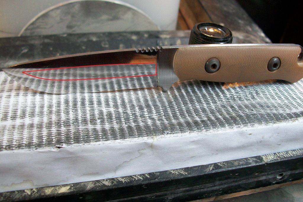

Depending on how you plan to maintain the knife, you could work it out over time, just make sure to spend extra time grinding above the final approach to the edge (area inside the red outline below), and melt the microbevel back into the primary. Over time the microbevel gets worn away and the edge becomes more acute. It is very important that the area above the edge be ground back as you go anyway, or the edge becomes less acute. In your case you're trying to fix the grind, so that little bit more has to come off.

Since the knife is brand new and no budget blade, you might consider having it done by a pro or send it back to BR. There's a good chance they'll do it for the cost of shipping. Maintenance is a lot easier on a knife with the grind set the way you want it. If its going to be a user, you might as well roll up the sleeves, as the cosmetics are going to take a hit anyway until you get some experience. It isn't that tough, the above pictured knife is the first BR I bought and it came with a microbevel. In fact I actually put a small V bevel on it at one point early on before restoring it to a proper convex.
That looks like an awesome mirror what stones did u use
In that pic I was working with a jig I'd built for my belt grinder to do precise convex, that one is 0° at the spine to 12° at the edge prior to finish stropping. Norton Blaze 60 grit, 120, and silicon carbide 320, 600, and finished it off on one of my Washboards with the stock compound (that's the surface its sitting on).

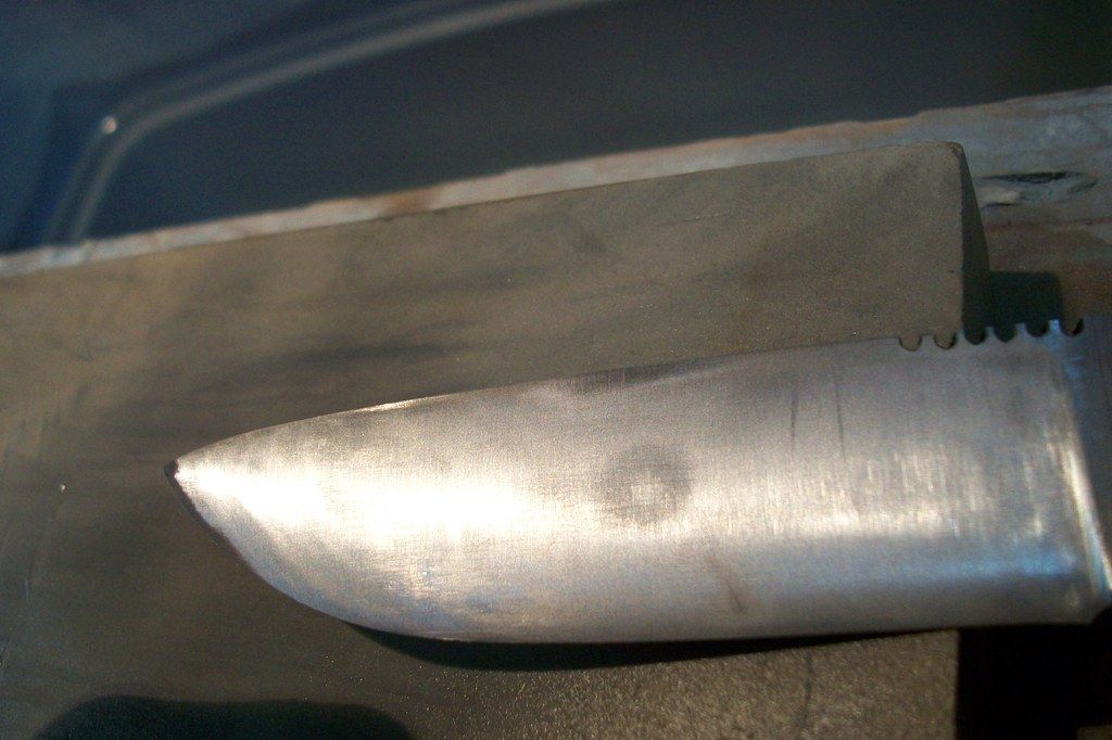

The pic below is the same knife before I ground off the last bit of flat along the spine and completely de-blacked it, done on Norton waterstones. Still a little hazy but not bad.
The knife had a small spot on one side of the blade where it looked like a glitch in the HT that showed up anytime the surface wasn't bright polished (pic below), so I decided to give it a full make-over. Is one of my favorite EDU's, I've had it for years.
