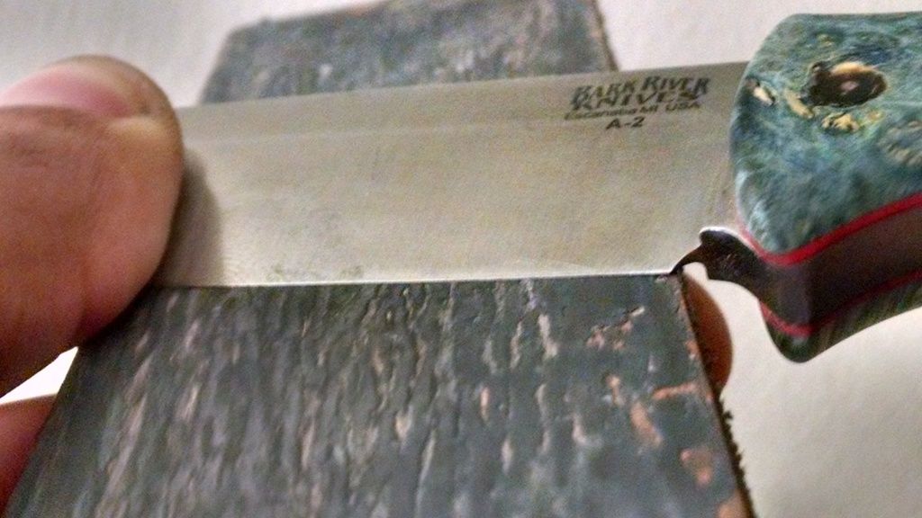

I'm using the field sharpening kit from Knives Ship Free that comes in a waterproof box. Not sure how to post a picture though.
Here a close up of the micro bevel on my Bravo 1 A2

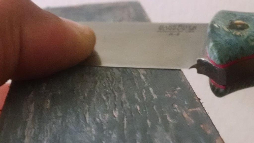

If you lay the knife on its curvature closest to the edge there is still a slight shadow
Do you see the black line between the knife and the strop? That's the cutting edge not reaching the strop to get sharp.
Solution, simply lift the blade until the shadow disappears.
Use light pressure (almost none) and move from tip to heel on each side slowly and observe eash pass for contact. Do alternating strokes 10-20 times.
Reassess by slicing paper for any rips or snags while cutting slowly.
