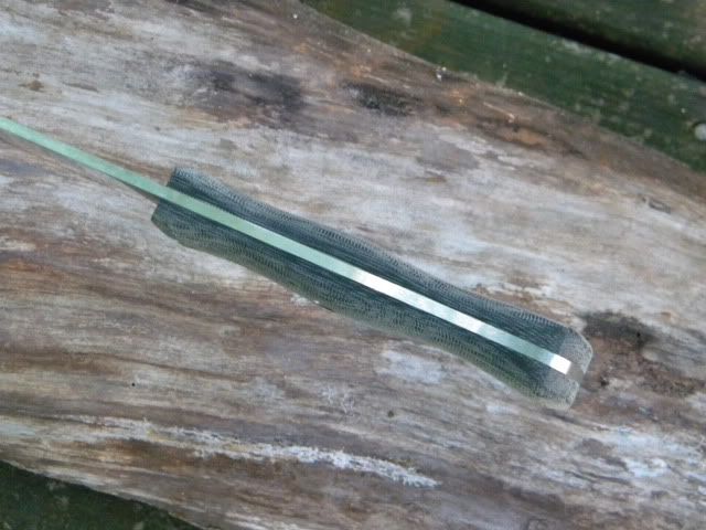

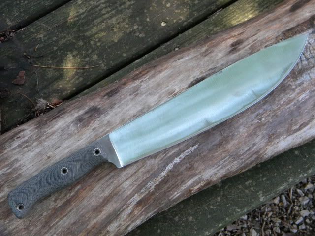

I finally got to field test one of these machetes over the weekend and I have to say that it performed exceptionally. It would easily clean up to 1.25" limbs in one hit. It is light and fast enough to clear thin and woody vegetation as well. My testing was done on Eastern hardwoods such as: maple, oak, and hackberry. Edge retention was very nice as well. The thin, blended convex edge is definitely the way to go. The knife is capable of heavier chopping duties also.
Specs:
.150 CPM 3V
17.875" OAL
12.375" blade
2.375" wide at its widest
FFG to a thin, blended convex edge
Ht by Peters to 59-60 Rc
Black canvas micarta handles, nicely shaped and contoured, held on by three stainless flared tubes

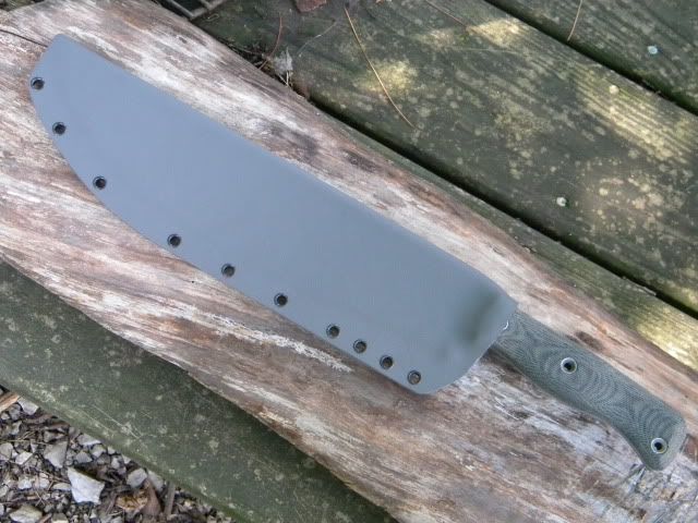

Comes with Gray Kydex sheath, large Tek-Lok compatible

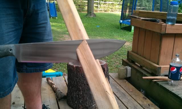

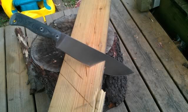

I did not have a 2x4 on hand but I did have a 2x6. Here is the damage. I did three hits for consistency. I took two pictures but all three went about the same depth. I don't have a 20" axe to compare to. Hopefully the pictures speak for themselves.
