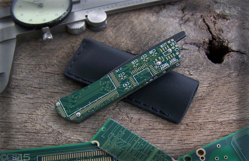

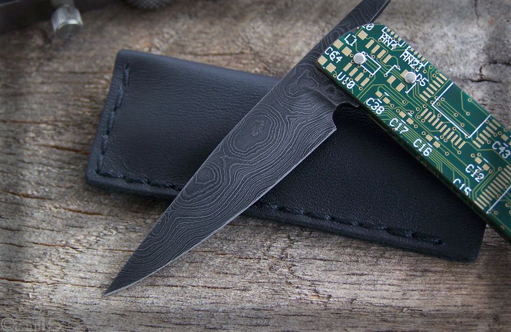

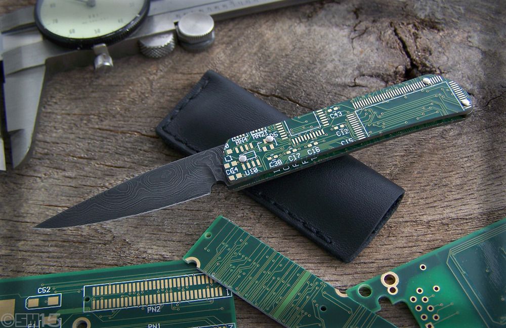

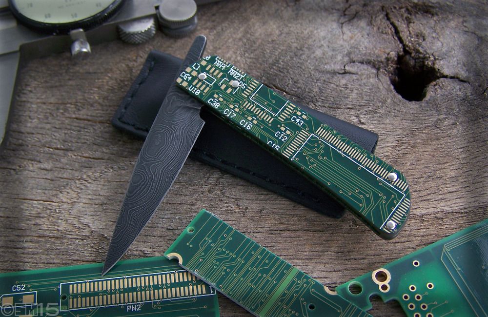

Here is a friction folder I finished a bit ago. This is my Barracuda style.
The circuit board is about 1/16" thick and has never had any components soldered to it, so it is smooth.
• my damascus [15n20 + 1084]
• circuit board handle
• 15n20 spacer
• stainless pins
• bronze washers

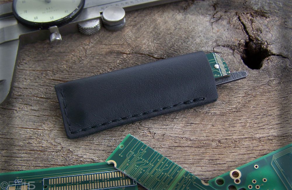

• leather pocket sheath
• 4 3/4" open
• 3" closed [including flipper]
• 3/32" thick at spine of blade
• approx. 2" blade
Thanks for looking. I hope you all like it.

No liners under the PCB scales? I guess circuit boards are strong enough for a knife this size, but they flex a little bit as well.
