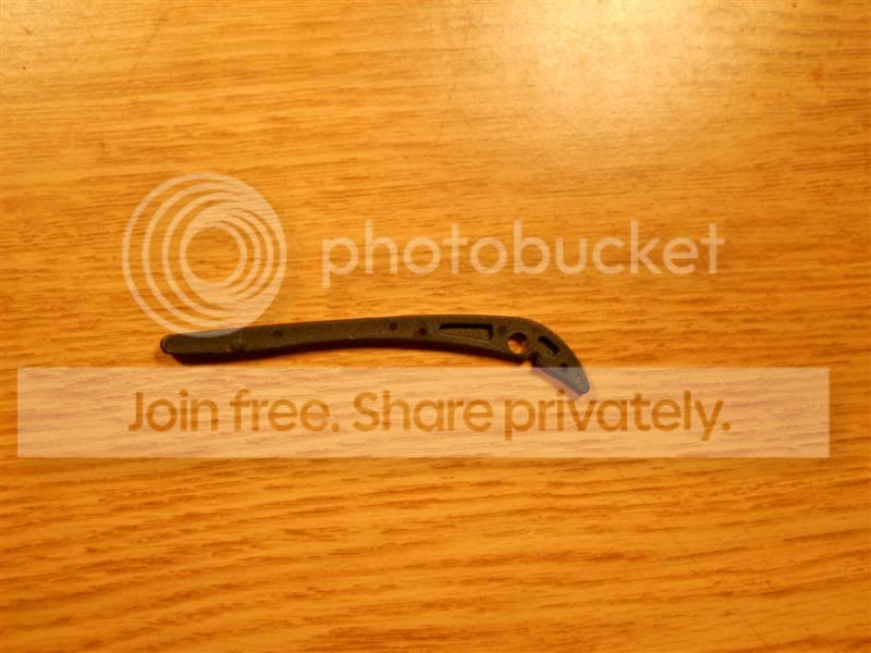

The hardest part of the change over was getting the plastic spacer out. It has tabs that fits into holes in the liners. Kind of a pain but I was able to get it out without fully removing the pivot screw.

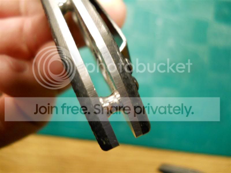

And to answer Ranger Knif's question - they are .157 long, and when I measured the spacing using my dial calipers before I disassembled my knife, I measured about .160. After I got the plastic spacer out I measured it and it is .165. Don't know why I got the discrepancy, but at any rate, the .157 spacers still worked fine for me. To elaborate on JNewell's answer, the 710 uses a single long screw that goes through the spacer and goes into a threaded nut that is embedded in the scale on the opposite side.

As promised, here are some pics of my 710 D2 with the spacers I purchased from Jantz Supply, and a pic of the original plastic spacer:
The spacers are 4 mm or .158", but I think most places sell them in the 4 mm size, not the SAE equivalent.
