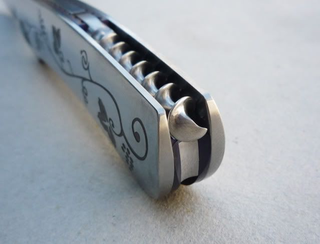

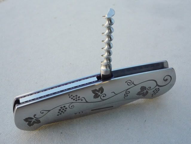

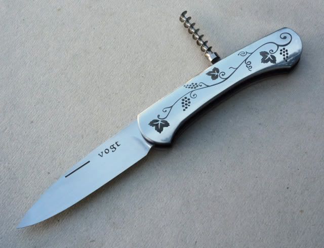

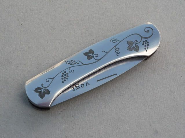

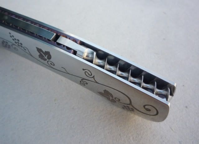

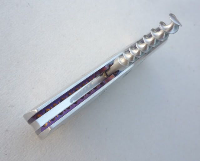

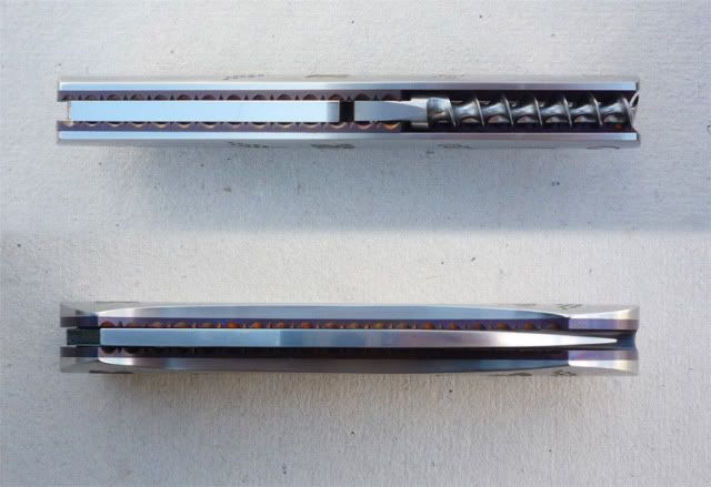

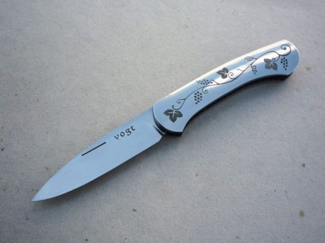

Well, I'm here again and I wanted to show a small folder with corkscrew.
It was my second slijoint and my first bartender knife, so it was a nice challenge!
In fact, was a trial for an ambitious proyect... but that's another story.

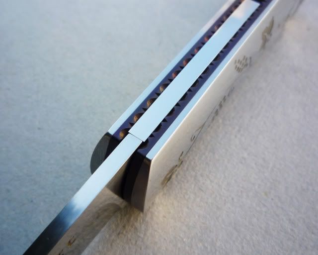

Blade steel is 420 stainless, satin finished. Corkscrew and spring are 420 too.
Titanium liners, with filework and heat colored.
Scales are Sandvik 12c27, with a small engraving (electro etched) in a vine design.
Blade: 75mm / 3"
Closed: 97mm / almost 4"
Total: 172mm / 6 3/4"
I hope you like it!
Javi

Javier The knife is very nice I would love to know what tool you used to make the cork screw

The grapevines really put this knife over the top man.

David: I made the corkscrew with a 4mm diameter chainsaw file.
Javi

Javier, nice work as always. A sober and delicate piece. :thumbup:
I suspect there is something in the same style to show soon ..... and even more interesting ;)
