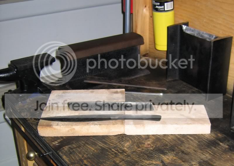

Here are a few ideas...
Sanding paddle and strop bat...
If you use waterstones, here's a cool set up I learned from Murray Carter...
If you forge... I made a hot cutter out of an I-beam (on the left)... works great...
