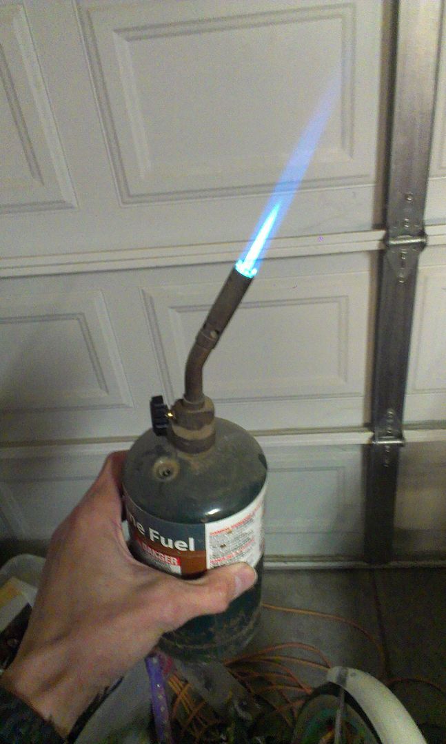

Hey guys, I'll be building a new 2bf soon. I have a couple of torch heads that I got years ago.
I know it's hard to tell, but from the pic, do you think this type of head will work with the forge?
I'll buy a higher output torch if these aren't good enough, but figured I'd use one (if it'll work) since they are free.
Also, is a tc and pyrometer usable with a 2bf? I don't see it mentioned much, I guess because it's hard to regulate the output from the torch?
Thanks
Not even close. That's a pencil tip torch, putting out about 3000 BTU. In my forge, you can get to about 1700° in one spot with that type of torch. That's on the cold end of forging. You can probably get a full blade up to about 1400°, not enough to HT.
