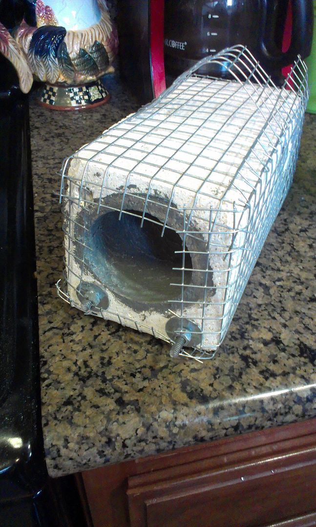

Well I mostly got it finished before the yard people came and I had to close the garage.
Obviously it still needs a little work, but here's where I'm at.

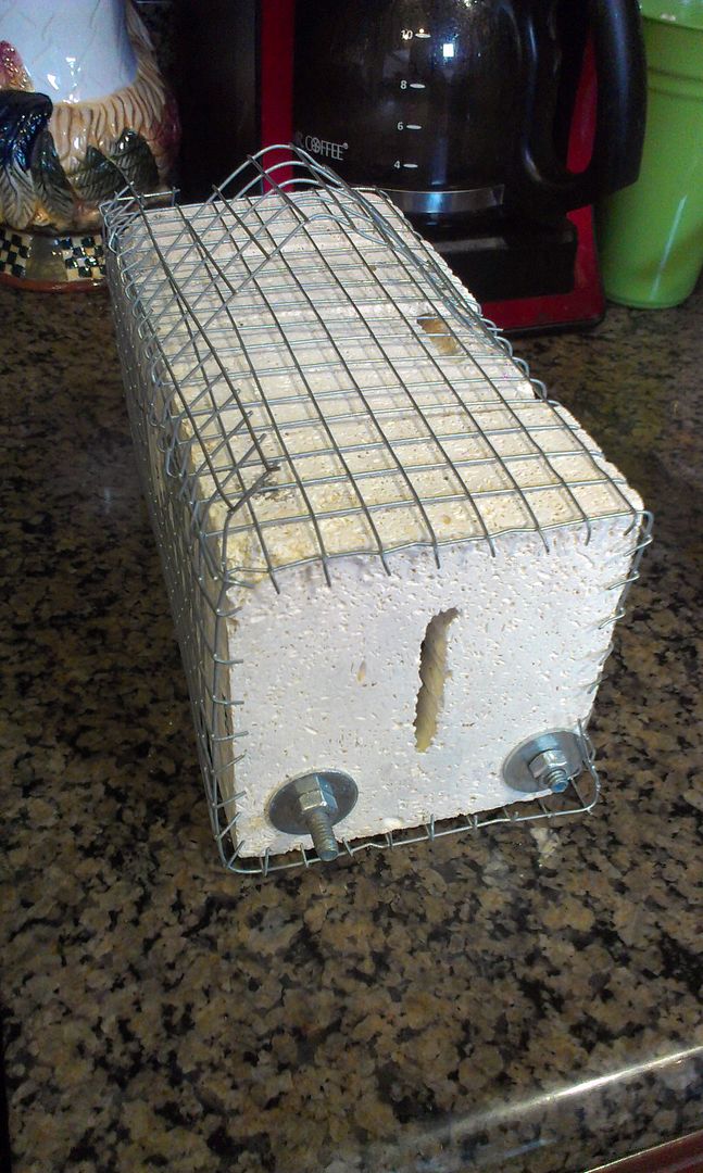

I'm not sure if I read the wip correctly. I read over it a few times, but couldn't really figure out what the pass through on the back block is for. I mean you put a blade in there, but why is the other end open?
In any case, I have a great deal of confidence that this is going to work really well. It's really sturdy, much more than I thought it would be.
I couldn't do a bolt at each corner, but the two that are there seem to hold it together nicely. I imagine that anyone building one will need to make some alterations, but I think it's close enough.
Now just to wait until tomorrow for the cement to dry then I'll fire it up. :)
Edit - oh also, if I had to do this over again, I'd probably spring for (or borrow) a hole saw. I ended up cutting up a can that had spray whipped cream in it. The can was roughly 2.5" in diameter. It would have worked better had it been more sturdy. I file sharpened the edge and it cut okay, but the holes didn't perfectly line up. Fixed it mostly by sanding, but the cement probably would have filled the gaps just fine.

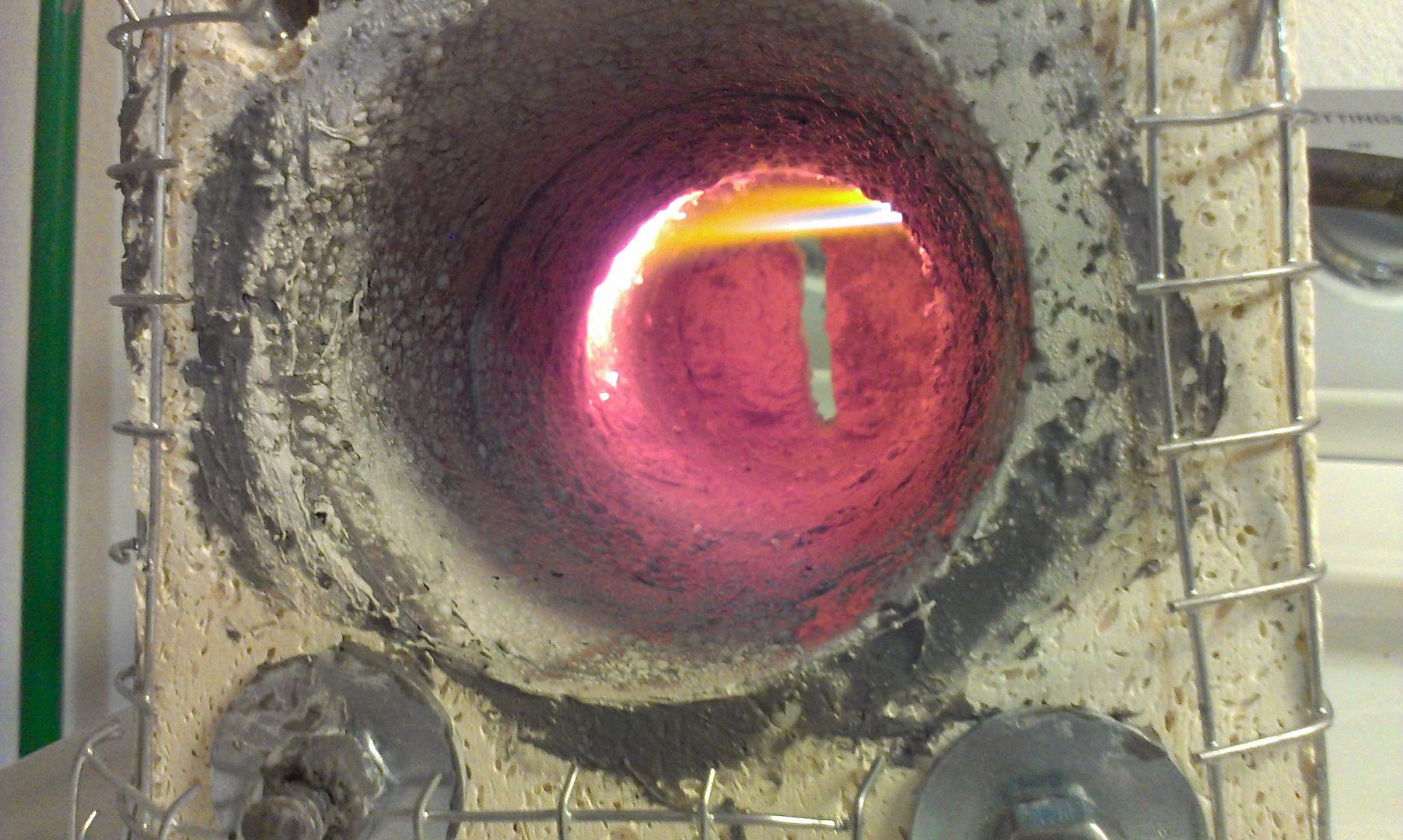

I haven't hooked up the Atlas burner yet (working kills all of the fun), but even with the little torch from above, the thing gets pretty hot after a few minutes, and I'm getting a good swirl.
With the big burner this thing should be quite intense!
Can't see the swirl in the pic, but it's there.
If I plug the open end it'll take a couple of inches out of the volume. Pretty sure that it could get a small carver (2-4" with tang) up to temp.

Doesn't matter though. I plugged it earlier this morning (fit was good with no apparent heat loss), but as you correctly pointed out, the little torch isn't enough it seems. Might be good for something, but it probably isn't enough for anything short of a tiny blade. Even then, I had to get the point directly on the steel (scrap 1095, not the steel in the pic) to get it past non-magnetic. Definitely not what I wanted, which means the burner that you sent is all the more valuable. :)
Good deal. Time to get more heat in the chamber!

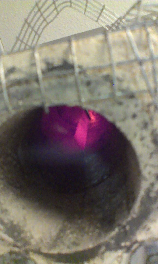

I was messing around with my forge and got two of the little burners going. Got my scrap piece of 1095 about a shade past non-magnetic, then quenched in warm water. The blade skipped a file and I decided to snap the end off to have a look. Yes, I know that this is far from ideal, and have no plans to sell anything.
I doubt it means anything, but the grain seems very uniform and small. Actually, no real discernable grain, but I haven't really looked at it under magnification.
I'm just wondering if this might indicate success. If so I'll go ahead and do the same with the carver.

Sorry, I missed the question earlier. The port on the back is dual purpose. First, it lets you put a longer blade through. More importantly, it allows gas to escape through the rear. This makes the back of the chamber hotter. If you put too big of a hole, all the hot air will blow through and the chamber won't get as hot.
Thanks zaph, I didn't realize that. Makes sense. :)
