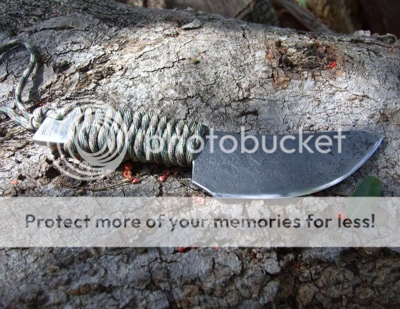

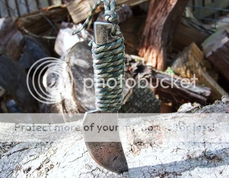

Ok I got bored (laid off from work a couple weeks ago) and decided to make a basic knife from 5160 that can be touched up easily with just a river rock or any gritty surface, can slice well and do basic chopping. I wanted it to have a primal look to it so left it in hammer finish, came out pretty decent I think and was outside toying around and batoned it through a 2.5" piece of wood to make some kindling. The cord wrap is standard 550 paracord with internals intact, I used around 6' knotted around it so it can be undone for survival purposes.
Blade length: 4 2/8"
Blade thickness: 3/16 at top of cord wrap (slightly thicker under the cord)
Overall: 8"
Let me know what you think
