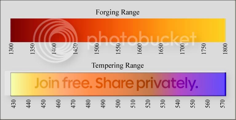

Heat Treat Instructions:
1. Get blade to critical temp (bight orange) @1450-1600 degrees.
2. Test with magnet every few mins until non-magnetic
3. Normalize by pulling in/out of fire until you have an even glow
- Once even glow is acheived, let cool for several minuites
- Place back in forge and bring back up to critical temp
- Repeat this 2-3 times
4. Heat again to critical temp
5. Quench it in oil within 3-4 seconds of pulling out.
6. Check for straightness.
- If warped, repeat heat treat process.
7. Temper at 450 for two one-hour cycles in oven (thanks honey!)
- Make a rack so the blade is on it's edge or spine standning up, not its side.
- Let cool completely between temperings
8. Again, check for straightness.

As far as the forge, I'm only planning on using it to heat-treat the blade to make it hard for use. I won't be doing any shaping via heat/hammer/anvil.
The beautiful thing about using a forge other than saying "hey, I forged this" is it actually reduces the amount of effort needed to shape the blade during the grinding process. Forge your bevels in and maybe cut everything else stock removal style at 1st.....a craftsman sander most typically is for wood and rpm's wont be very high so grinding can take for ever. Besides, you need to heat treat in something so you still need the forge! I once saw a video on youtube about a paint can forge...lemme see if I can find it real quick http://www.youtube.com/watch?v=Qn-qrgp9804 here it is. I imagine the size could be doubled by using maybe a piece of stove pipe and another torch or maybe just an extra torch hole and 1 torch or would take some dinking with to get it down.
Also, on your normalizing process you mentioned let it cool for 7 mins then reheat to critical and quench. When I normalize I work on 3 or 4 blades at a time and do it on a day I am forging a blade or two. What I do is bring one up to critical and then use my tongs and put the blade in and out of the forge repeatedly for a minute or so to not over heat. I maintain that orange color and get it to even out. Set it to the side and start on blade #2 then on to #3. I do this 3 times/blade and on the last cycle, I bury it in vermiculite so it takes a couple hours to cool down. Since I started doing it this way, I have noticed a drastic decrease in the number of warps/cracks after quenching (maybe 1 in 20). 'Course I water quench my 1095 (here's where the nay sayers boo me) and water quenching is violent!
Put your forge in a dark corner of the shop and learn your colors! I'm not trying to talk to you like I think I'm an expert, I've only been making my living at knife making for a year now. I just wanted to offer some advice. Every knife you make will have a different problem to solve before it is complete and having a good system of normalizing/heat treating/tempering will correct most of those problems for you! I temper in a normal kitchen oven between a cookie sheet and a cake pan to reduce temp fluctuation for one 2 hour cycle.
