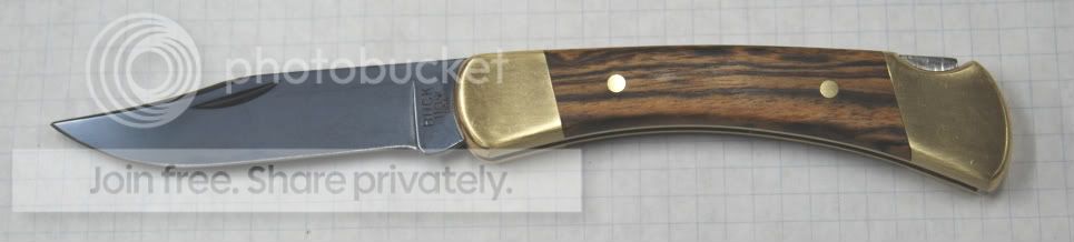

Here is my BP110...put a little Bocote on it.
Goose that is a nice, nice scale job. Red ad Black just goes together.
Goose I like the looks of your BP110. When I heard that they where going to go up in price I felt that I had to order two of them, with the Rose wood liners. That was two years ago. HL
