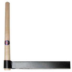

There is such a tool. It's called a froe. Used for splitting shakes.
Yep.
OP had a Good idea - so good, in fact, that it already caught on hundreds of years ago. :thumbup:
The froe was used for more than splitting shakes.
They used to build a framework called a riving break. It held sticks horizontally to split with the froe. (Also known as a riving knife.)
Willow branches could be split into withys.
Logs could be split into pie-slice-shaped planks.
Planks could be rough shaped for barrel or bucket staves, or cartwheel spokes, or furniture.
The froe is one of those basic "Your imagination is the limit" tools.
