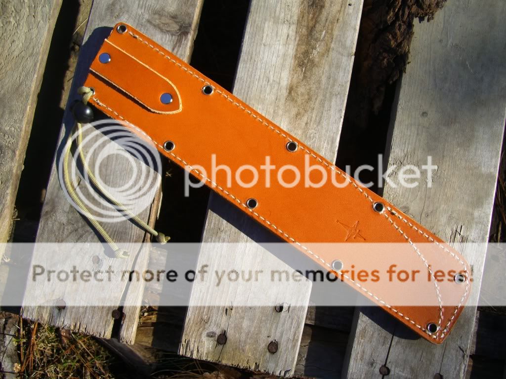

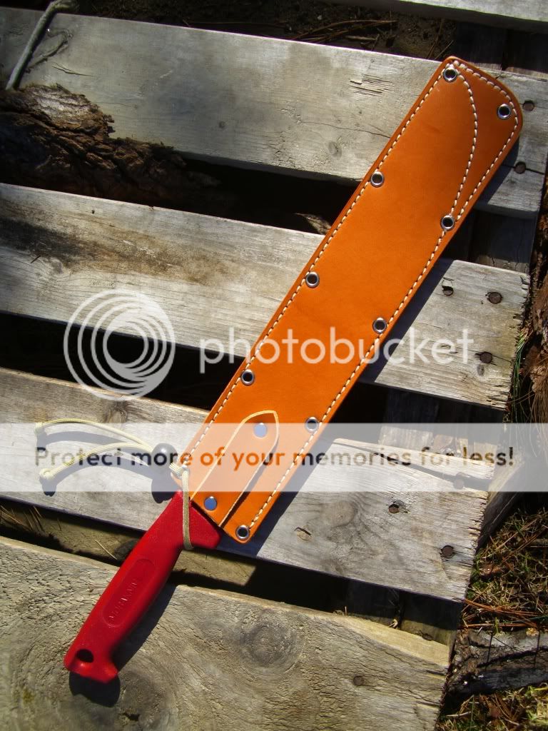

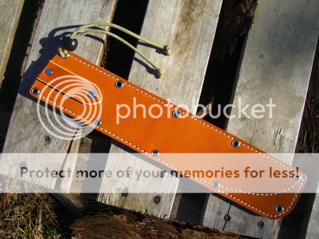

But first, some photos of the new JRE sheath I had done for it. I'll be getting some in to sell shortly, but this one was the sample and I quickly decided I was keeping it for myself. :D Rather than using the belt loop (which works just dandy) I opted for a 2-point suspension similar to that used on swords.

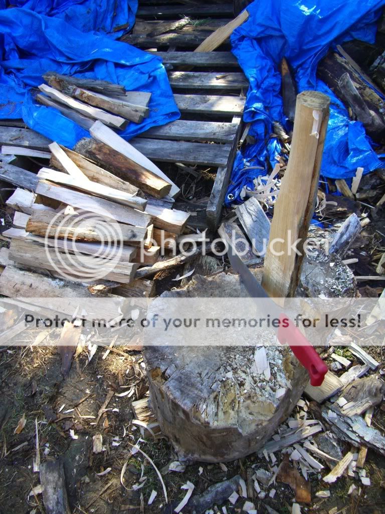

Batoning:
I used the #333 as a push knife to shape a piece of wood into a baton. The wood in the background of this pic is what I started with--all wrist- to forearm-sized maple and oak.

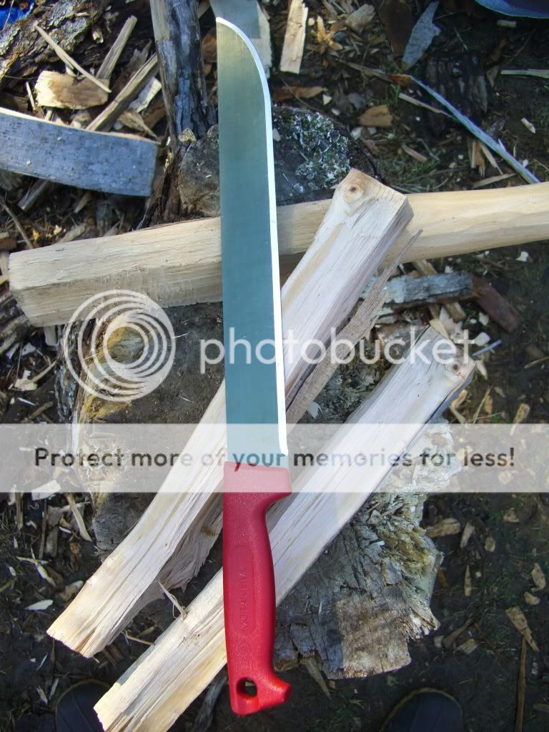

Knocked right through knots like they weren't even there.
Victorious!

The factory edge is around 10 degrees inclusive, which deforms when chopping woody stemmed plants. I thicken them to 30 degrees inclusive. And yes, they were originally intended as insulation knives. :)

Just over 2/3 length. It comes down to just past the "A" in "MORAKNIV" on the handle. :)

Great sheath & better job on the edge regrind.
Thanks! The sheath is even more versatile than I had hoped it would be. Thanks to the lashing holes there are tons of different comfortable ways to carry it. If using cord for a suspension like I did, I recommend using cow hitches as they're easy to tie quickly and they hold their position well on the belt. :)
The edge configuration on the #333 from the factory is pretty much unusable for anything other than its original intended purposes. They even leave an aggressive floppy curled burr on it. After putting a 30 degree inclusive convex edge on it with a 40 micron belt it's a dream to use. Still cuts wood like a Mora should! (Hey--that rhymes!:p)

I think it's too light to really do "heavy" chopping as you simply won't be able to impart that kind of force to such a light blade with your arm. The batoning I did put more strain on the blade than any heavy chopping would, though, and it held up fine. I deliberately did the test to confirm to myself that it would hold up under very rough use, and even when it went through gnarly twisted piece and the blade bent not just side to side but actually twisted through some of it, it came out straight as an arrow! Color me impressed. :cool:
