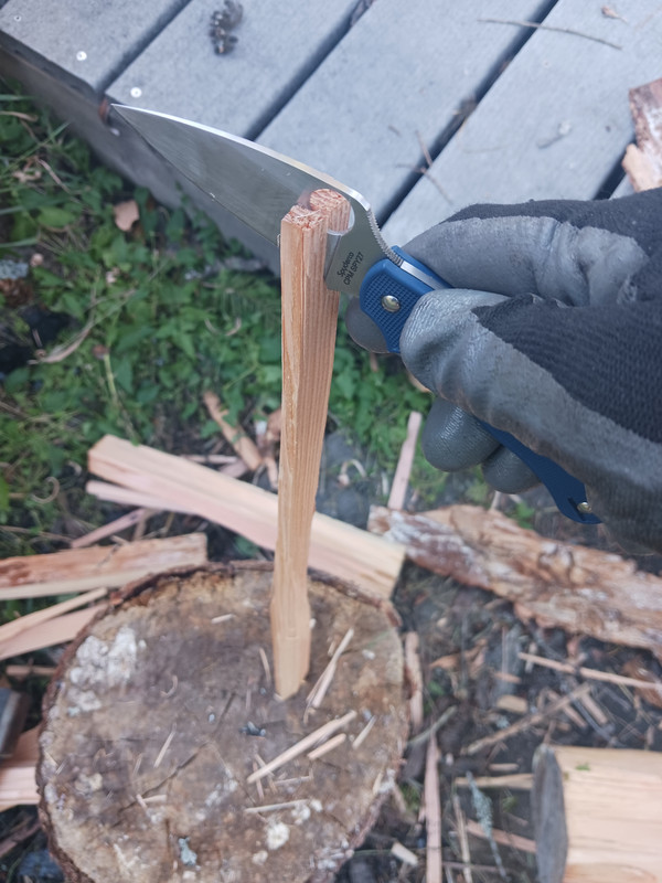

I do some what regularly baton but it is more as I kneel in front of a fire prep spot and need smaller wood or dry wood to get the fire going. I am not going to carry an axe with me when I go deep into the Montana mountains during a winter outing but I do carry a small folding saw and 4 inch bladed belt knife in the pack.
Just now I needed some fine kindling to get the wood fired hot tub going and so I batoned some wood.
