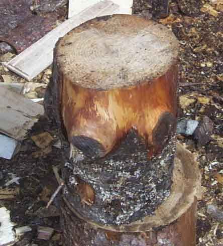

http://i7.photobucket.com/albums/y269/CliffStamp/bruks/maul/crossknot_rounds.jpg
http://i7.photobucket.com/albums/y269/CliffStamp/bruks/maul/thick_knots.jpg
This is even worse, as it is smaller so it almost all knot, and the edges are not sawed, it is just a cut stick :
http://i7.photobucket.com/albums/y269/CliffStamp/swamp rat/ratweiler/ratweiler_knotty.jpg
and this isn't even close to really difficult wood yet. None would actually take more than one metal wedge, and I have seen wood take three and not split.
Wooden wedges get broken when the grain twists and this puts pressure across the leading edge, as long as the wood is opening up they just get direct compresson on the poll and that won't even break pine wedges.

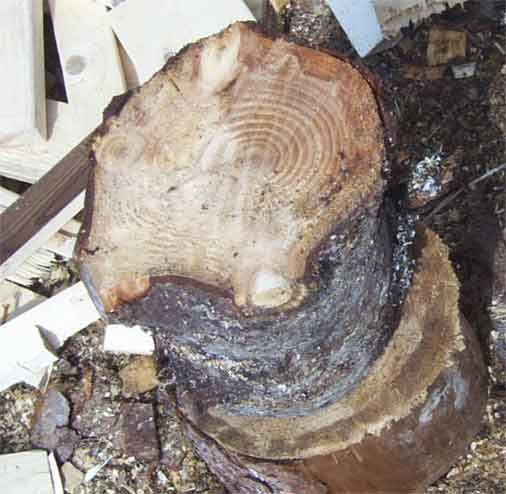

Knots are also a real problem because wood wedges can not cut through them and this is necessary to split certain knot patterns such as :
http://i7.photobucket.com/albums/y269/CliffStamp/bruks/maul/knot_split.jpg
It was either chop through that knot directly, or try to chisel cut through other ones. In regards to time, I don't think I could actually split the side off the round in four seconds on average, that fast let alone shape the taper. Generally it takes me a few minutes to make a set of wedges, but I am generally not racing against a clock when doing any knife work, it is just way too dangerous, you also have to check the wood, grain, knots, etc., you don't want a wedge with a bunch of knots at the point, etc. .

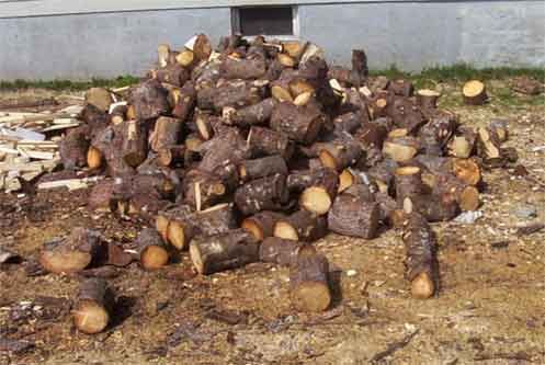

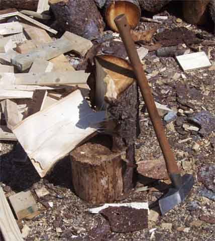

The above rounds by the way were not actually hand as the worse, I split about 250 yesterday, fully half of them where like that, only about 10-20% were actually readily chop split with the GB maul :
http://i7.photobucket.com/albums/y269/CliffStamp/bruks/maul/rounds.jpg
None of it was overly large, 6-12", most was about 8", it is too heavy to carry above that, plus there isn't much of it anyway as it is usually cut for sticks for lumber, not burning.
