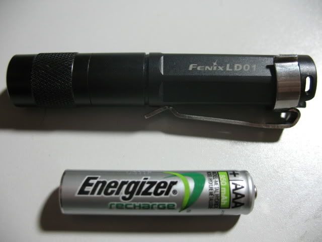

Hmm. I bought 14 bucks worth of 4 aaa 2011 energizer NiMH 850 mah rechargables, charged them completly, and poped the 1.2 volt energy canister in the the flashlight and i swear its visibly brighter.
The NiMH might be only 1.2V to alkaline's 1.5V (charged/fresh), but in a light like your Fenix, which has circuitry that regulates the output, the initial voltage really doesn't matter. What matters is the amount of current (amps) that it can pump out continuously and consistently, and alkalines are horrible in high-drain devices like your flashlight. If you've ever used a regular old Maglite, you'll know what I'm talking about. Bright as hell at first, but dims quickly. Even in an unregulated device, NiMHs will operate at its optimum or close-to-it voltage for longer before "dumping", while an alkaline will be a constant decline.
Alkalines still have their place (TV remotes, fire detectors), but for anything high-drain (or even moderate drain) that gets regular use, there's no reason to mess around with alkalines.
