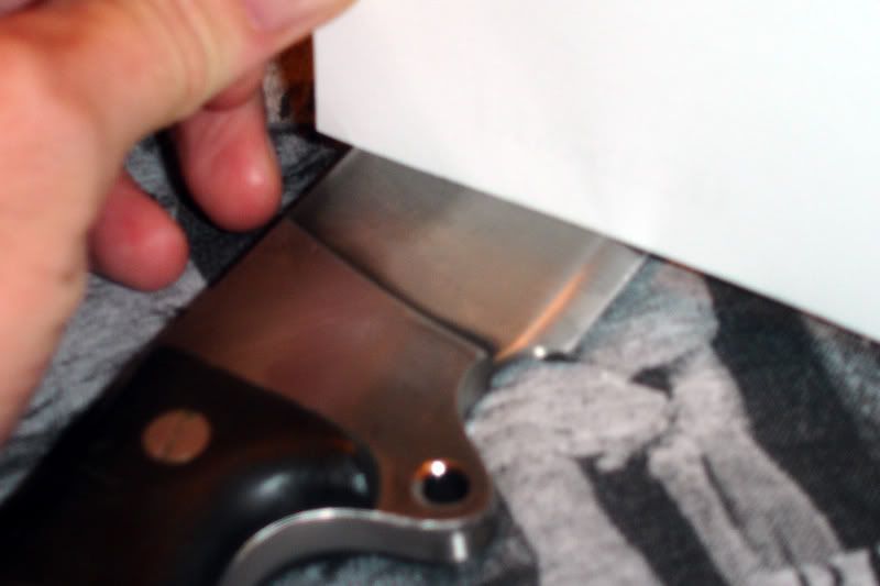

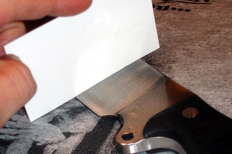

foo that one looks convexed on both sides.
The assymetrical edge is extremely sharp inspite of it being ugly. It is akin to making a chisel blade where one side is flat and the other is either v-ground or convexed except that in this case it is just the edge that is sort of chisel ground.. The advantage is that it is strong and sharp all at once. A chisel grind is half the angle of a regular grind.
