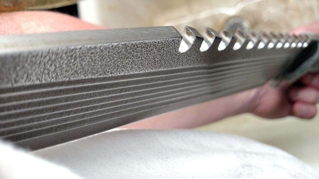

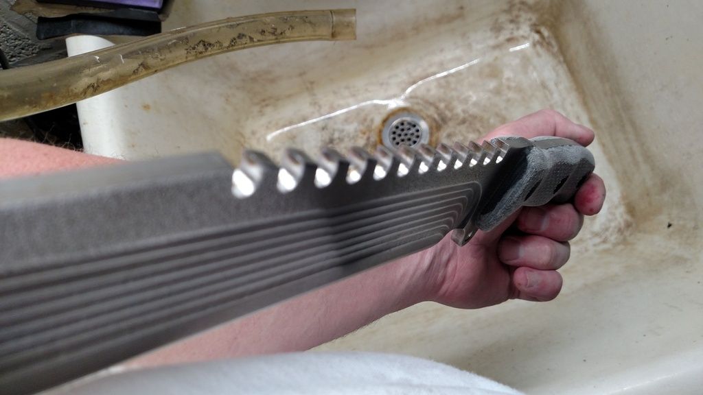

So... I started stripping my Battle Saw last night. Tanker Grey is TOUGH! MANY coats of stripper and much sanding. I have stripped several Busse's in the recent past and this finish is the beast! I thought my B5 was bad, but... WOW
I found 80 grit wet dry paper used wet with a flexible sanding block worked really well (I got a jumbo school eraser at the dollar store). The Infi dimples are amazing on Battle Saws!
I went to the hardware store to get dremel stuff and found long skinny stones intended for chainsaw sharpening. I thought they might work well for cleaning talon holes and rough marks around the choil and pommel. Well... it also works well to clean inside the saw teeth! and..... as a result of this fine stone in the tooth slot, the teeth became sharper and sharper! WOW! Unintentionally, my Battle Saw is now so sharp, you could cut yourself on the saw teeth!
I just thought I'd share my discovery.
Enjoy! Let's Drink (but not when sharpening)!
-Will
These pics are mid process, but you can get the idea...
