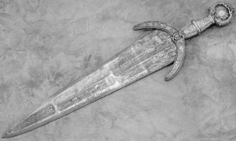

Intended purpose, length, weight, COG, vibrational characteristics and aesthetics all play an important roll in the swords design. In addition to reducing weight the fuller aids in dampening low frequency vibrations in the blade. With out the fuller stiffing the blade to reduce the vibrations would require it to be drawn much harder making it less flexible but making it more brittle. The fuller allows the steel to be drawn softer increasing flexibility while still retaining the desired amount of stiffness.
The above sword is a bit of a show piece and as such the fullers are no doubt arranged to be functional while being aesthetically pleasing.

Cinquedeas have the tendency to be elaborately decorated, but their typical multiple fullers made a good example. I know that in the JSA (Japanese Sword Arts) community that katana with bo-hi (a fuller located close to the spine) are often criticized for being more prone towards taking a set or otherwise being damaged much more frequently than those without bo-hi. Thoughts?
