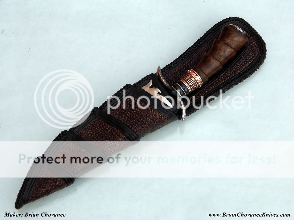

Hi good people,
My latest, futuristic/fantasy fighter," PREDATOR"
Overall length 325mm(13"),blade length 195mm(7 3/4 "), Damascus steel(W2 &L6 ,stock Milan Mozolic ), fully heat treated to around 60HRC ,it has slightly convex grind with no secondary bevel, it's pretty sharp and pointy,24ct gold inlay makers mark
The guard (as well as the butt cap)is hand carved from ONE piece of W2 high carbon steel, the collar is W2 alternating with sterling silver,then copper...the wood is Turkish walnut root burl.. tang-through construction with a tang nut and butt cap over it..also, inside the handle there is lead counter weight to offset the big blade, so now it balances beautifully, right at the guard.The composite sheath is handcarved ,handlaced leather with sterling silver inlay...will come with a wooden,shape moulded and felt lined case (with a special secret surprise) as well as COA ,of course ....as usual,it's 100% handmade,original one of a kind,sole author yours truly ..hope you'll like,any questions ,bccustomknives@hotmail.com ,SOLD
Cheers
Brian
