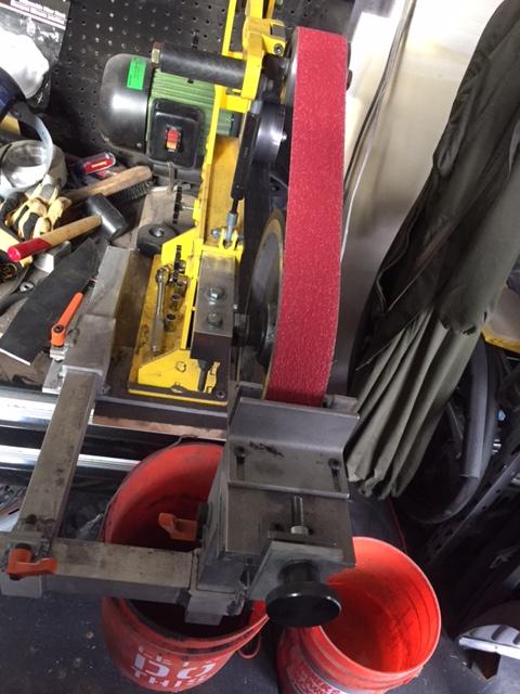

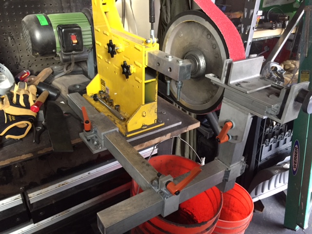

This is one of the bevel guides and mounts that I make shown mounted on an Oregon Blade Maker machine.
The machine is sitting on a custom made plate with the slide mounts base clamp attached to it. Once this is set up it is very quick to use.

I can not answer in detail about the grinder. I made the Multi Guide Pro and the slide mount and sold it to this guy. He mounted it on his OBM machine and sent the pictures back to me. For me personally it is not a machine I would buy. But neither is any other machine so that is why I build my own sanders. It does seem to be a reasonable value though. I have bought other OBM products such as wheels and have been pleased with the quality and price. My personal machines are very fast and high horsepower. My methods of grinding are not the same as most people you see.
This is a video of grinding on a heat treated blank using my prototype guide. Belt is a 36 grit 3M cubitron II running at 7200 surface feet per minute. I have ground more than 50 blanks using this same exact belt edge down and it is still going. Grinding edge up the best I ever got was 19 blanks before the grit was all stripped off.
The actual grind on this video took around 20 minutes. I was going slow because the blank was heat treated and I did not want to burn the edge. When I grind bevel pre-heat treat I go faster and the metal really flies off and a blank like this would take 5-7 minutes to grind.
