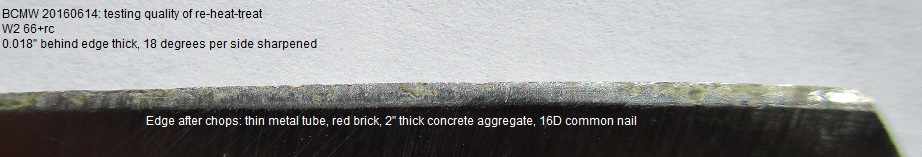

Instead of throw an old experimental W2 blade away. I decided to test my re-ht procedure. After hardened and few light chops into dried olive wood - it gifted me a big chip. Got to find out whether that was a precondition or my re-ht procedure has problem. Grinded & put on new edge - might as well documenting my abusive tests.
W2 1/8" thick with hardness
Prior: 63rc
New: 66+rc, 0.018" behind edge thick, 18 degrees per side
Abusive chop tests: thin metal tube, red brick, 2" thick aggregate concrete, 16d nail.
Edge after tests
Thanks for watching(9m:20s video) & comments.
[video]https://youtu.be/HJpd64itaj4[/video]
After re-watched the video and re-examined the edge -> saw edge damages from chopping concrete with aggregates, which slightly more than chopped 16d nail.
Thanks, Chris!
Part of the edge is 30*inclusive but widest bevel is around 35-36*inclusive. Overall - as seen in video - I was surprised how well this thin edge performed/survived these harsh tests. Which mean, re-ht old blade is an option but pre-existing cracks/damages will carry forward.
