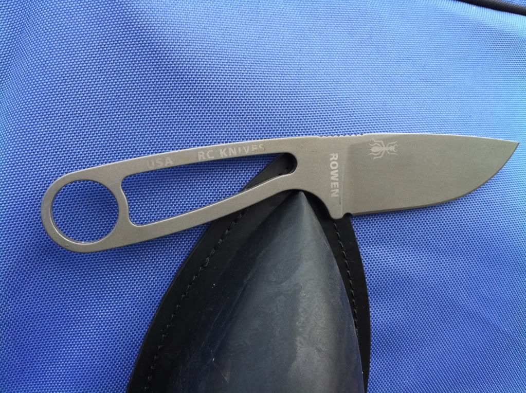

i started to sandblast my izula and the coating was bullet proof!!! it would have take me way too long so i need to chemically strip it first then i will blast it!! in fact ill do it right now and post pics when its done!!! :D

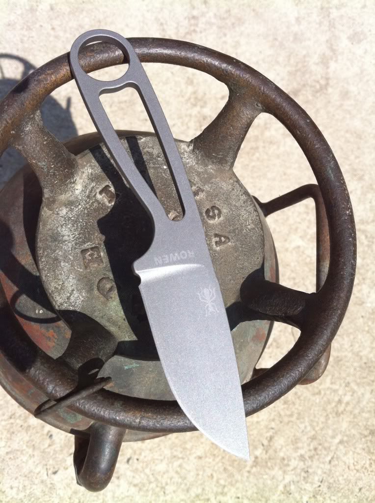

Well this is what it looks like after chemically stripping the coating! I think it looks cool like this as the logo is blasted from last time I tried
Is that Sand blasted or bead blasted? What did the the process do to the edge? Did you do something to protect it?
Looks really good BTW. What did you use the strip the coating off?
Sand blasted ! I did nothing to protect the edge and the damage is no more than a few strokes on the sharpmaker won't fix !! Thanks !!
Man, that bead blast looks sweet. I guess the nice thing is if it starts to rust up you can go blast it again. :D
