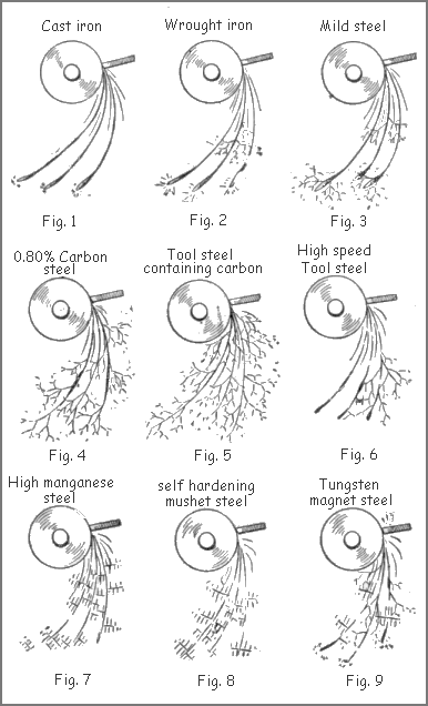

This is really a fairly easy question to come to a 'close' answer for.
If you have a wheel grinder, a chunk of 1095 , an el-cheepo wrench, big old band saw blade, circle saw blade a sample of 5160, L-6 and another of 52100 and what ever else is under the bench or around the shop, run a grind/spark test. The sparks will give you a fair value.
By matching the sparks to about everything you can think of, you will get a fair idea of what you have.
Some saw blades and tools say right on them what there made of, there are more variables then answers watching sparks sometimes,,,,, but it will at least tell you if you should invest the time making a blade out of it. I would hope for a very short trail of very fine sparks,,,,,,, then make a blade , quench at critical, temper for a say, say 385? , and see how it cuts!
Experimenting is part of the fun!
Its ball don't lie. Sparks can give you a little help but a long ways from being fool proof. Right now I've got at least 4 different types of 52100 and each has a different spark.
