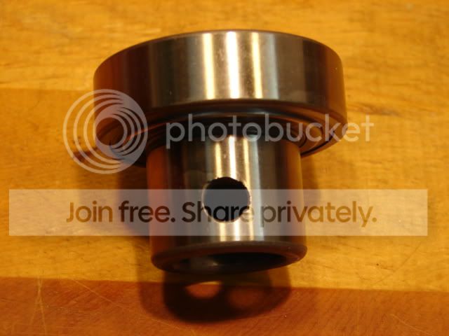

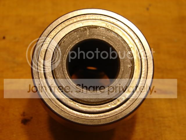

I looked at it and it doesn't look like I can get the shields off of the sides of the bearings to pack it with grease. I'll dig out my camera and post a couple of pics.

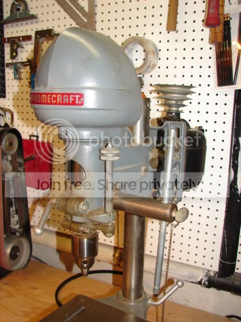

Here is the drill press I'm working on.
Here is an end view of the bearing.

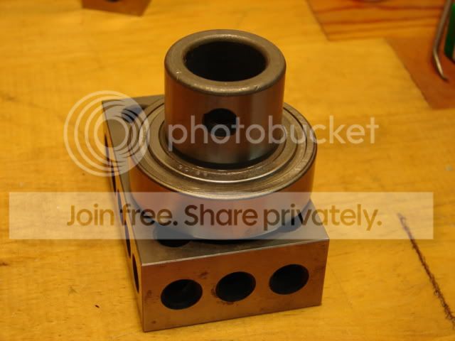

The bearing sitting on a 1-2-3 block for some scale.
The inner sleve with the tapped hole is part of the bearing. I don't thing it's going to be easy to find a replacement for this at all.

Are you sure the inner sleeve is not just pressed into the bearing? :confused: Looking at the pic it looks like it could be a pressed fit into the bearing itself!
This press looks like a Walker Turner to me. They used to make the pre-Craftsman machine tools for Sears & Roebucks and I believe (although not 100% certain) that they also made machines under other names too.
The parts breakdown I have shows it as a one piece bearing. I am certain that it is not pressed in.

It is a Delta homecrafter, I should have taken a pic of the name plate. I looked at that site along with several others. I have found placed that used to have the bearing but it is now discontinued.
If I can't get this bearing to work, I'm going to get a plain bearing and machine a sleve to press into it. This bearing gets assembled into the upper pully, the tapped hole is what holds the assembly into the casting.
