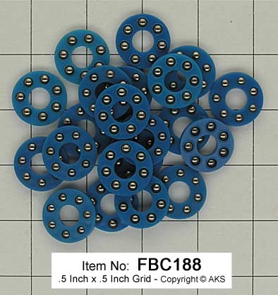

Hey guys,
One of my next projects is going to be my first attempt at a frame-lock folder. I decided to go with these bearings from Chuck at Alpha Knife Supply.
(Photo from AlphaKnifeSupply.com)
If i mill my raceways into the 6al-4v frames, how much wear-in can I expect as the bearings "break-in" and develop a groove in the Ti? I'm wondering if I should counterbore my 1/2" raceways ~0.01" short of my calculated depth to accommodate settling of the bearings and tightening of the 3/16" pivot. Any thoughts?

I think you're only talking about a .001" difference per side after the bearings form a slight track within the races.

That is what it says on the IKBS site, but I THINK they are a a few though off. I emailed them asking to clarify, and never got a response.
I base that off of this picture.
The difference I experience is more in line with .0015 - .0025 per side.
But, I only measure with gauge pins and such, not precision calipers!

I'm with Brian, Got about 75 folders out right now with the bearings they settle about .002-.003. I usually open the blade about half way, remove the back spacer, then slowly close they blade while tightening the pivot hard, then put some rubbing compound int there and start opening and closing a bunch, then loosen the pivot and... Butter:)
