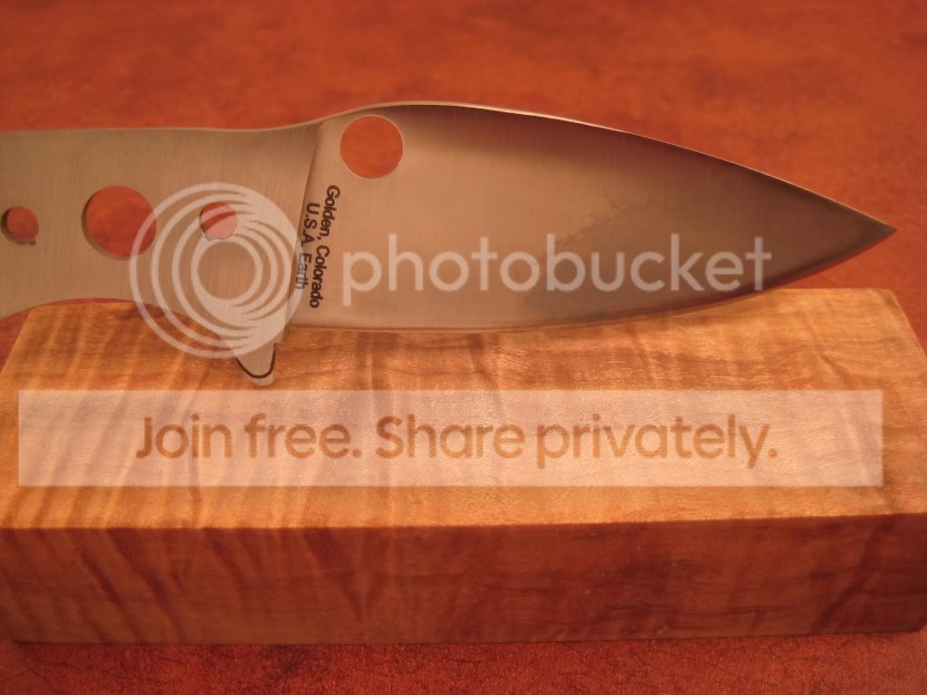

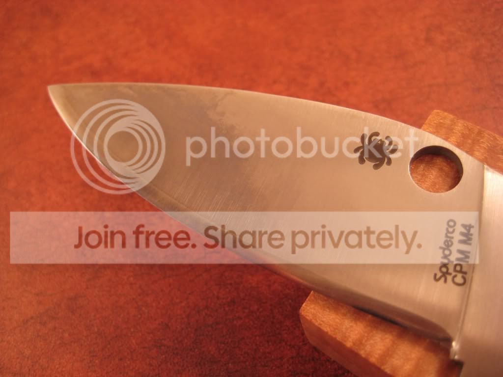

After having used this M4 in the kitchen a little, I noticed it seems to patina very similar to A2. I cut up some chicken tenders, cucumbers, tomatoes and peeled and sliced some grape skins to test sharpness.... yeah... it's sharp. :D
I personally don't really have any issue with a colored patina like A2. I much prefer a blueish gray patina over rust. From my experience with 52100, 52100 "readily" and quickly turns orange, brown and black (rust in my book).
A2 and this M4's patina are more of a color "shading" without pits and/or rust "growth". :barf:
A2 is a very good knife steel in my book. I am under the impression that M4 has better edge retention (?????).... (seems a little better so far ????) ... and reasonable toughness at almost as tough as A2.
So, far, M4 appears to have "GREAT" blade qualities in my book for a Mule sized knife. :thumbup:
I originally ordered one. But, I have been so impressed with the steel and design so far, I ordered another last week. Should be here today or tomorrow.
Here are some pics showing the patina and my "Hump"/ramp mod:
... notice the "waiting" stabilized block of wood. ;) ..... I need to find a band-saw to borrow (?????) and order some pins.
