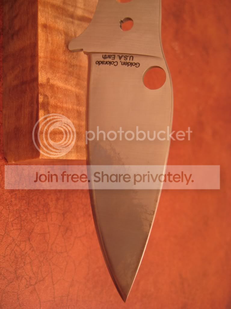

Beat the crap out of my Mule2

I really love my CPM M4 Mule. It came at tree-top trimming sharpness, and after over 20 ft. of heavy cardboard cutting, it still shaved arm hair with no pressure, and a couple of strokes on a ceramic stone, back to tree-top. Did I mention how impressed I am with this steel? :D

My M4 Mule also arrived less sharp than my other Spyderco's. But the new diamond Spyderco stiks got it to 'Scary Sharp' now.

I'd like to see that CPM M4 baton through that block of wood.
