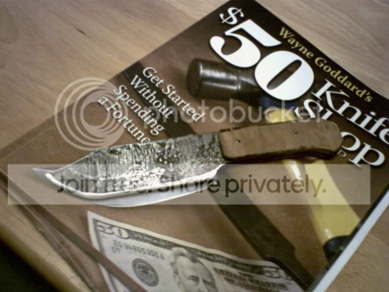

Hey all, I spent about 12 hours in the garage this weekend, and I successfully made my first knife.
Here are the specs:
I started with a 3/16"X2"x9" bar of 1095 purchased off ebay. I sketched out a blade pattern with a sharpie and cut it out using a bench grinder, angle grinder with cutoff wheel, and rotary tool. Once I roughed it out, I put 10 degree primary bevels on the bottom half of the blade using a home-built disc sander. I then drilled my two 3/32" holes for my scale pins (coat hanger, anyone?).
Once I had the pin holes drilled I normalized the blade (I think that's the right term) by bringing it up just past non-magnetic and letting it cool to room temperature in still air. I did this using a Mapp gas/oxygen torch.

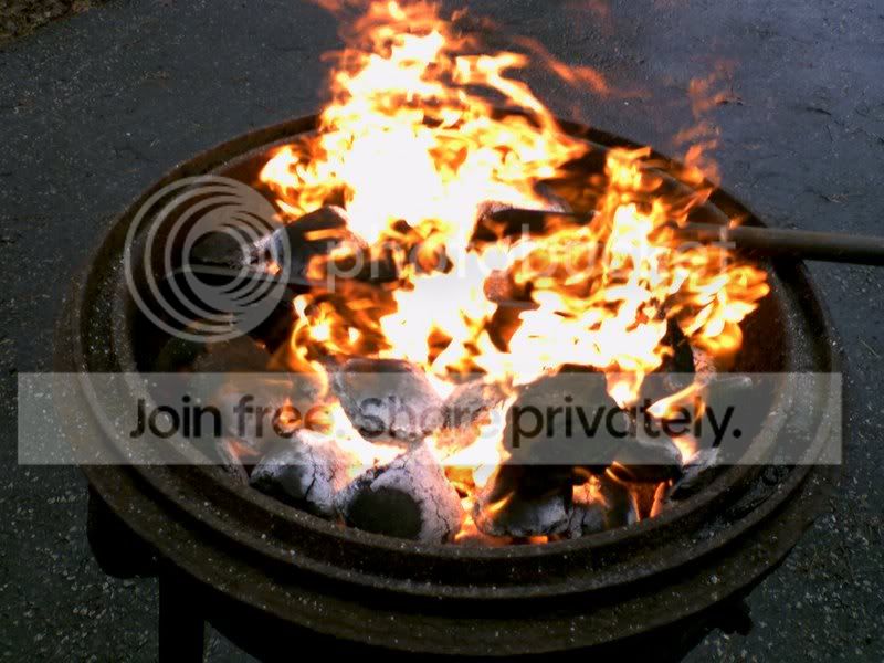

After cooling I scrubbed off the blade and it was time for the HT. I heated up the blade in my home-built coal forge (thanks for the blower, PimpinSquee).
I preheated my quenchant (old ATF) by heating up an old hunk of rebar to a dull red and dropping her in. Once the blade was a nice cherry red and thoroughly non-magnetic, I edge-quenched it in the ATF, with only one small little flame. The blade was out of the heat and into the oil in less than one second.
I checked the hardness with a file, and she skated right off! HOLY CRAP! I DID IT! I then tempered the blade for three one-hour periods at 425 degrees in my oven. It's a good thing I'm not getting married for a few months yet...
I was going to polish the blade, but I really really like how it looked after the tempering, so I just left it alone. I ground the final bevels at 20 degrees, sharpened it on my sharpmaker, and I can pop hairs off my forearm.
For the scales, which I know kind of look crappy, I used a hunk of Walnut that came from my grandpa's workshop right before he died. I just roughed out the shape, epoxied and pinned them on. I left the wood exactly as I found it on the grip surfaces. That's how I wanted it, and it reminds me of him.
Well, here she is:
I still have to finish grinding down the ends of the pins, you can see shadows next to them in the picture. She might look like junk to some of you, but I think I'm in love...
Thanks to everyone here for all your advice and help. I don't post all that much, but I read just about every word each of you says. I couldn't have done it without you.
Now, whaddya think?

great job man. im glad to finally see the pics of your forge. my old blower looks so sexy on there. you did a fantastic job on it. did you add a switch to it? cant wait to see what other knives you pull out of that forge. some advice that was given to me was take that knife and lock it up in a drawer to be viewed at a later date to compare it to the knives your making then. congrats on your first knife. keep it up. has the bug bitten you and not let go yet? HEHEHEHE!!!!!

Like everyone else, I think you've got a damn fine knife for yourself, for many reasons. I also think you should keep making more, because it looks to me like you understand what you're doing. Not just how you built it, but why.
Good job.
In the future, make your tang holes about 1.5 times the size of the pins ( you want some wiggle room), and use larger pins,too. 1/8" minimum, 3/16" is better. A brass or steel bolt will do fine as a cheap pin. The threads make it hold real tight to the epoxy.
The rough texture is called "Brute De Forge" , which is french for, "I left it beat up 'cuse it looked cool." I like it on beaters and camp knives. It will look a little better if you carry the clean up grind up the primary bevel (about one third to half way up the blade). That really shows the contrast of the rough texture to the ground steel.
Stacy

I think that first photo of your forge is something they should post here so that new guys can see what it all should look like when they make their own!
It's a simple design that works like a charm...all a guy would ever need to make a knife on....
The design is not heavy to lift, does not take up much space..is the correct hight off the ground, and is more than strong enough to handle the heat of the fire...

Yeah, I definitely plan on using larger diameter pins next time. I would have on this one, but I didn't have anything on hand, and money is pretty tight these days as I save money for my upcoming wedding. July 7th is coming up pretty fast, though, and money will be more plentiful after that.
I still may polish the primary bevels on this piece. I'm not real sure yet, but we shall see.

I love it when a forged knife embraces the marks, imperfections, and uniqueness that is part of forging. Looks like a great knife, wonderful tribute, and a good user.

I'm hoping to find a few select steel rods in my stash that I can use to make a pair of tongs soon. I've been using long needle nose pliers (about 18" long) to hold the steel in the forge, but they don't really seem to be cutting it. I need something with a little longer reach, and a touch more solid grab to them.
Stacy
I like 3/2" pins for looks, but if it makes that much of a difference in strength I'll step up to 3/16".
