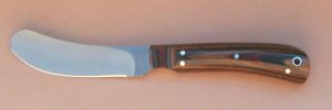

I was aksed to make a "Beaver knife" at a banquet last night. I have never seen a beaver knife though. The customer gave me a description and it sounds like a fun project. Anyone have any pictures they could post of a beaver knife?

I've never heard of a beaver knife, maybe you could share the description your customer gave... might yield some better answers from those "in the know"

The picture is of a "Beaver Knife-Full Skinner" made and sold by DUNN KNIVES. Many trappers swear by his knife.

Ive trapped a lot of beaver myself..A good beaver knife needs to be fairly thin and have that round nose sharpened all the way around to the top..Beaver are one of the hardest animals you'll ever skin and worse to flesh. Skinning around the head will dull a knife fast.
The reason a beaver knife is round is because beaver have to skinned in the "round" vs "cased" for most furbearers..You have to be able to push the knife under the skin between the folds. A pointed knife pokes holes in the hide to easy..

I also suggest a very grippy handle. Beavers are very fat and oily. Everything gets hard to hang onto.

A skinning knife is what he is after.
I agree everyone that a handle with some grip is necessary. Any suggestions on wood type. My original thought was to use a micarta and texture it, but I would like to stick with a natural product for the scales.

If he is going to be skinning beaver in the field he will need a knife with lots of curve in the blade and a sharp point to get him into his work.
The last beaver skinning knife I made had a 3" blade and 3" handle. The handle was over size and oval so that it would fit into the palm of his hand. At last report he had skinned over 500 beaver with it. When trapping it is the only knife he carries except for his pocket knife. He has worn out more pocket knives in his 70 years of trapping than most of us own.
I'll bet this one would come pretty close. The knife is 8 1/2" OAL.
The blade is 3 1/2", and sharp most of the way around the curve.
