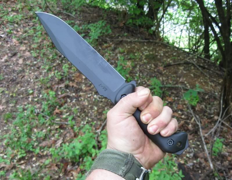

I just got another knife a couple of days ago. Mother Nature is not exactly cooperative today hasn't been for days now. This one is the Becker BK-7 made by Ka-Bar. Though I am sure most here are familiar with it. It has an over-all length of 12.5 inches or 31.75 cm, a blade length of just over 7 inches or roughly 18 cm tip to handle, and it is 1.62 inches or just over 4 cm at the spine area between the thumb ramp and the swedge. It is made of 1095 CroVan steel
This is how it comes…
and even though I have long accepted globalization (didn't it actually start even before Marco Polo), it is nice to see this label does still exist in the world of production knives. However...neither the little utility knife nor the sheathe are U.S. made, but at least this partial globalization does still support American jobs and the key element of the set is domestically made.
It is a full tang design with the Grivory (not sure what that is yet) handle scales held on by three 5mm socket head bolts. It has a protruding tang that looks to be great for tasks such as breaking glass or plexi-glass, cracking skulls, or even batoning into ice to make a hole or gather ice to melt for water. The handle fits my hand near perfectly. I get a great grip in the conventional grip, the reverse grip, and in a rearward hold.

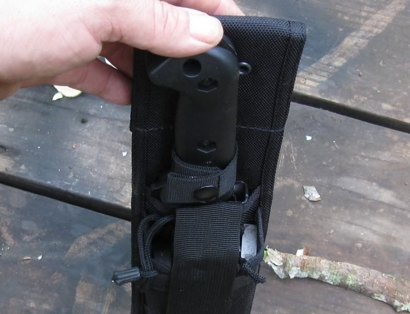

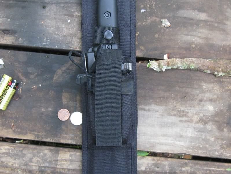

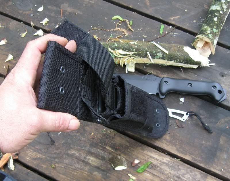

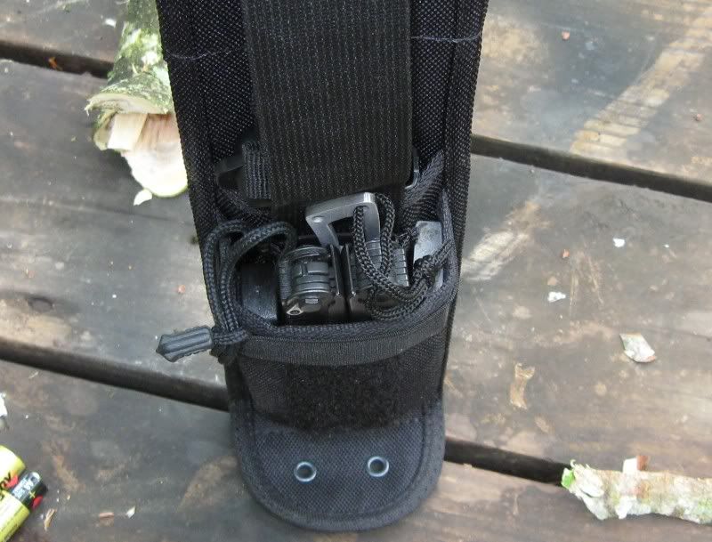

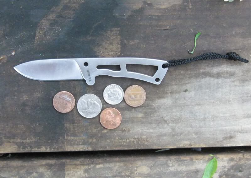

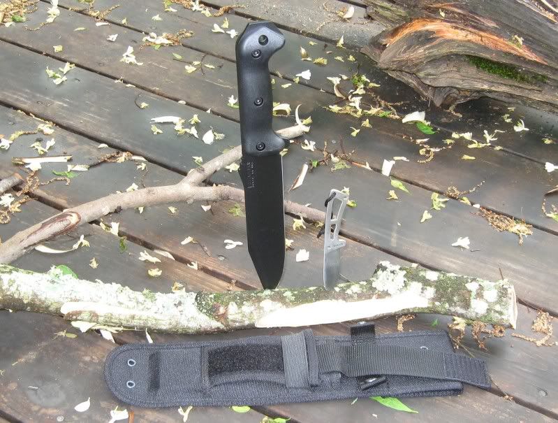

The sheath is made of Cordura and has multiple attachment points for carry options. It comes with a small utility blade included, and it also has a great cargo pocket that is a lot larger than most. The retention strap securely holds the knife in place and allows very little movement.
The cargo pouch is large enough that besides the utility tool, which has it’s own sheath inside the pouch, it will also hold a multi-tool, a magnesium firestarter, and an Army model Swedish fire steel. I could haven gotten a few thinner things into it such as sticks of fatwood if I’d thought about it. It has an elastic webbing band around the opening to allow the pocket to expand and contract as need which also serves as a good place to tie off the firesteel and firestarter to secure them in place.

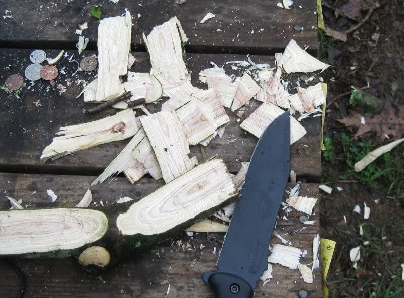

and had no trouble whittling thin shavings.
It made very quick work of chopping through a 1 1/2 inch Hickory limb

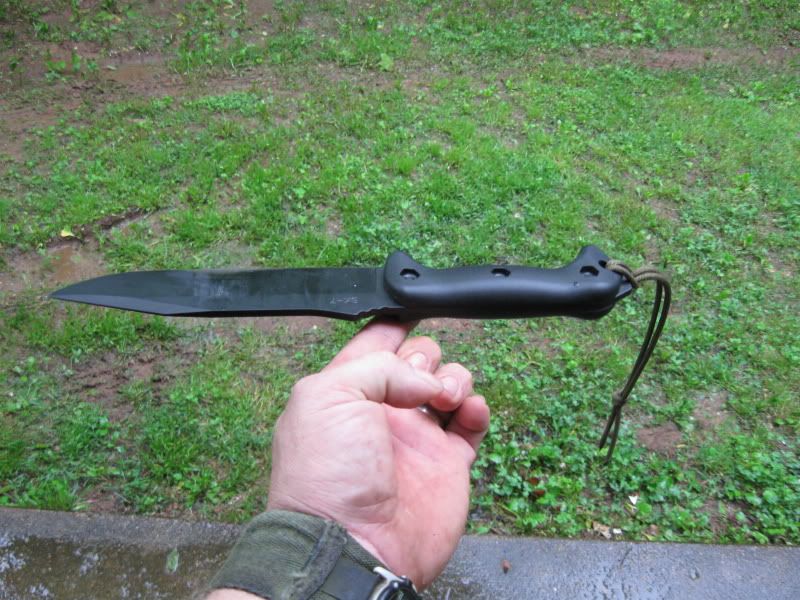

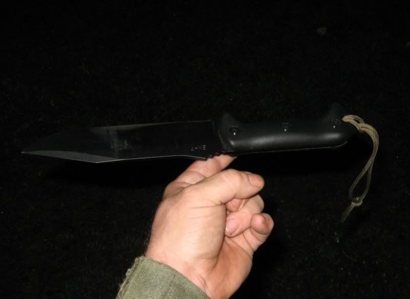

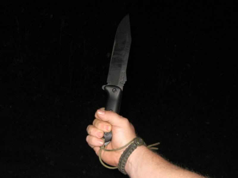

and this is the best shot of the balance I have been able get so far. I'll try to get another shot tomorrow. This thing has nearly perfect balance but just barely blade heay, and the rounded shape of the handguard makes it near impossible to balance it...or there was some major problems with gravity today ...one or the other because I couldn't get it to be still.

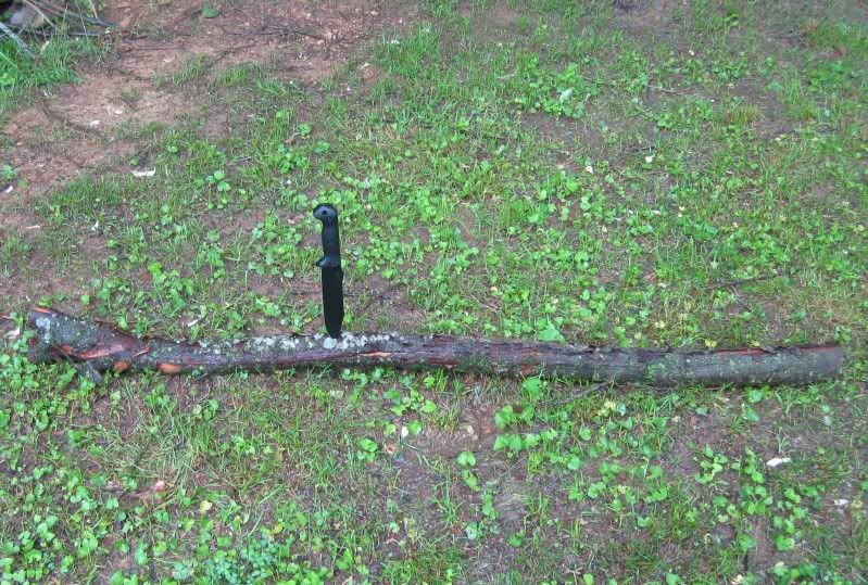

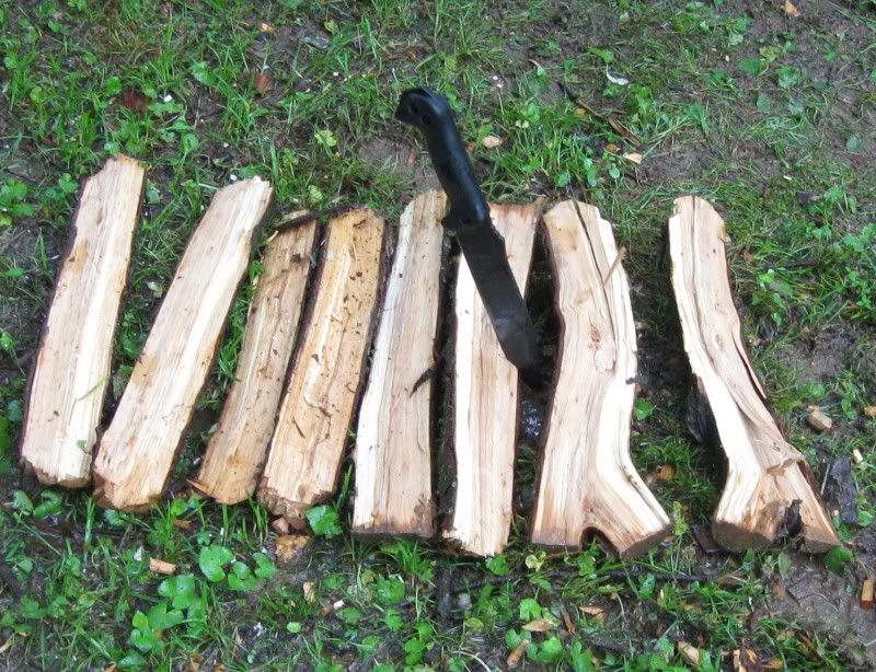

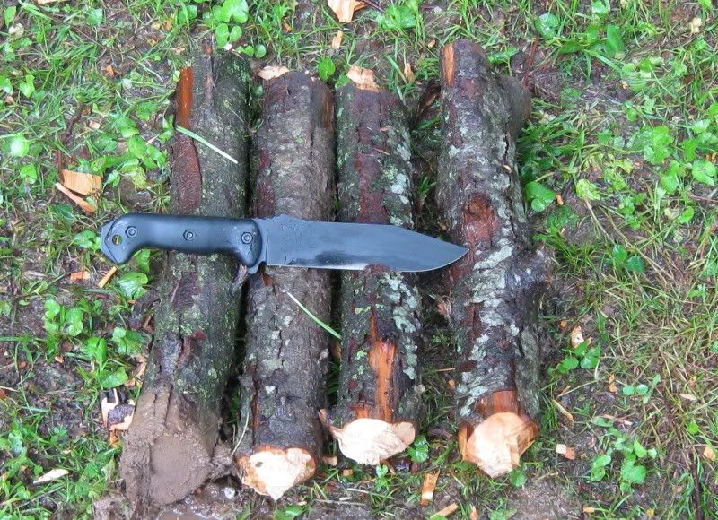

I found a nice seasoned Apple limb about five feet long and roughly three inches in diameter.
and proceeded to chop it into four pieces. It handled that very well and took about eight or ten minutes, I was just too glad to be outside to time myself. I am not sure how familiar any of you may be with Apple wood but while it isn’t the hardest wood in the world it sure isn’t the softest either once it has seasoned some.

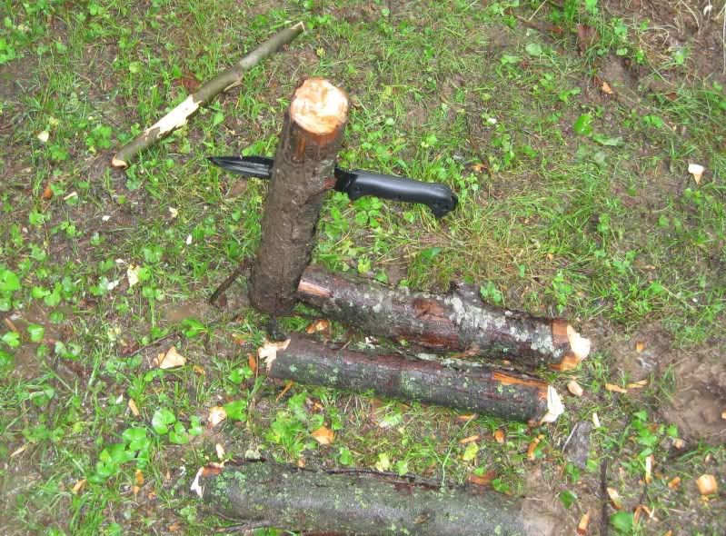

Then it was time to see how it handled batoning. It took about six or seven licks to get through each piece, and the swedge did eventually do in the little mimosa baton I was using and for the last piece I had to use one of the pieces I had already split for a baton.

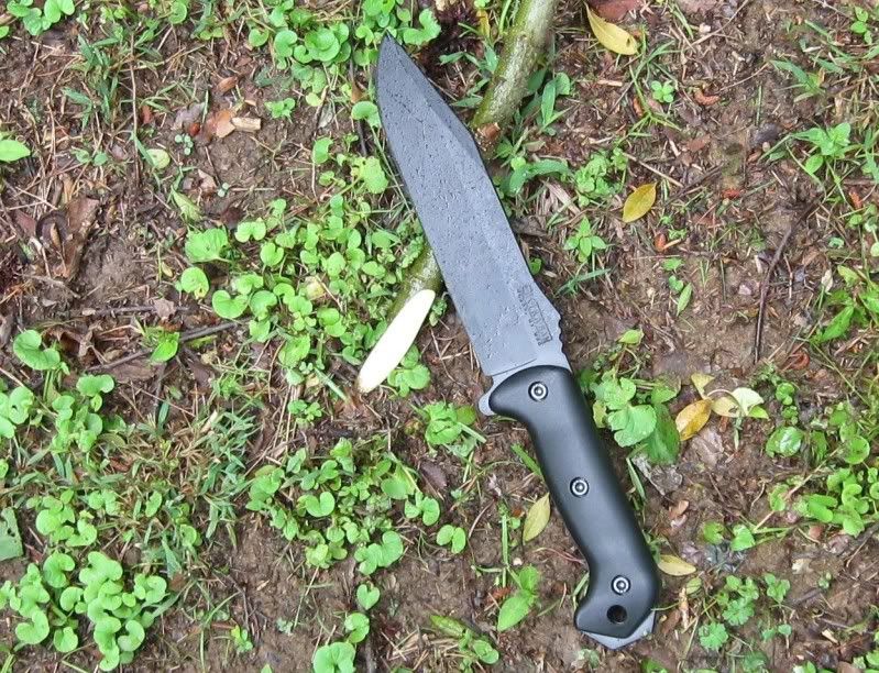

The blade handled all the chopping and splitting just fine, though there was some wear in the coating. The bolts did loosen a bit during the course of this and each one had to be tightened a turn and a quarter to a turn and a half, but in all honesty I forgot to check them for tightness out of the box. I have had to tighten the bolts on other manufacturers knives out of the box before and this is one reason I do not like ”hidden” bolts…I tend to be rough on my knives and like being able to tighten them back up.
There was no blade distortion at all afterwards
And…even after that…the knife still shaves.

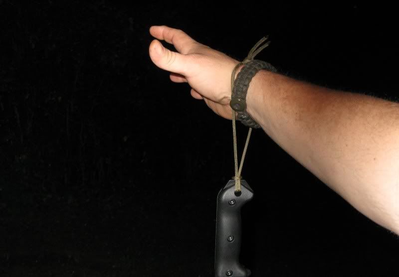

Also I got a better balance picture, maybe I should have put the thong on it before…lol, made it much easier to balance it.

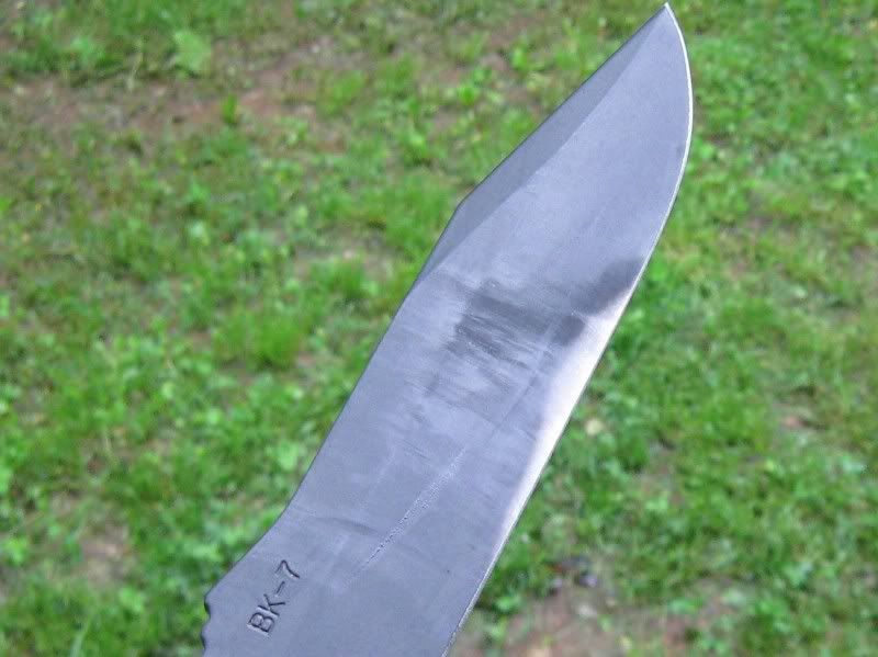

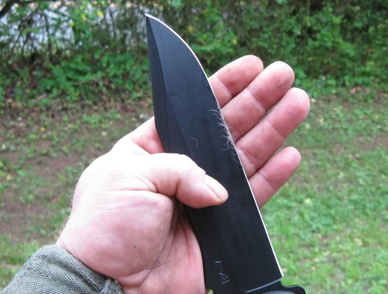

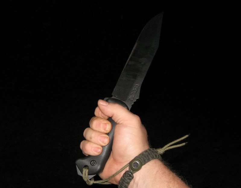

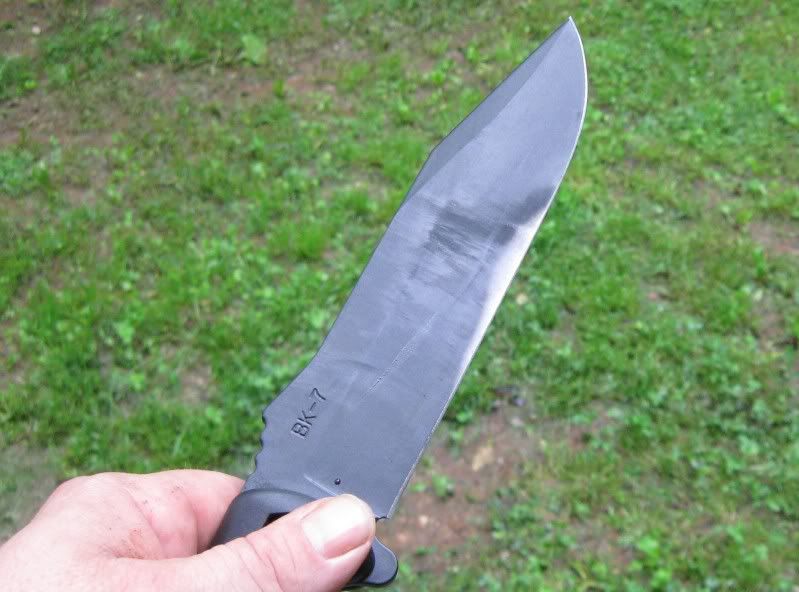

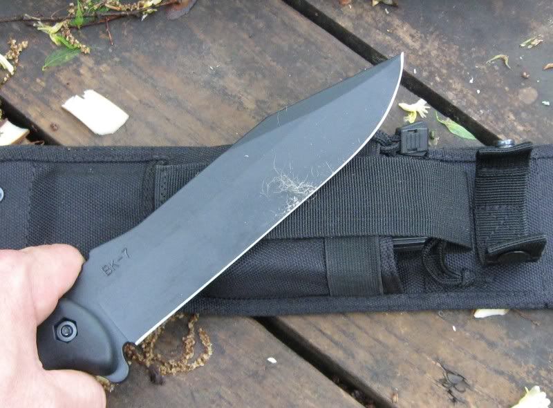

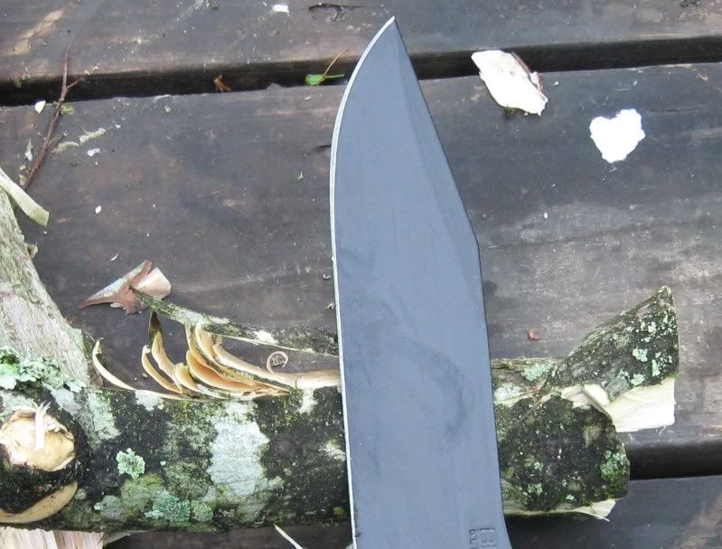

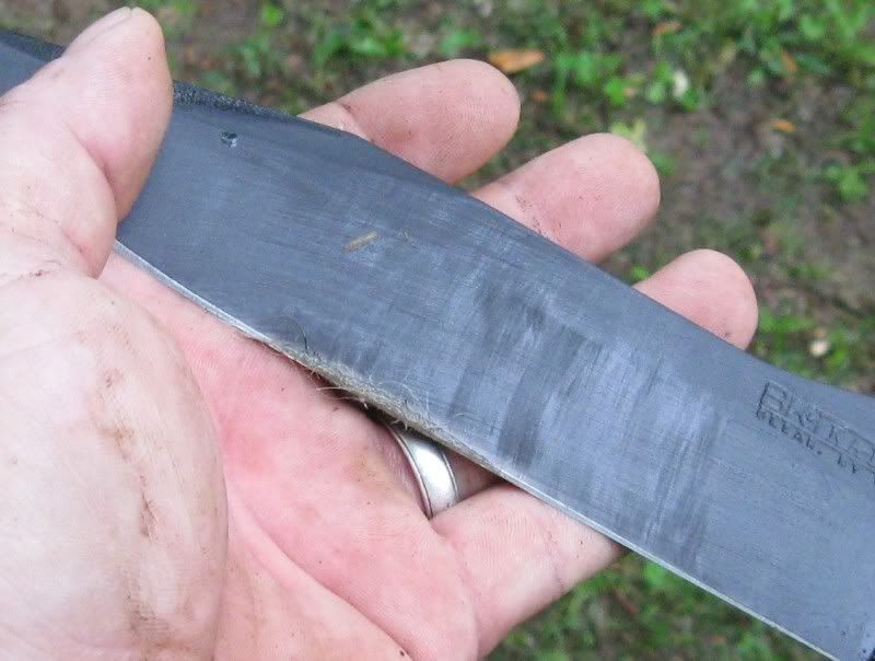

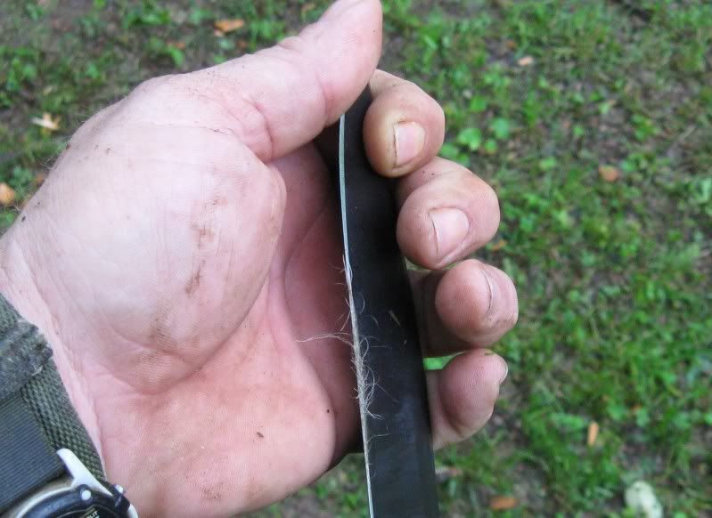

Not just impressive because it still shaves, but which part of the blade I shaved with....I wish there had been some hair left on my left arm. If you look at these two pics and pay attention it is pretty impressive as I have yet to take a stone to this blade...haven't needed to yet.

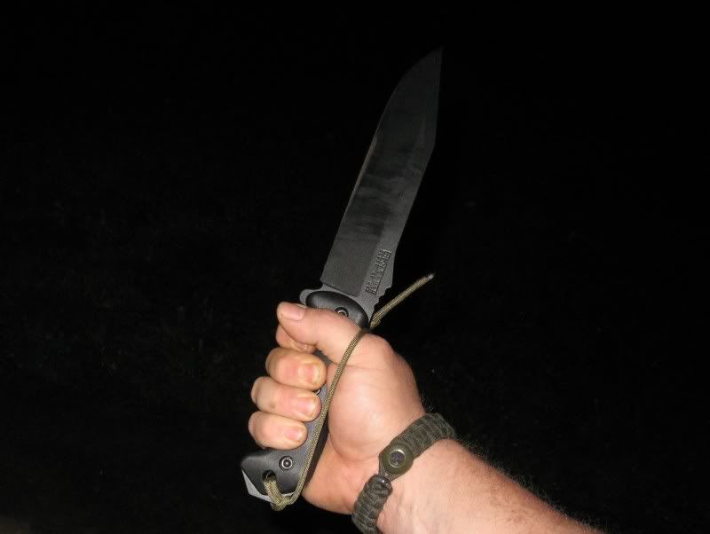

and if you take a good look at this pic..
this is what it looked like before I started chopping.
So far I am very impressed with this knife.

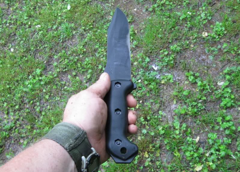

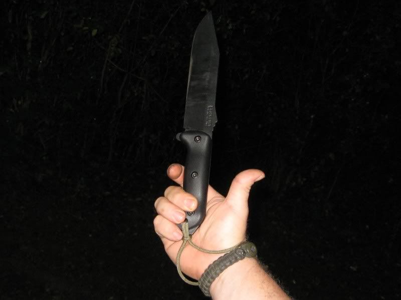

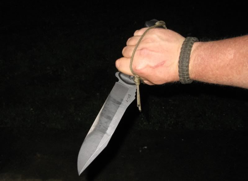

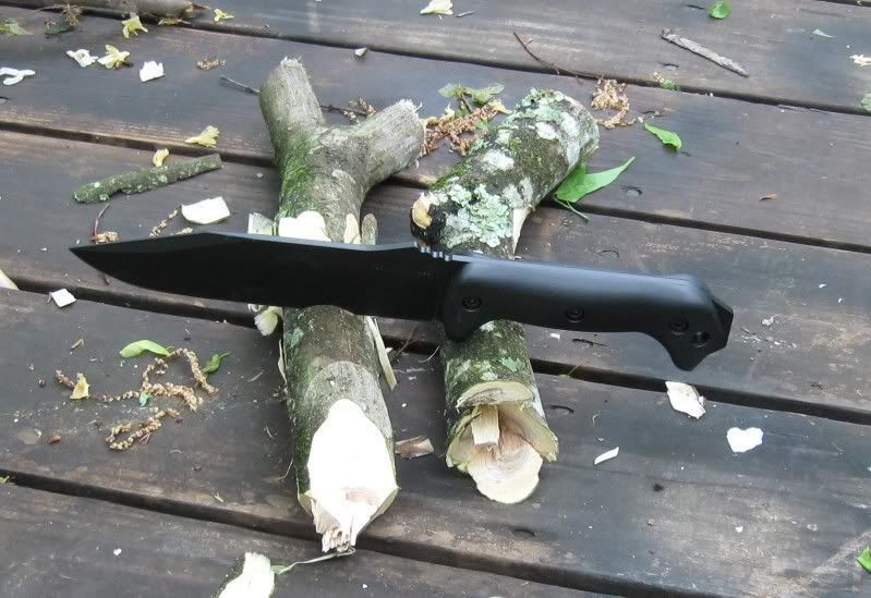

Ya know, sometimes in life there are things that come along which the more you play with them the more you like them. This BK7 is one of those things for me. I was just handling it out on the porch earlier, changing grips and just checking it out in hand a little, and realized just how much I really do like the shape of the handle. It’s just as comfortable in a reverse grip as it is in a standard one. And once I got the thong where I wanted it one position it was perfect for all the others.
Also I tend to do a lot of chopping with a rearward grip as to me it enhances chopping ability. The curve and shape of the handle make it very comfortable for me in this position but still allows for the protruding tang to use for breaking glass or…whatever.

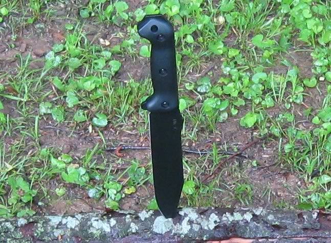

and another thing I noticed starting with this picture is the really low reflectivity, it really only reflects light when the light hits it straight on. The flash on this camera could probably be used to signal spacecraft.
