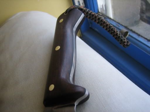

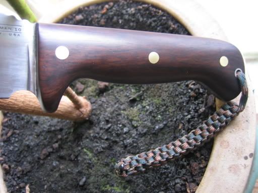

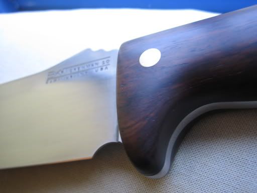

Ok, As promised I have finished the custom job on my Becker Crewman and here are the results.
I used the following materials:
Becker BK10 sent from Camillus New York as a replacement.
African Leadwood bought from a dealer in Minnesota.
Three brass Corby Bolts bought from Germany.
Polypropylene spacers (from a DVD case :D )
And a stainless steel thong tube from England.
The balance is almost neutral and only very slightly tip heavy.
Once again, all the work was done by hand apart from the drilling of the holes for the Corby bolts.
I hope you like it.:)
