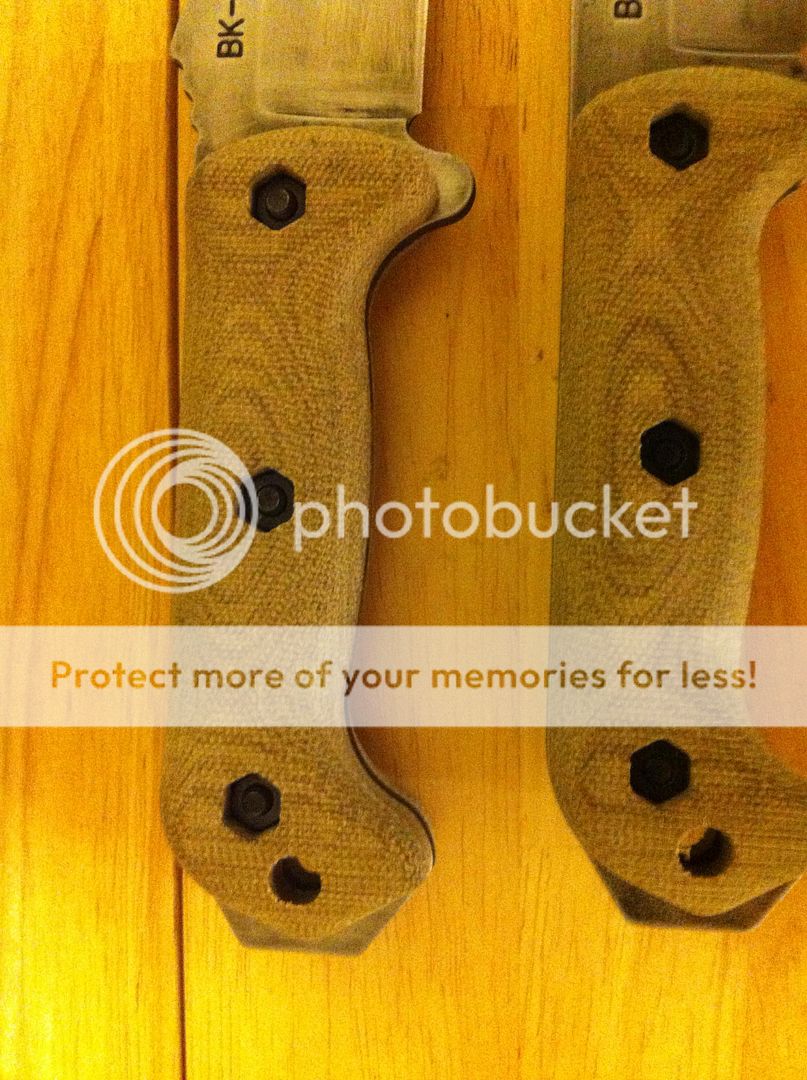

RE: Man those are sweet Richard ...How exactly does the jig work if you don't mind me asking?
Hi, in the last picture you see a Aluminium guide screwed into the wood base, to the left the router cutter has a ball race on the bottom so it follows the Aluminum plate you then screw your rough cut scale to the Aluminium and run the router cutter around it and you end up with picture number one. All hand work after that.

Cool, great idea TB. I just screw the rough cut scales onto the knife and sand if from there but its not the best method since each set of scales pretty much ends up being custom made for that particular blade and non-transferable between different models. How long does it take you to blank out the scales and do the aluminum templates get worn down and have to be replaced eventually? Btw, I've seen some of your stuff on the Australian blade forums...Great work.

No the Aluminium guides don't wear unless you break a router bit by forcing the cut.
Time I am retired so I get to take my time now :-)doing a set of Izula2 scales this morning took about a hour but they have the big 14mm hole in the end and I needed to put them on the mill to drill.

Those are mine, I wanted a rugged look so I wouldn't be scared to use it.
The next set are for a customer black with a slight tinge of red G10 then a nice satin finish on the blade.
