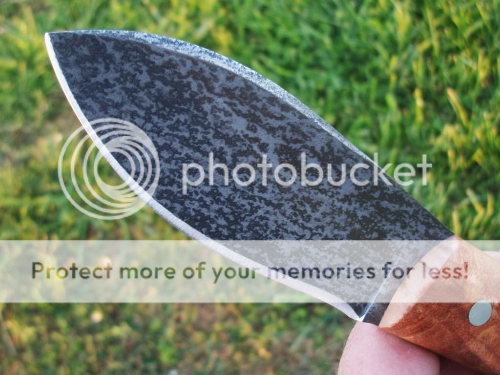

Earlier today, I went over to my good friend, Bill Akers (Backwoods Custom Knives) shop, and had him perform his blade wizardry on my Becker FPR 16. The attached pictures are crappy and don't show the details well, but all I can say is that the "Convicious" convex that he put on this Becker is flat out, jaw dropping, amazing! The kick ass ergos of the 16 and the new convex edge allow my old, arthritic hands to easily do bushcrafting tasks!

that is staggering! literally made me drool some. oh gawd that treatment would look AWESOME on the 17! or 15, or 16.....or 2,3,4,5,7,9 etc etc!
What is the finish? or is it his secret? I would love to know the details on that blade work!
Holy balls, that is beautiful! yes, please let us know about the finish..
Damn, that does look nice!!! Good looking edge and I love the finish. How was the finish accomplished?
Its just bleach and gun blue guys but i have done it so much timing is everything
Bests,Bill
Here is a few pics of one of my handmade muks with that finnish and my convicious edge i finnished today after i did Riverwarrior's peice.
Interesting....boiled in bleach. Ive just been using cold bleach.
*eyes the poor unsuspecting Beast2 on the desk*
Oh, it's gonna happen! Matter of time. And I have to devise a method to boil outside. Thinking propane grill LOL
