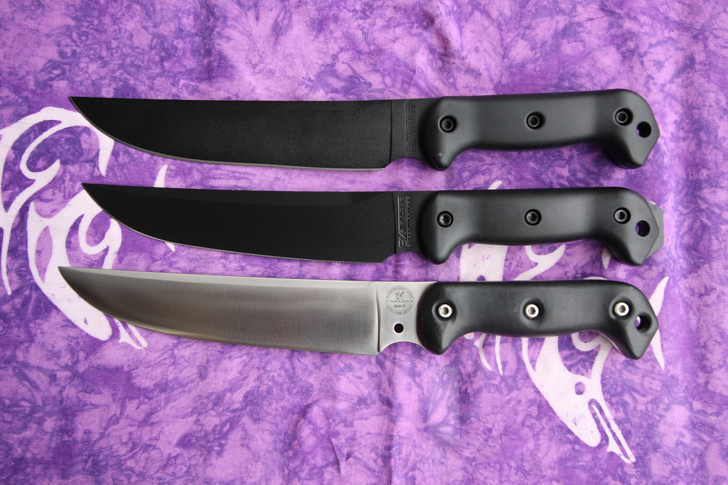

WARNING WARNING WARNING - FAKES - BUYER BEWARE
If you see BK-06 Patrol Machete, Becker Machete, or other variants on name, being sold/traded NEW IN BOX, be very careful...
o Fake box has a picture of Ethan Becker a Patrol Machete ... Bad sign. Fake.
o Fake box has chinese characters on it. VERY bad sign. Very fake.
o Fake patrol machetes are mirror Silver or "Gray" - real models are black coated only
o Fake patrol machetes are made out of 420A
o Fake patrol machetes are listed at 57 HRC
o Fake blades have "Adolph Kaster" listed on them in cursive script
o Handles don't look right... Camillus never made "ebony" handles
o Fake screws are cheesy slotted bolts not proper hex-caps
o Need i go on? :) If it's too good to be true... Caveat Emptor Big Time
o They're unauthorized counterfeit copies - fakes - BUYER BEWARE!!!

oo BK-09 - Combat Bowie
ooo Camillus, and variants (desert, hog hunter)
Bottom two knives in top picture are Camillus BK-09s
From the Camillus literature: '''Exclusive high carbon steel (0170-6C) flat ground blade, 58-59 RC blade hardness, black epoxy coating, Becker trademark GV6H ergonomic handles, Kydex multi-carry sheath system, Proudly made in the USA''' and '''??? inch overall length, 9.0 inch length blade, .025 inch thick blade'''

comparison shot of Camillus vs KaBar thickness

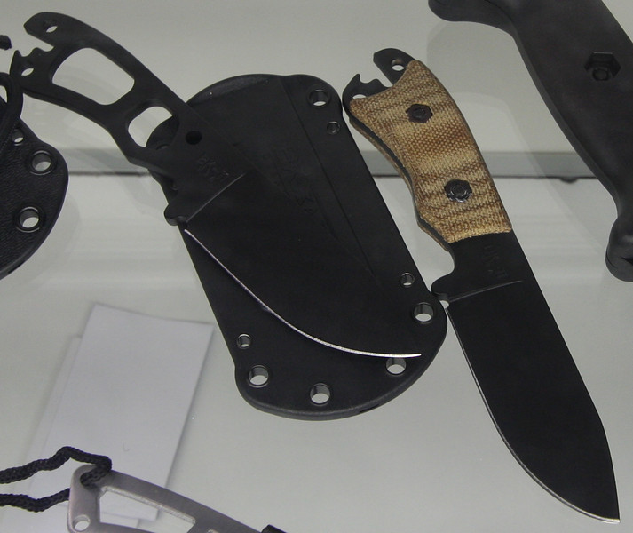

Some pictures from Blade Show 2009 with various neckers, including the Prototype BK-11 Micarta handles...
(ignore the price lists, those are show prices :>)

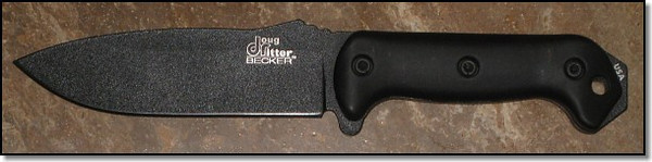

Doug Ritter RSK® Mk2
Design Ethan Becker & Doug Ritter
Blade Material 1095 hardened to 57 HRC
Blade Length 6 in. (15.24 cm)
Blade Thickness 0.188 in. (4.78 mm)
Blade Shape Wide-Chord Drop Point
Blade Grind High Flat Grind
40º inclusive edge, 8º bevel
Overall Length 11.375 in. (28.89 cm)
Balance Variable Perfect Balance™
Weight (full up) 13.2 oz. (374 g)
Weight (w/ all 3 brass plugs removed) 12.8 oz. (263 g)
Tang Style Full, extends past handle material at rear, lanyard hole
Blade/Tang Finish Charcoal Gray Powdercoat
Handle Material Black Glass Reinforced Swiss GV6H
Sheath Multi-carry Ballistic Nylon w/ heat molded Liner
