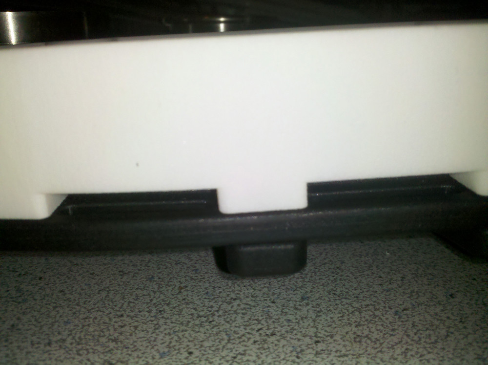

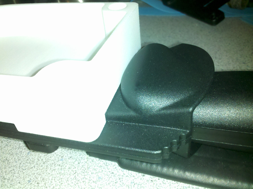

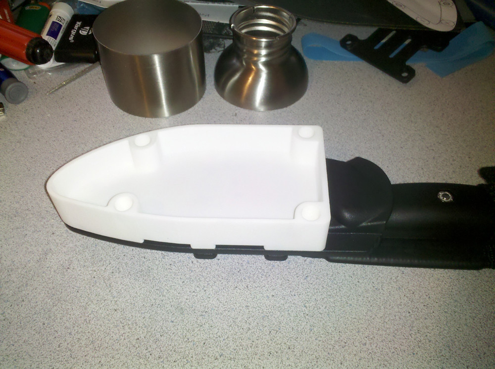

Well, despite having gone through Louisville, my package did in fact arrive today. Here she is. (Excuse the crappy phone pics, better ones later once I track down the good camera and whatnot. Too excited now to spend a buttload of time on it.)
So thrilled. It fits! There is one spot that was a smidge off, like less than a millimeter, but everything else is functional! Gotta go order the lid now.
Also in the background of the first shot there is my stainless steel alcohol stove that I am working on. Just thought I would throw that out there.

how tough is that printed material? or are you going to have to fabricate out of glass filled nylon later

Aye, wrong color, but spray paint does wonders. Strength, I would say it is pretty good. If it was made out of the same stuff as the sheath, it would be awesome, but I have no idea what that stuff is, nor how to get it, and probably couldn't afford to even if I could. This stuff would do. Glass filled nylon, no way I can make that happen. Nylon is not even close to being something I could fabricate in. The best I could do is glass filled whatever-kind-of-resin might hold up, and that is a long shot at best. Gotta wait til christmas is over before I can fill the box. Got some very specific things I want in her.

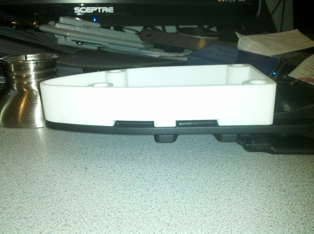

Right at 3/4", sir.

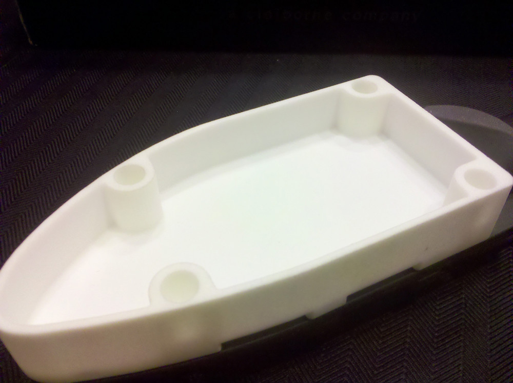

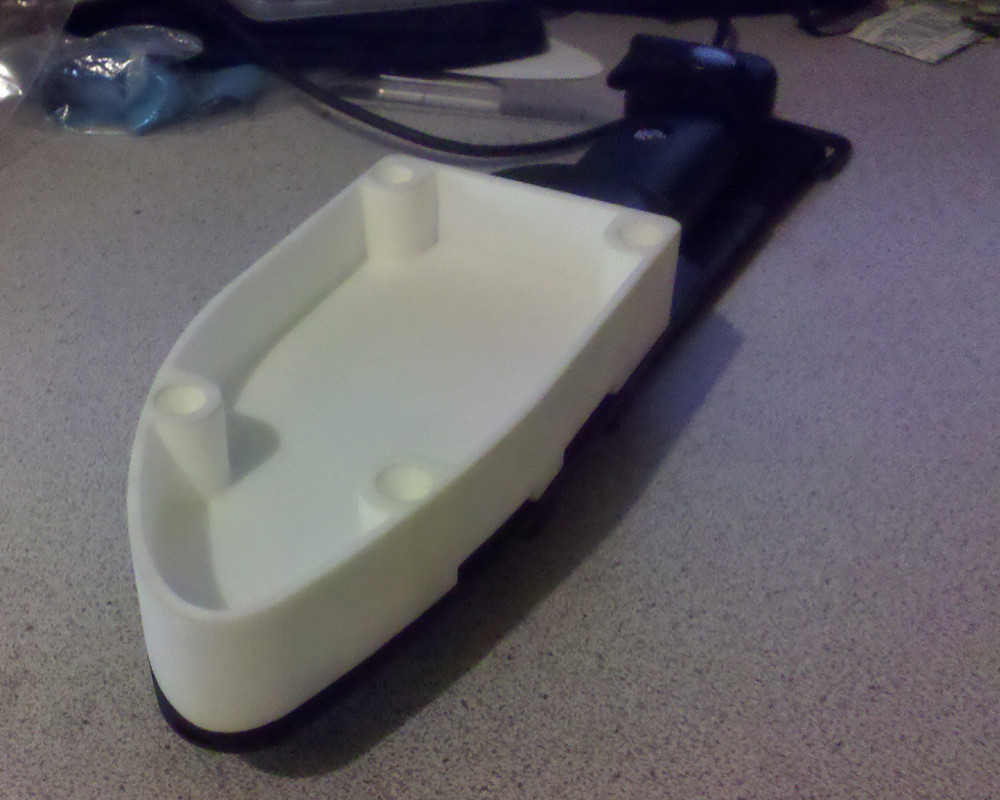

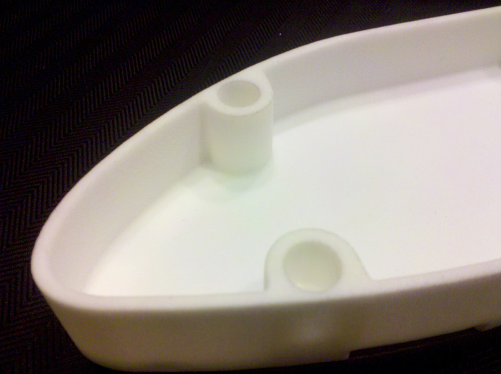

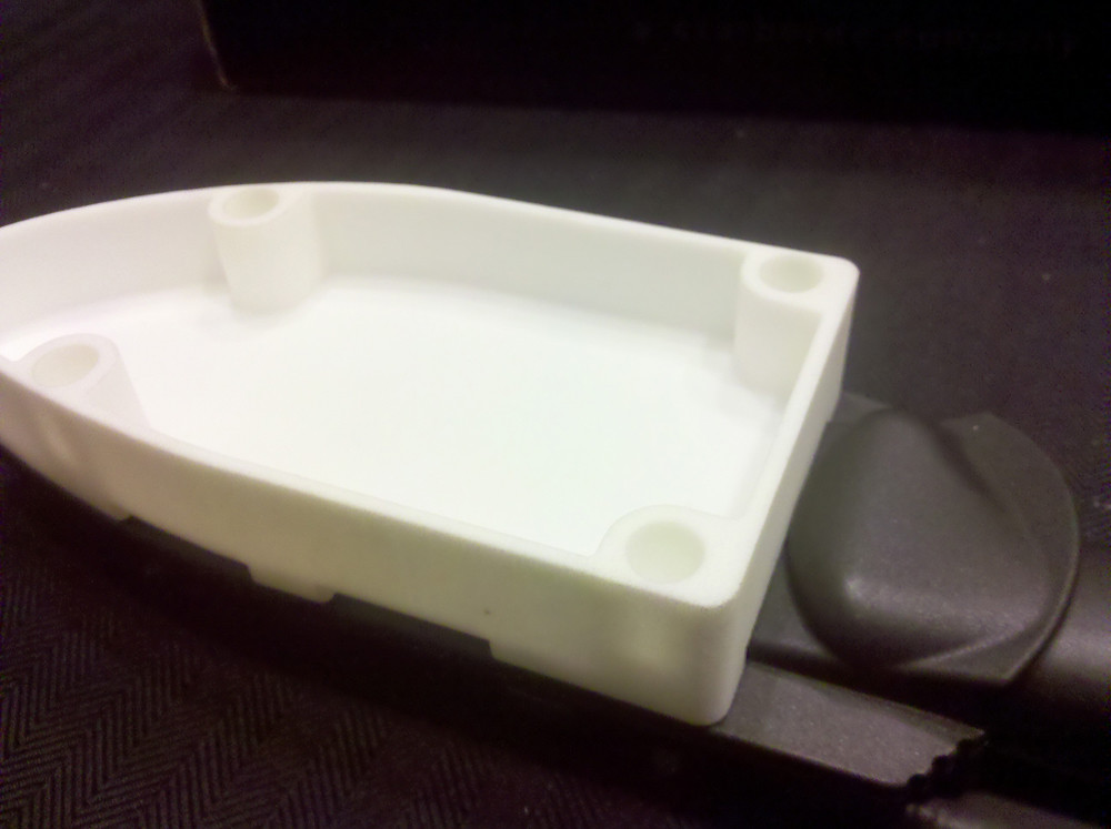

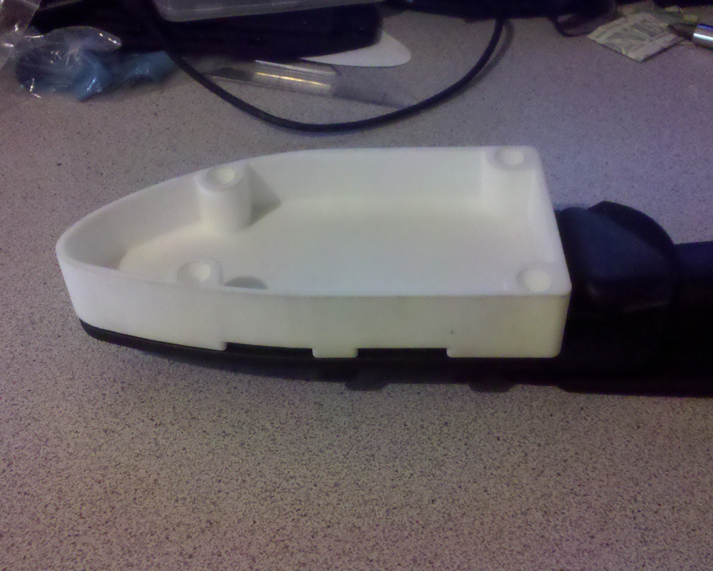

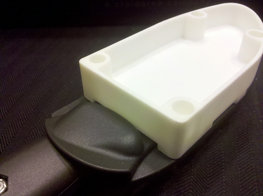

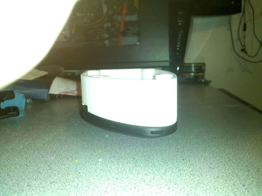

More pics! Sorry, still from phone, the missus decided to hide the actual good camera, the memory card for the crappy camera, and my lighting isn't that good anywhere in the house for this. (Need a lightbox. Wouldn't help with this being all white, but still...)
