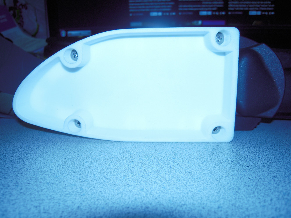

For the lid, keep it simple..4 pegs, and a velcro strap that runs around the sheath, through a couple of loops on the lid. With the pegs, it wont come loose...its science.

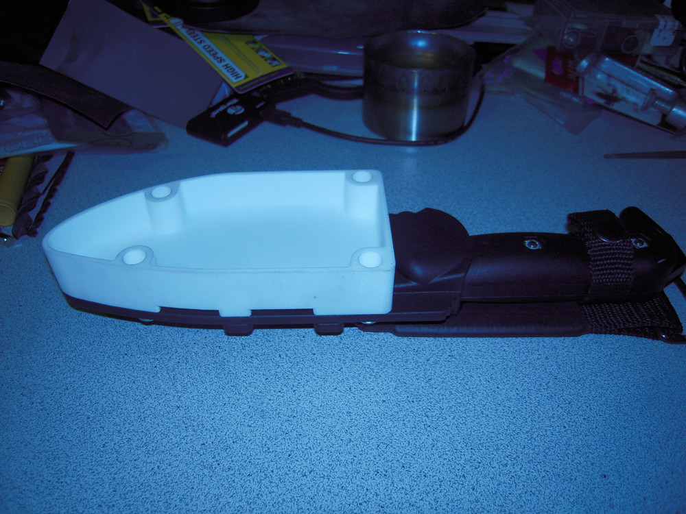

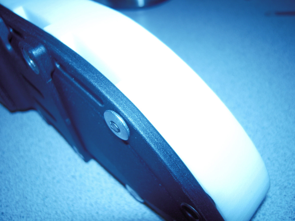

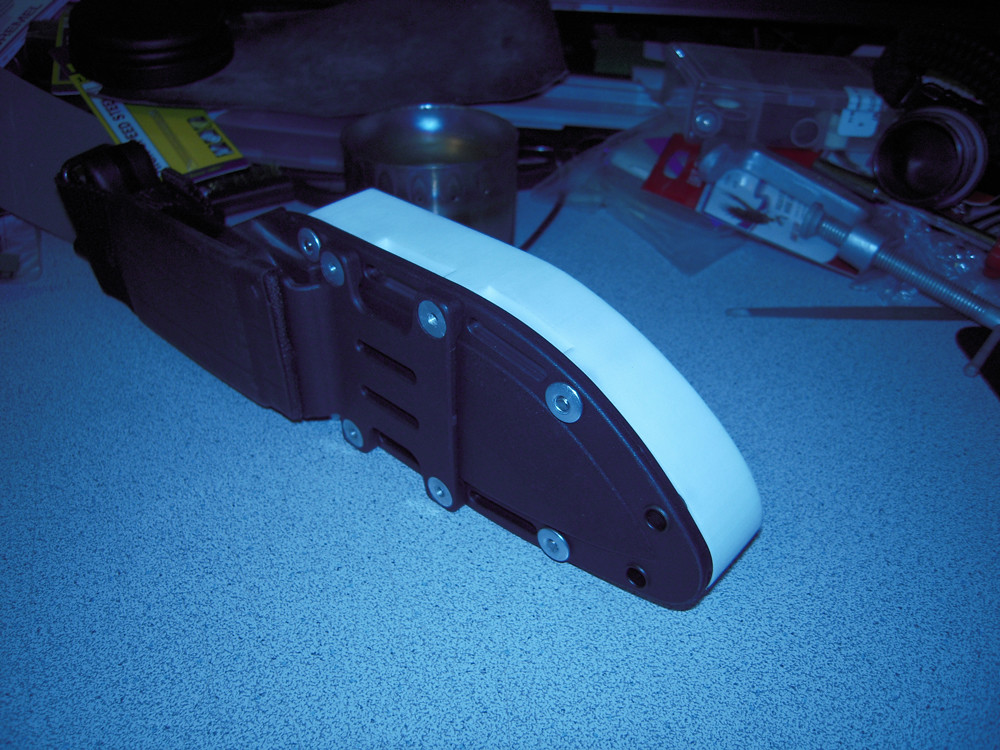

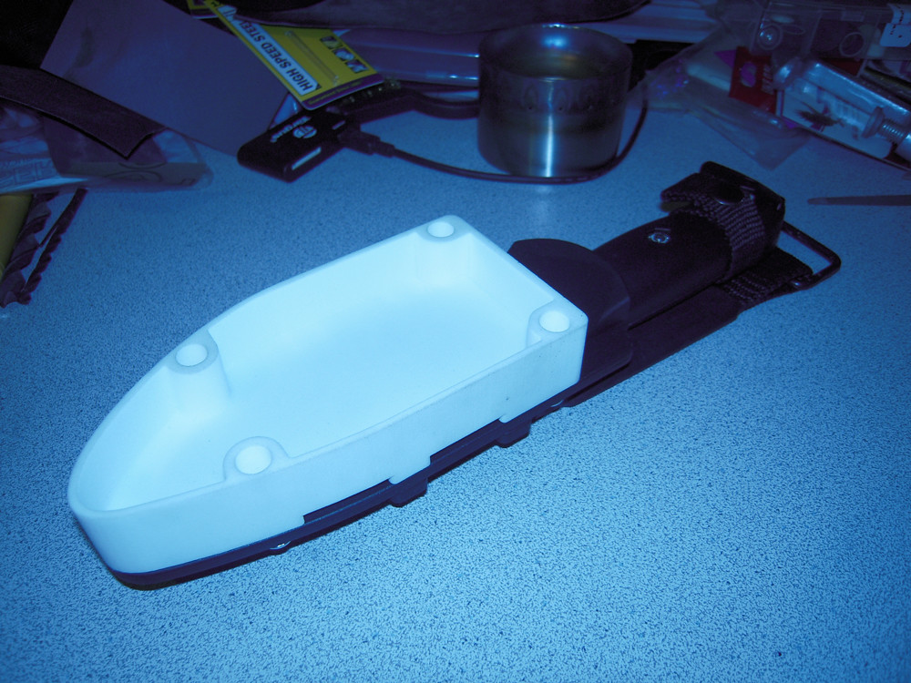

Great idea, looks very functional. Noticed you have upgraded your handle screws too, what are they and size?
Stainless steel 10-24 at 3/4" length with stainless steel nylon locking nuts. For those who might wander what all that jive means, 10 is the size, 24 is the thread pitch, 3/4" is the length. Nylon locking nuts have a small nylon washer worked into their design that is slightly smaller than the thread hole, providing a means of stabilizing and reducing vibration in the screw, making for much more secured screw. The nylon lock nut idea came from someone else here, and I take no credit for it. My original hardware wasn't rusting, but I figured why not go ahead and take preventative measures.
I purchased them at Lowes I believe, somewhere in the wall o' screws.

A good idea for easy access. Unscrewing four bolts/screws would be time consuming.
