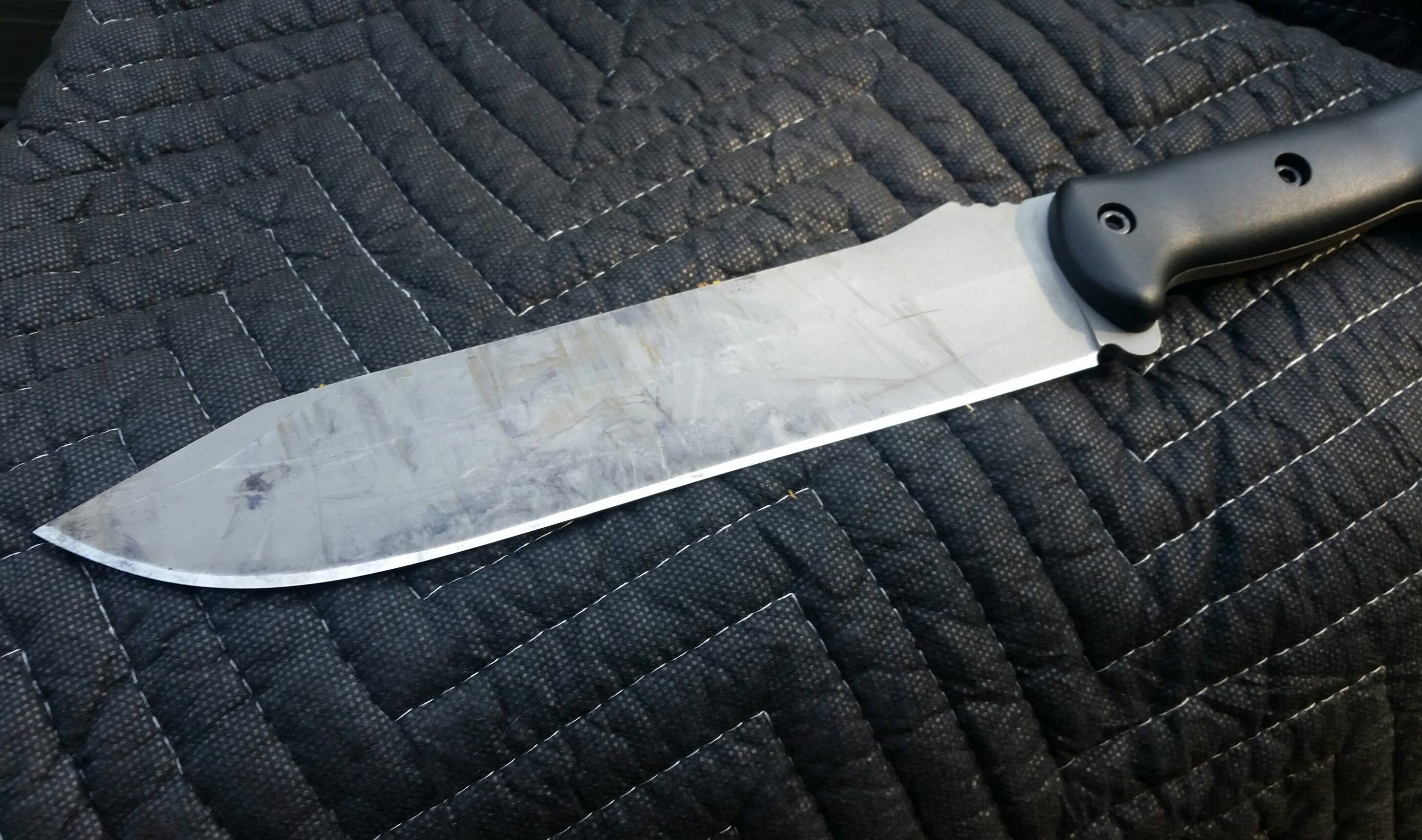

So out habit from using cheaper knives I tend to sharpen my hard use knives at about 25° per side. I'm trying to break myself of this habit since my Beckers and other higher quality knives will obviously hold up better than Chinese mystery steel. So I'm curious what angle you guys are sharpening your Beckers at, like the bk2 , 7, and 9 that see allot of impact cutting that gives a balance between sharpness and longevity.
I've read about guys thinning out the edges on there choppers and running low angles, but how well do they hold up afterwards? Right now my 2 is close to 34° inclusive and the 9 is close to 30° inclusive. I haven't had a chance to really use em much yet to see how durable they are but there both insanely sharp.

I convexed my 2 and held it at about a 17° angle. I've done light testing (feathering, and carving mainly) and it does a lot better than the factory edge. I'm pretty sure than a 34° inclusive edge on the 2 will be fine and hold up to the heavy use of batoning and chopping. I'm just not sure if thinning it out more would be a good idea, yea it'll make it slice better but would it hold up to impact cutting?

Anyway this 9 I haven't used much, it's held up to what I've done so far thou. I didn't set the bevels on this one, I bought it as is and the seller said he thought it was 17°dps, thou when I touched it up a lil and used the sharpie trick I had to hold closer to 15° to evenly remove it.

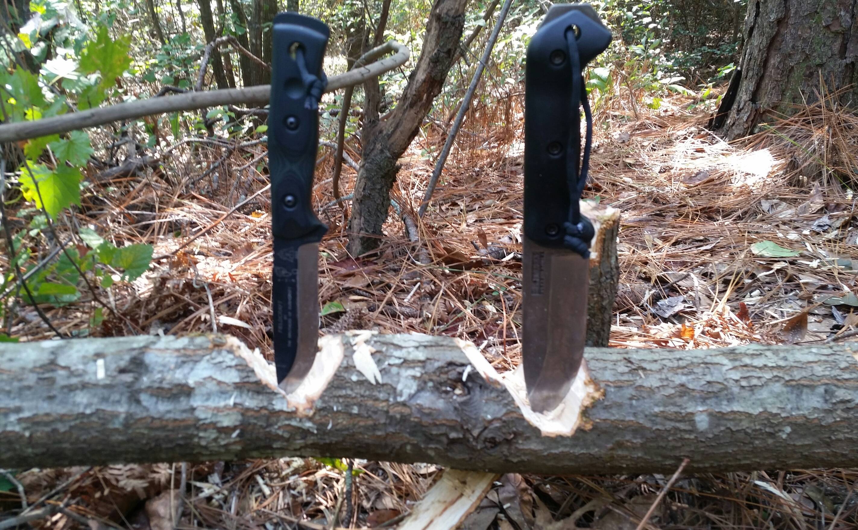

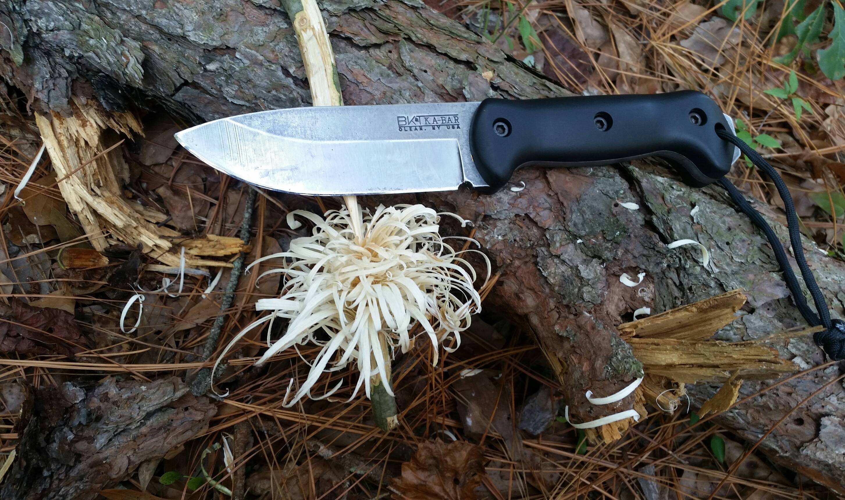

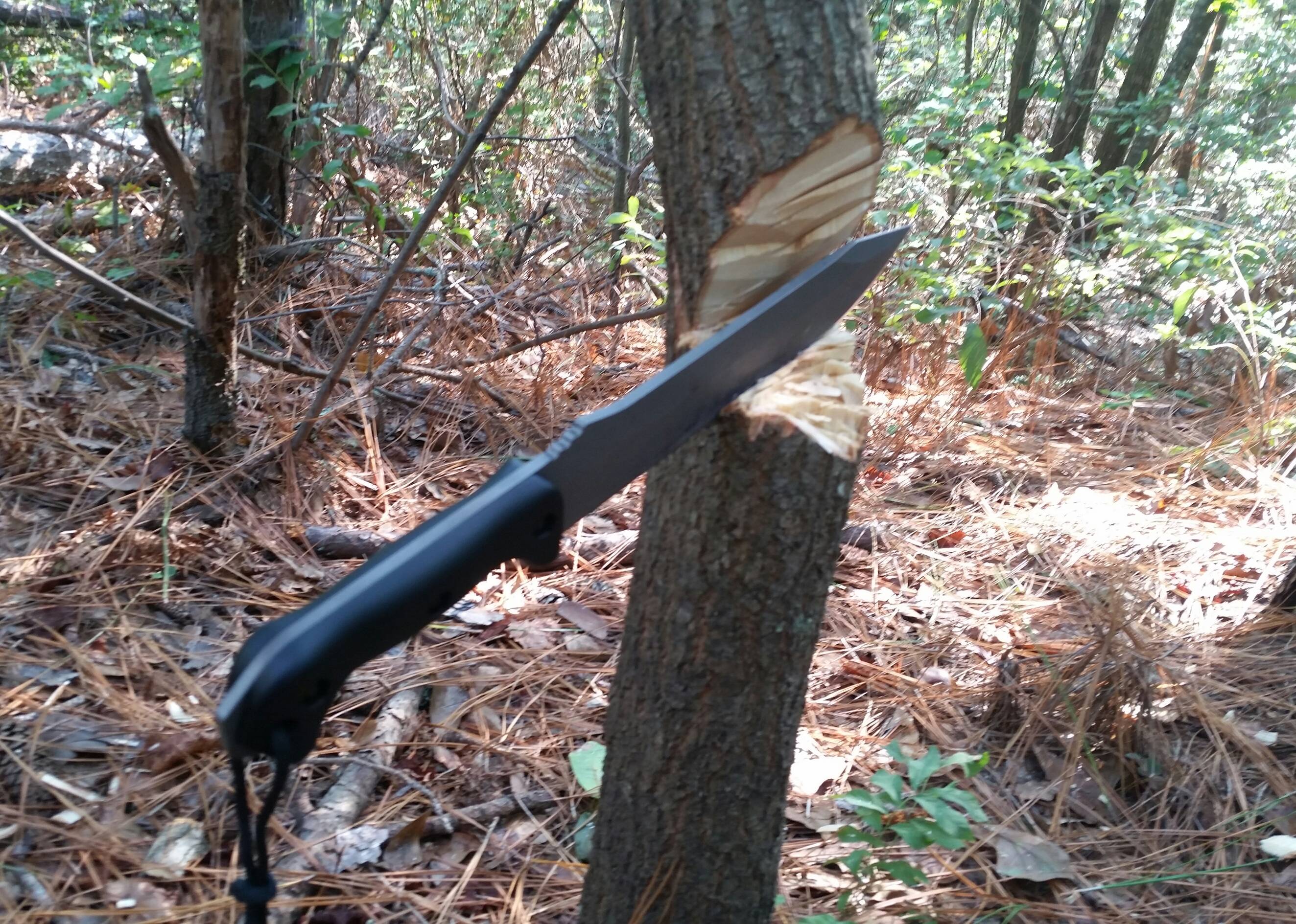

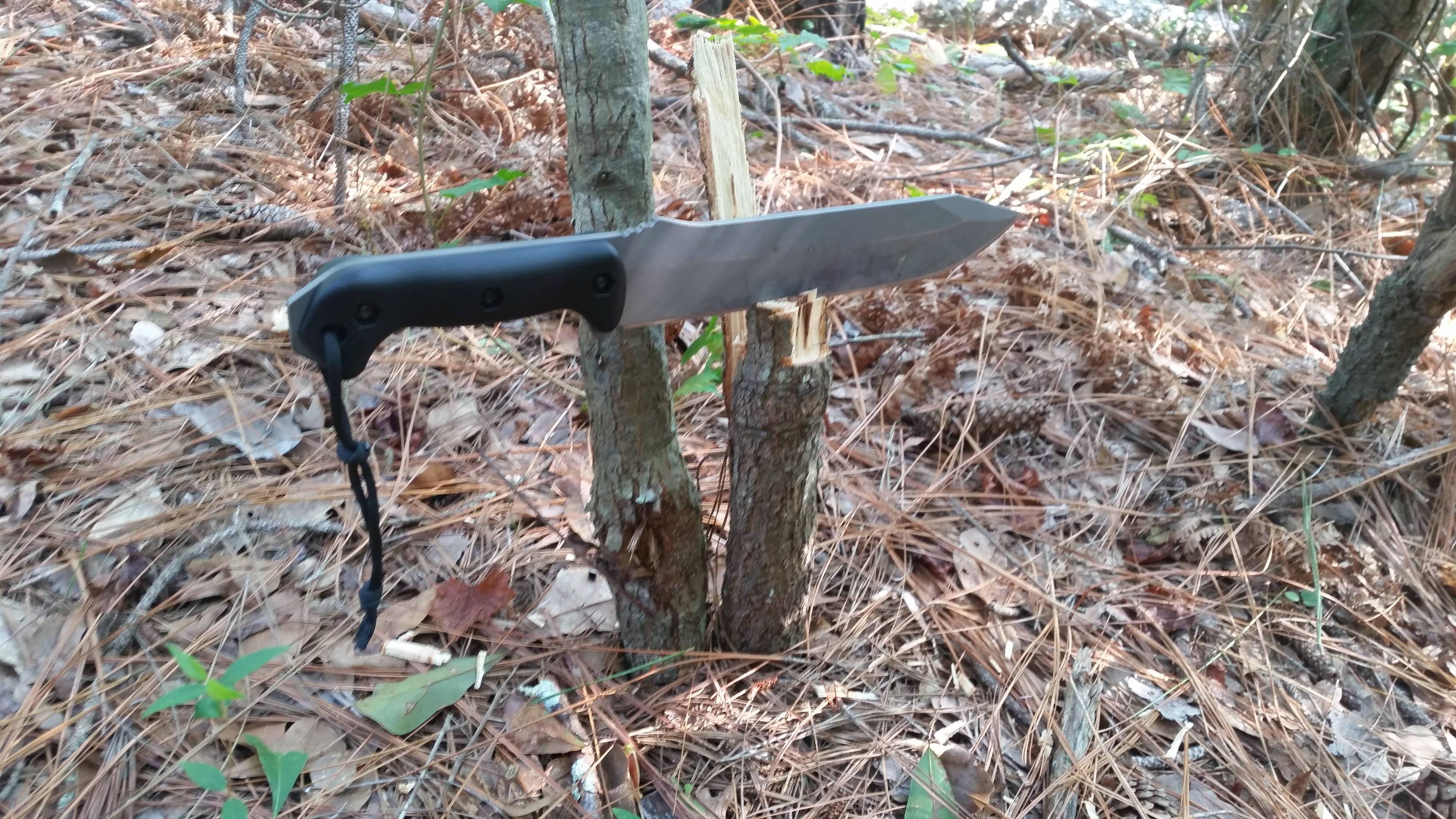

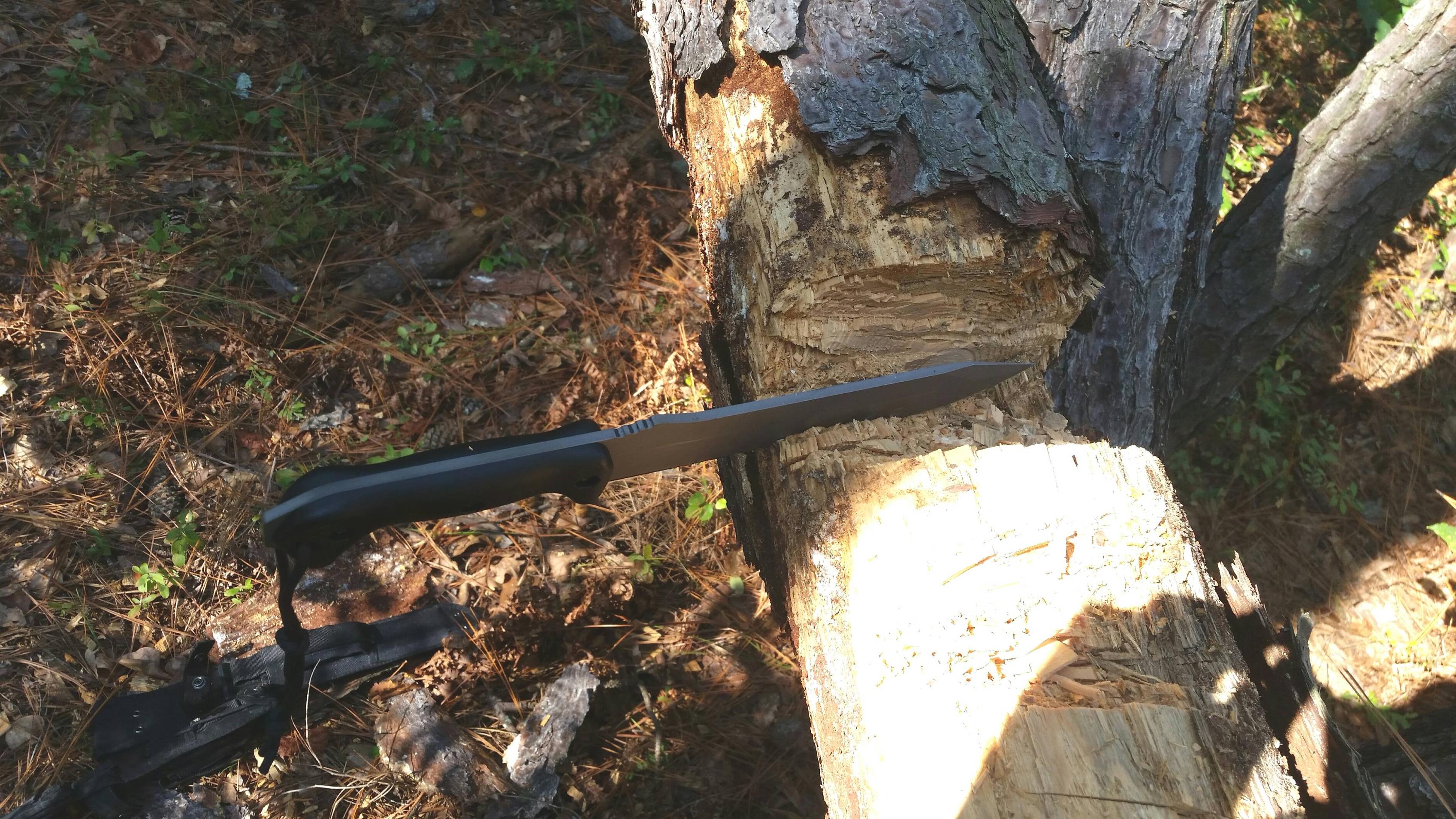

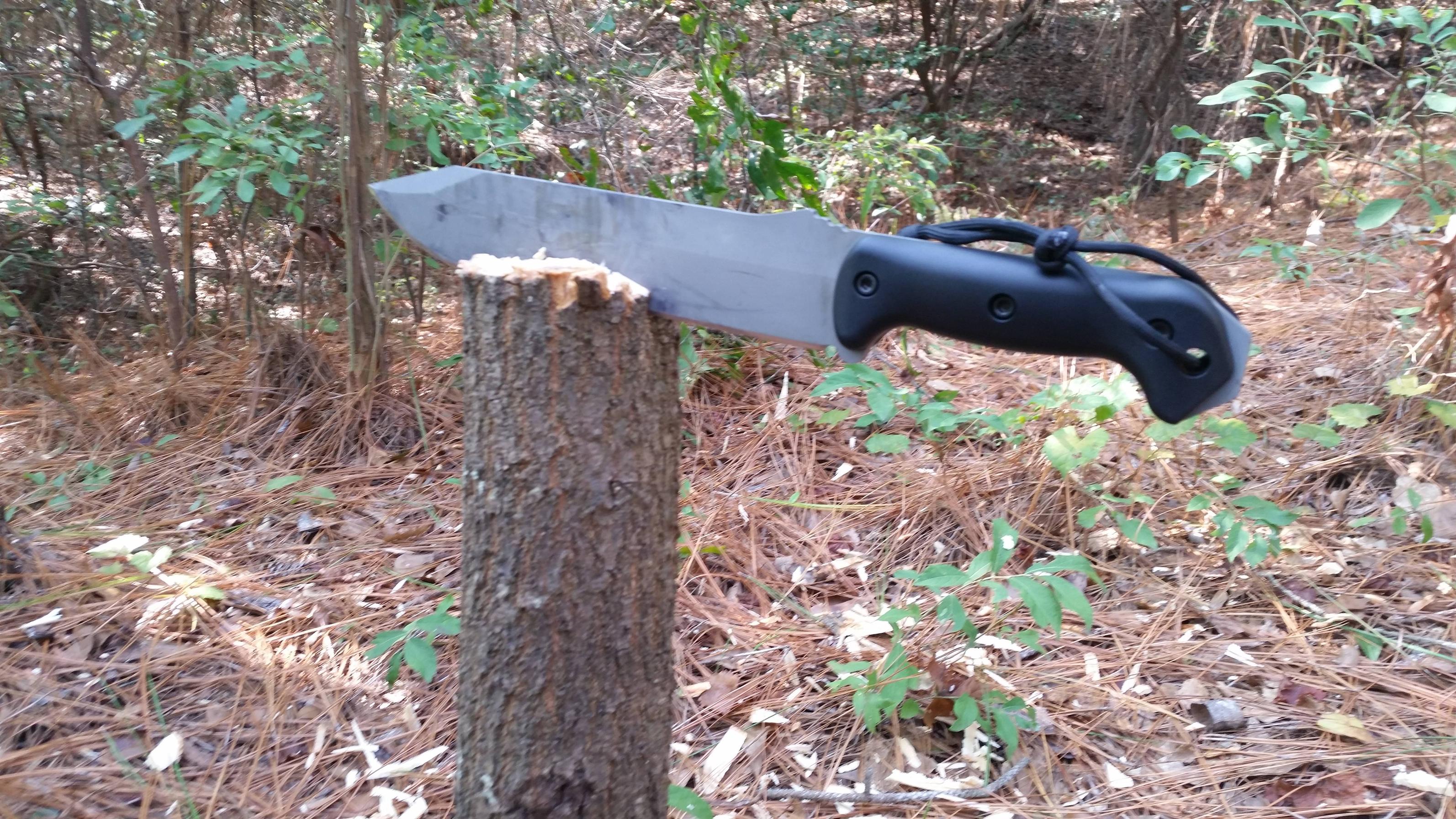

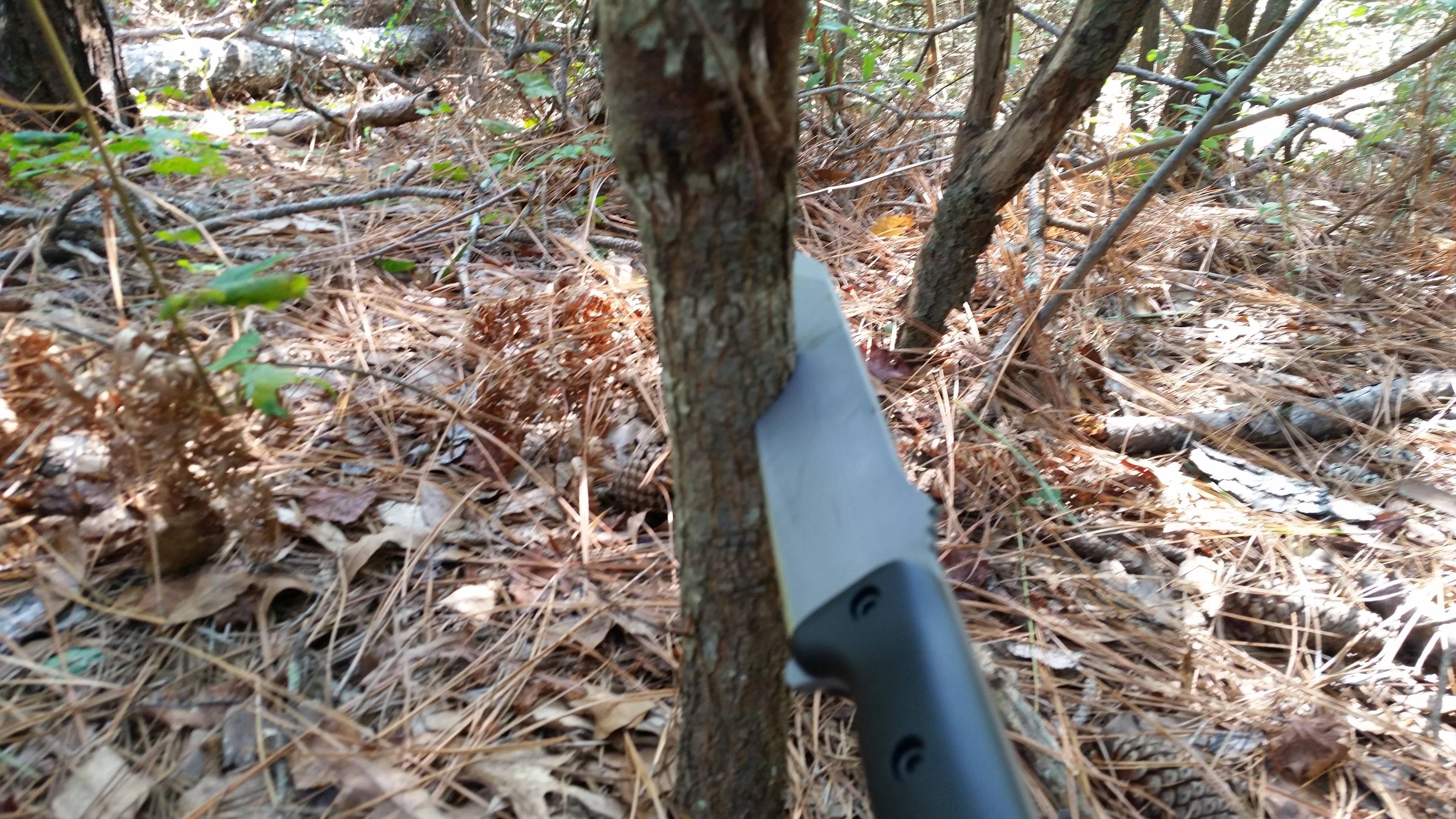

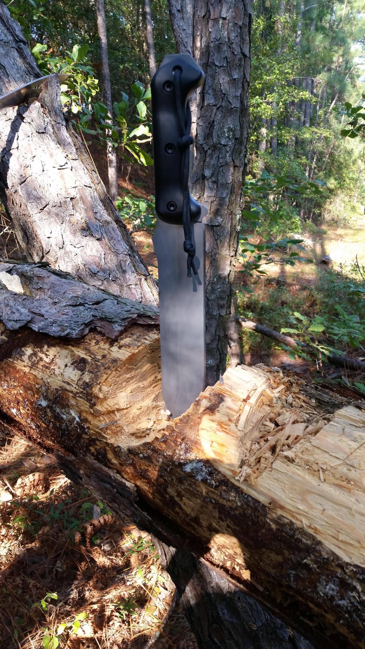

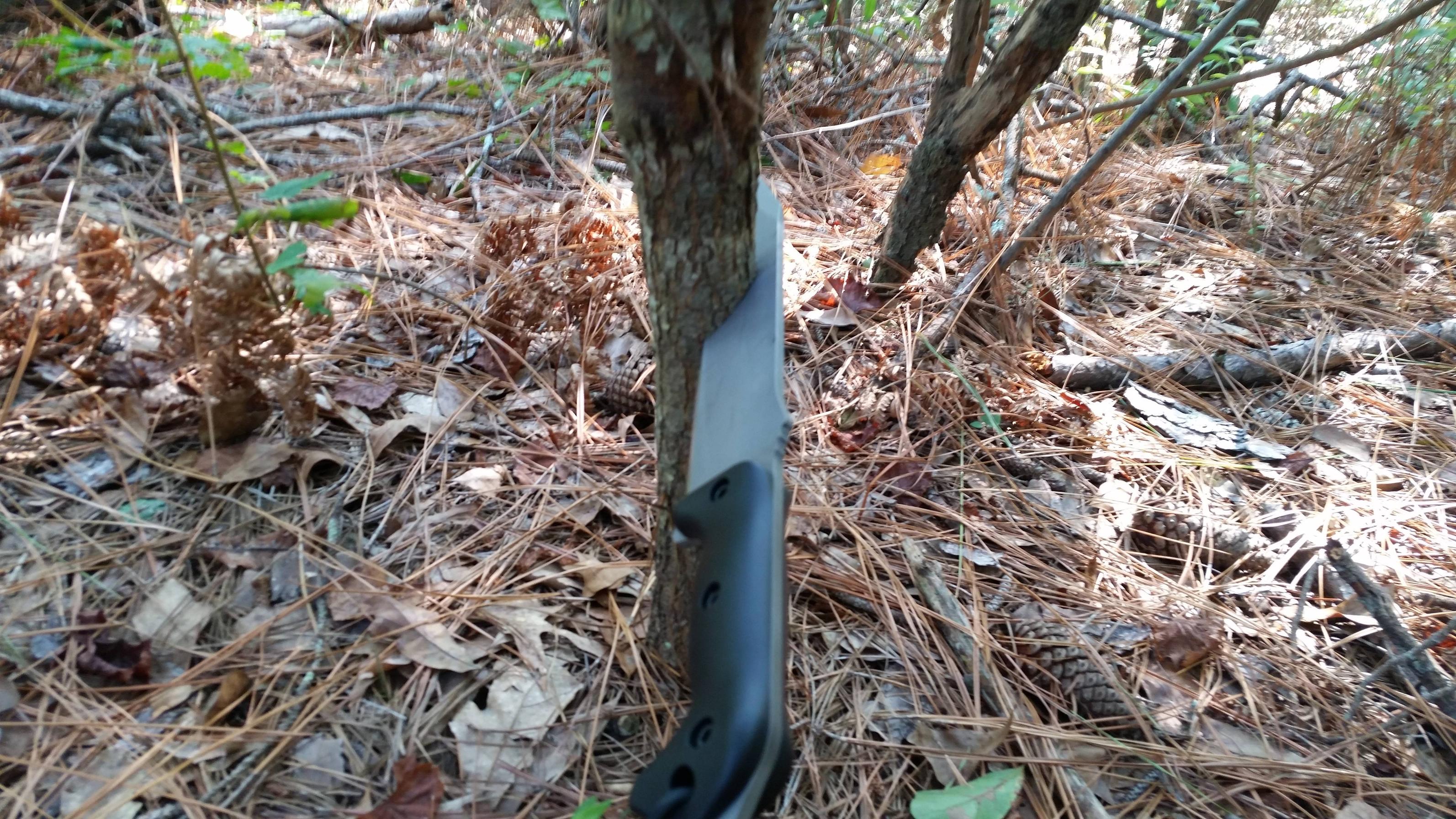

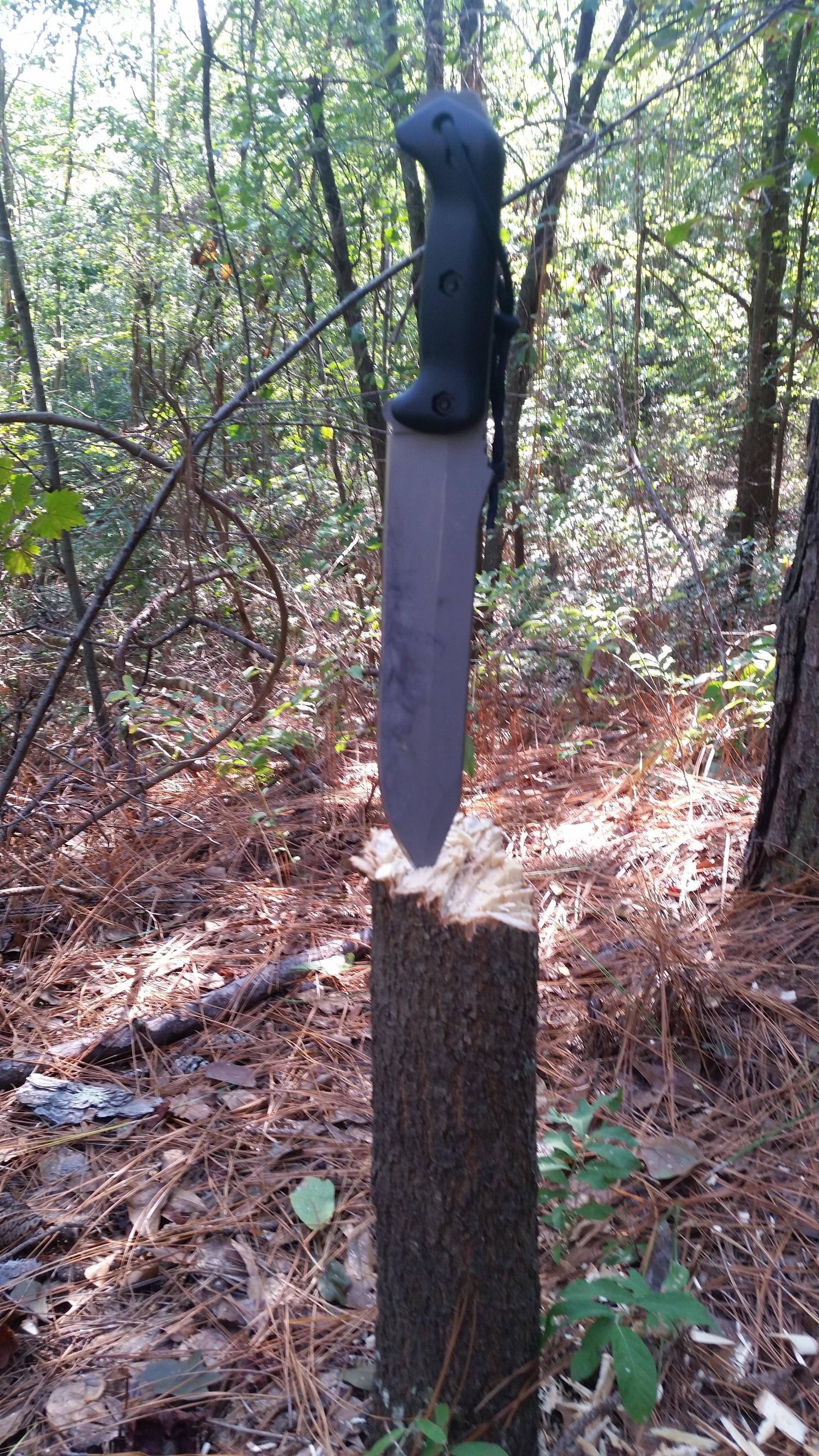

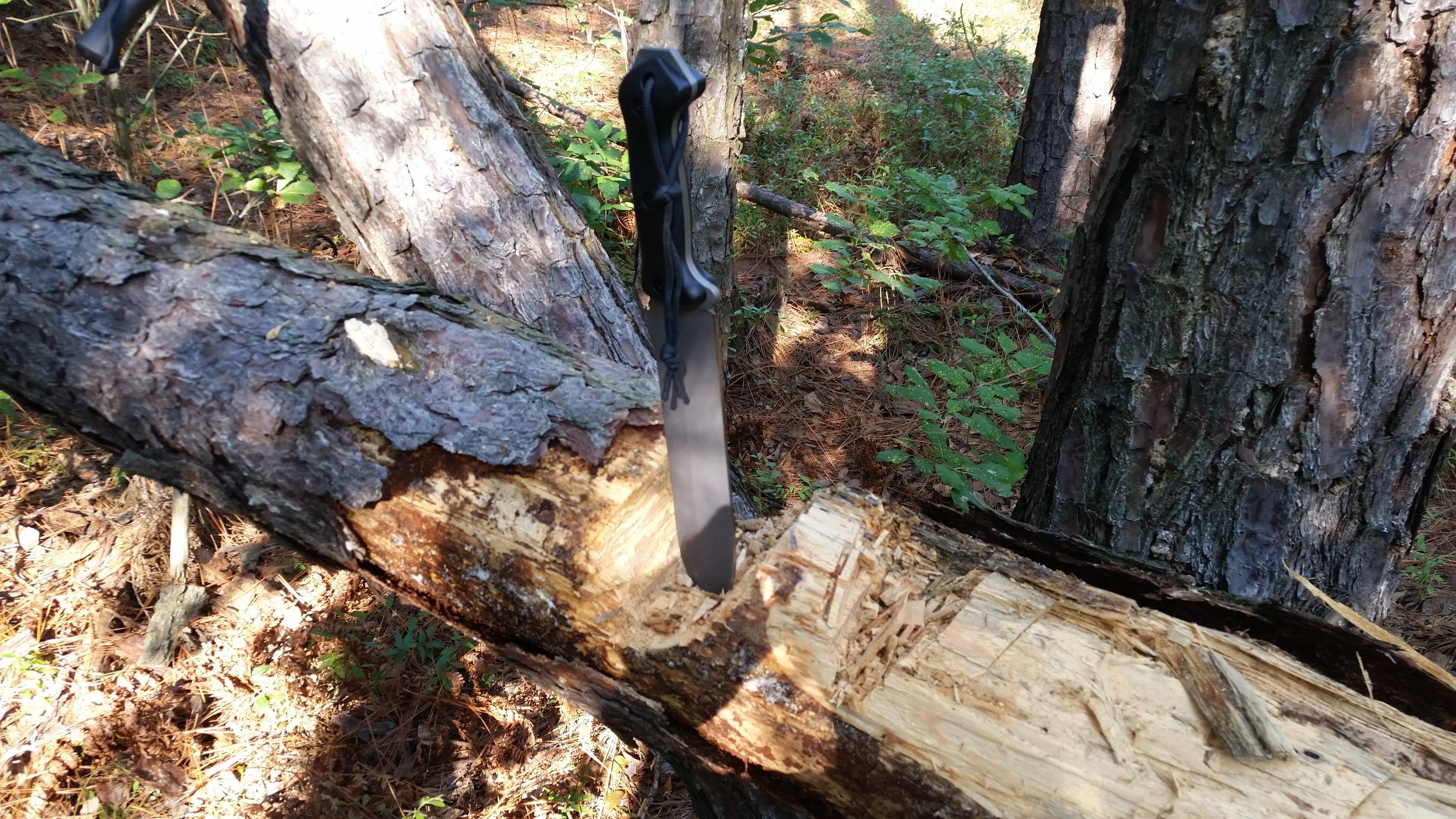

I finally got a chance to take em out to play today...
The bk9 for having such an acute edge did amazing and held up no problem. It actually made it preform much better, I've used a stock 9 before and it chopped great. This one however definitely out chops a factory edge, it bites deep making short work of whatever your going through. Afterwards the edge is intact and still incredibly sharp, the only thing that didn't last was the sand blasted finish.
The bk2 held up great as well, I found my sweet spot for the edge. It holds up great to the abuse and performs finer tasks with ease.
On a side note I put the bk2 in a chop test side by side with the tops BOB. 40 chops with each and the bk2 blew the BOB away.

I've yet to use a knife in its class that can compare.. I started to add the benchmade 162 in the mix but it was sad how badly it chopped so I saved it some embarrassment lol...everything I did with the 9I could also do with the 2 thou it would've taken a lil longer.
Nice test there Bobby.
