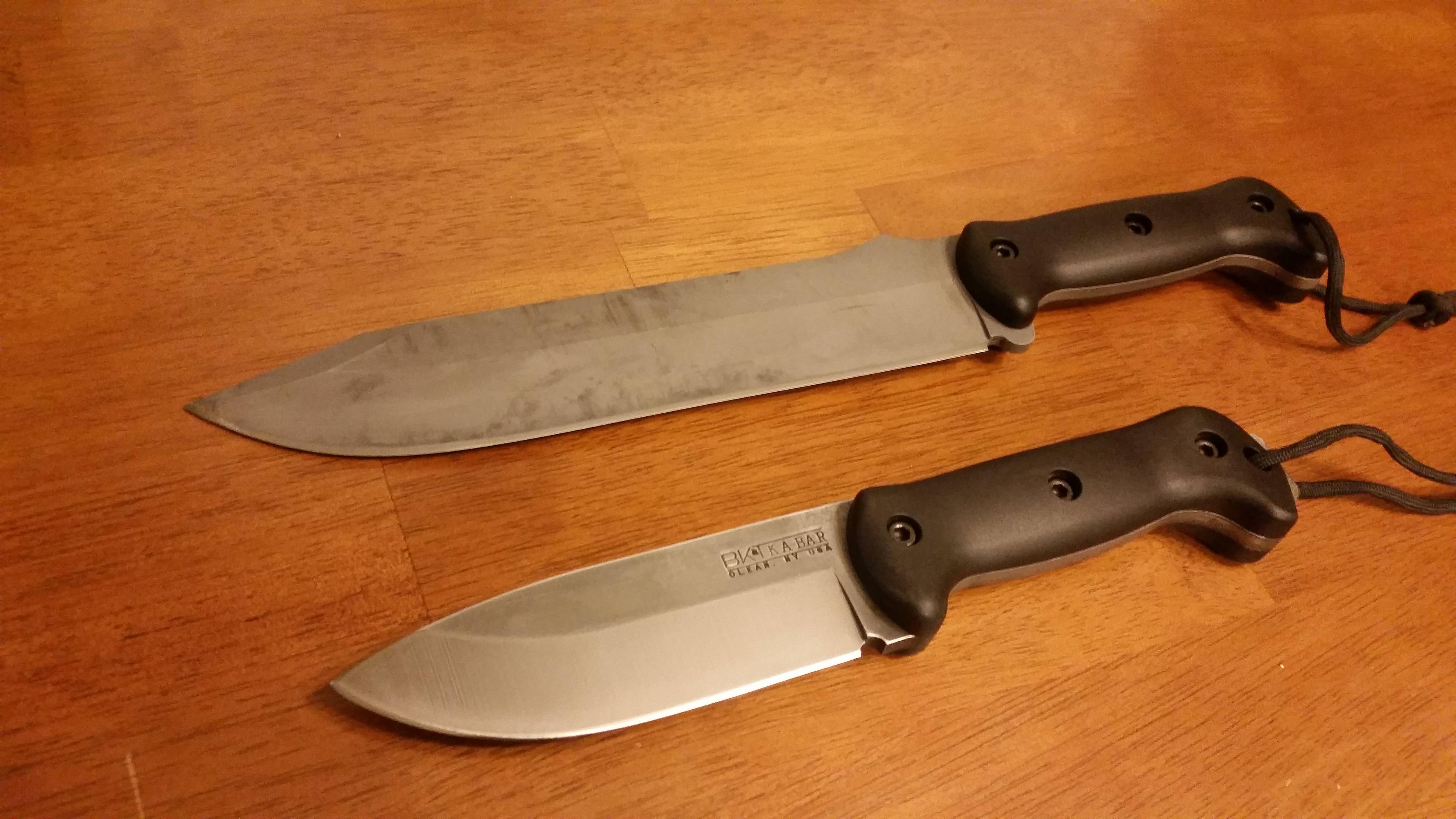

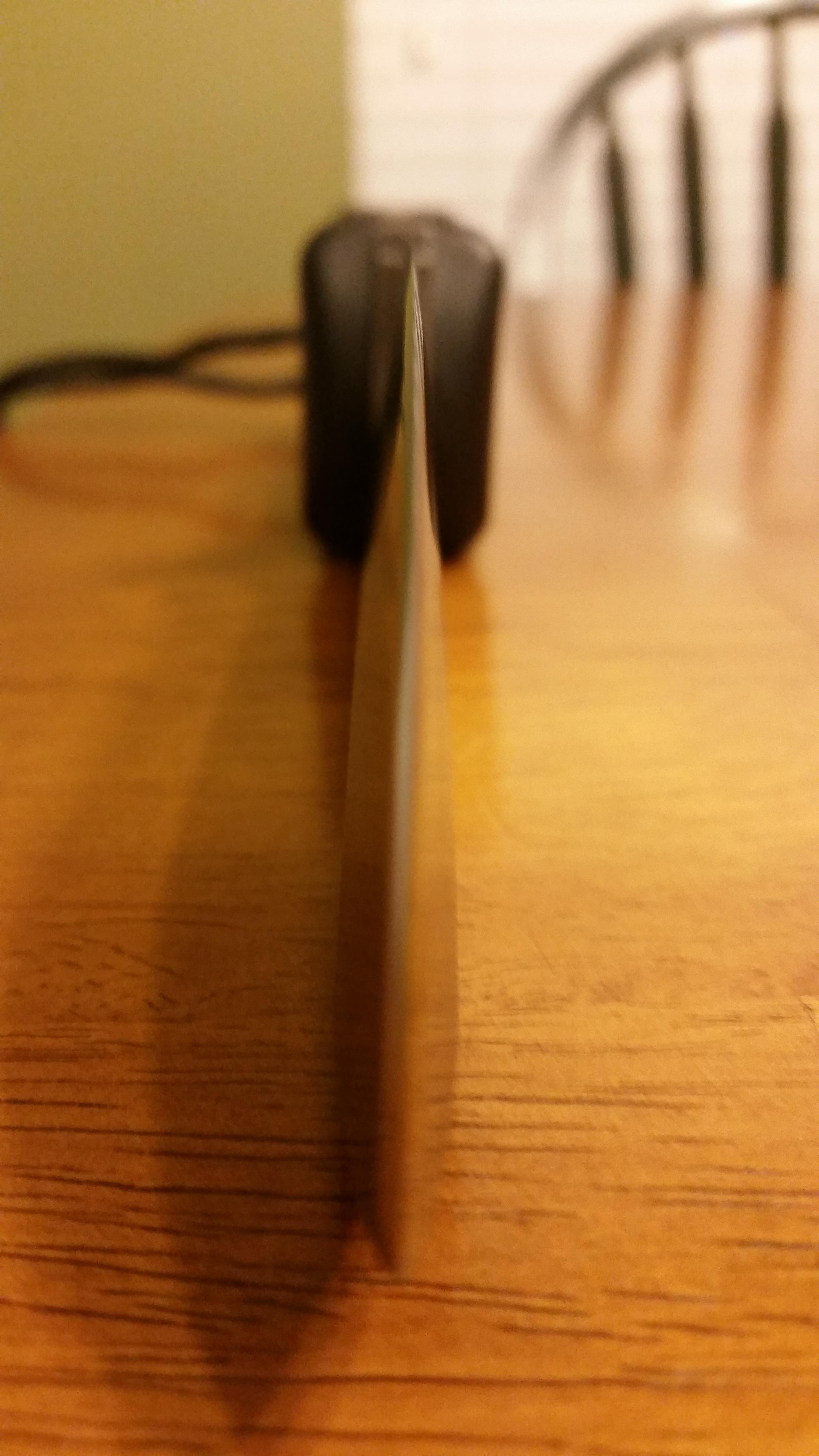

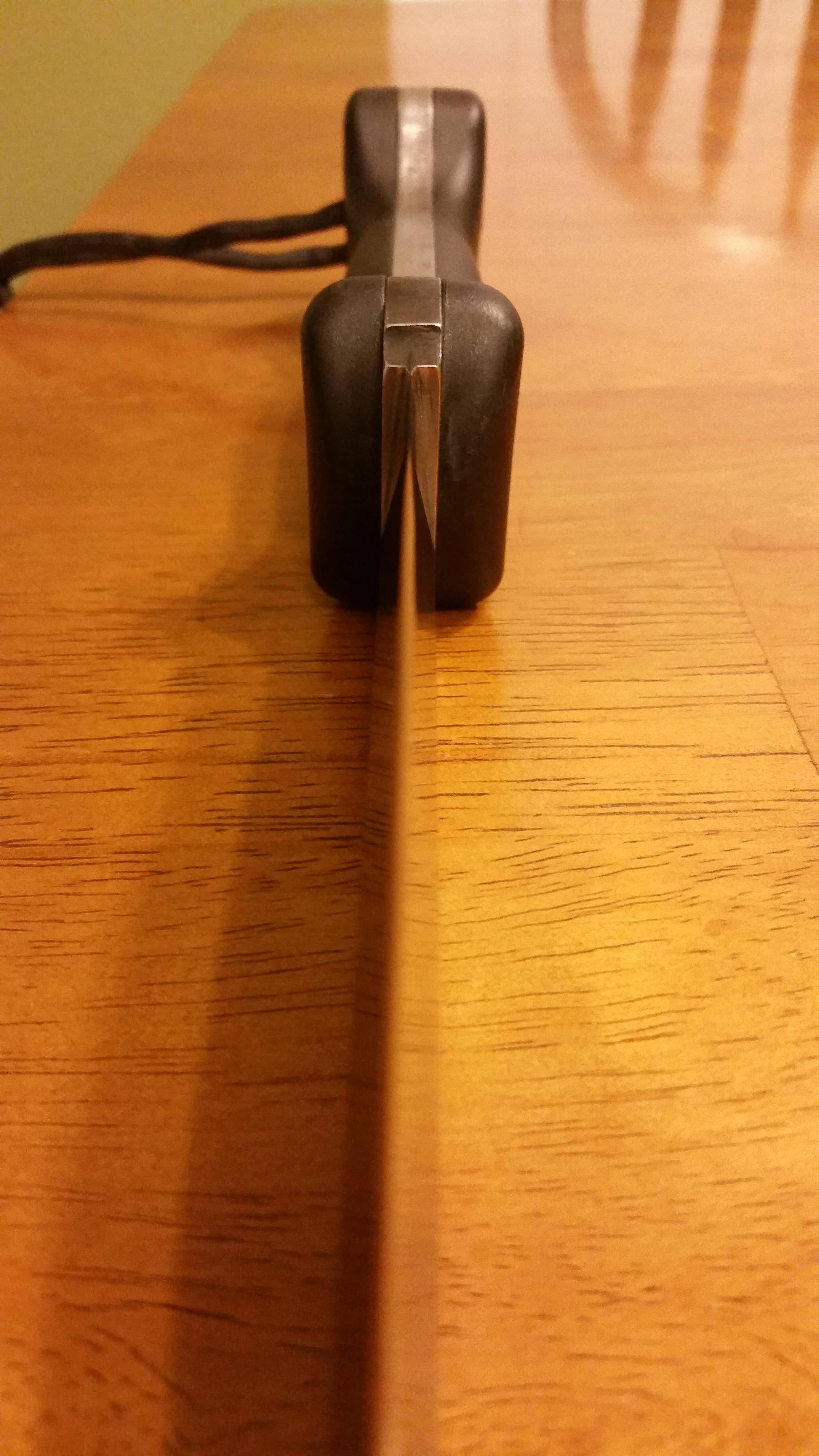

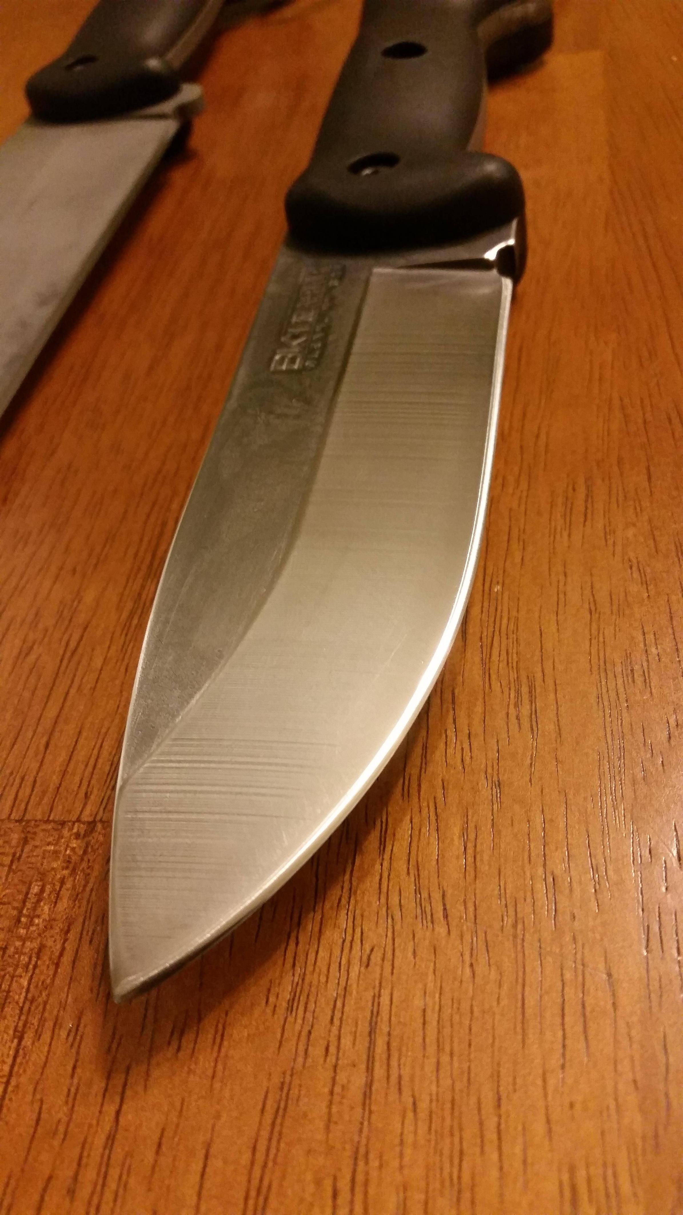

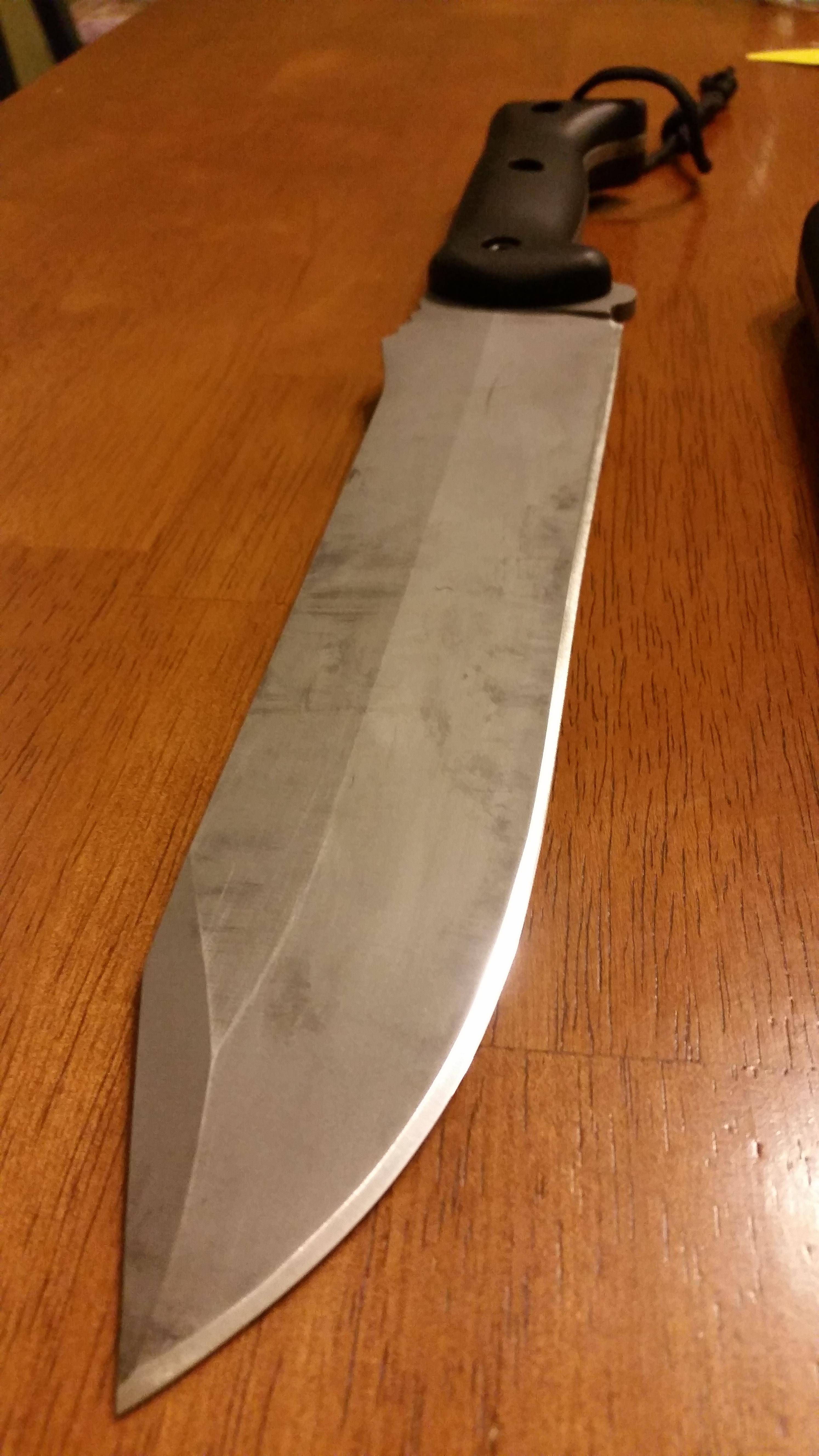

I just got home and looking them over, the 9 isn't as sharp as it was initially (before I could easily cut hanging phone book paper into thin slices, now it just will slice larger pieces) but I think it'll strop back...The 2 has a minor roll near the belly, and the BOB has a very small chip (Damn rock) .
Overall very pleased with edge retention and performance, especially since the 9 I really beat on and is roughly 30° inclusive, the 2 is 34° inclusive and the BOB has a 30° as well.
I feel the bk2 with a convex 17dps is a good compromise of durability and sharpness. It'll withstand the abuse, but will still easily make feathersticks and carve.
I just got home and looking them over, the 9 isn't as sharp as it was initially (before I could easily cut hanging phone book paper into thin slices, now it just will slice larger pieces) but I think it'll strop back...The 2 has a minor roll near the belly, and the BOB has a very small chip (Damn rock).
But the BK2 edge rolled. And the BOB chipped. Would they have at more obtuse angles?
If your read what I wrote the edge as a whole didn't roll, there was a tiny lil spot in the belly of the blade where it reflected light, the size of a spec of dust that was gone within the first pass on the strop. Which I strop after use anyway, no big deal.
The BOB is actually more obtuse than factory as it comes with a 11dps edge. It chipped from a rock which likely would have still happened with a 60° inclusive edge.
