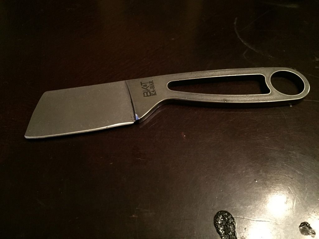

Hey , If/when you remove the paint on these lazer etched Becker knives, is the etching deep enough to keep it there if you end up polishing or sanding with 800 grit or what ever usage in the future?
Or before using paint stripper, has anyone used anything to etch whats there so its a deeper etch ?
I saw some vid where they used a nine volt battery and Q tip dipped in salt water to do etching. I dont know about that. I was thinking drop of acid....
Or maybe that would just make a mess a screw up the factory lazer etch ?
You will need to use something to etch the logo deeper should you want to keep it. PCB Etchant dripped on and left to sit for a bit would accomplish this fairly easily, although it can be some nasty stuff if one is not careful.
Also pretty easy to rig up an electro-etching setup. Googley. DC (battery), wire, q-tips and saltwater (add some vinegar if you have it). Lots of info on the interwebz. Also here on BF and in this SF as well.
I think a gun blue and bleach etch works really well. Just gun blue the sliver BK&T logo etch till its really dark. then put some bleach on it over night. it will rust the logo in pretty deep. then put some paint stripper on it and take off that traction coating.

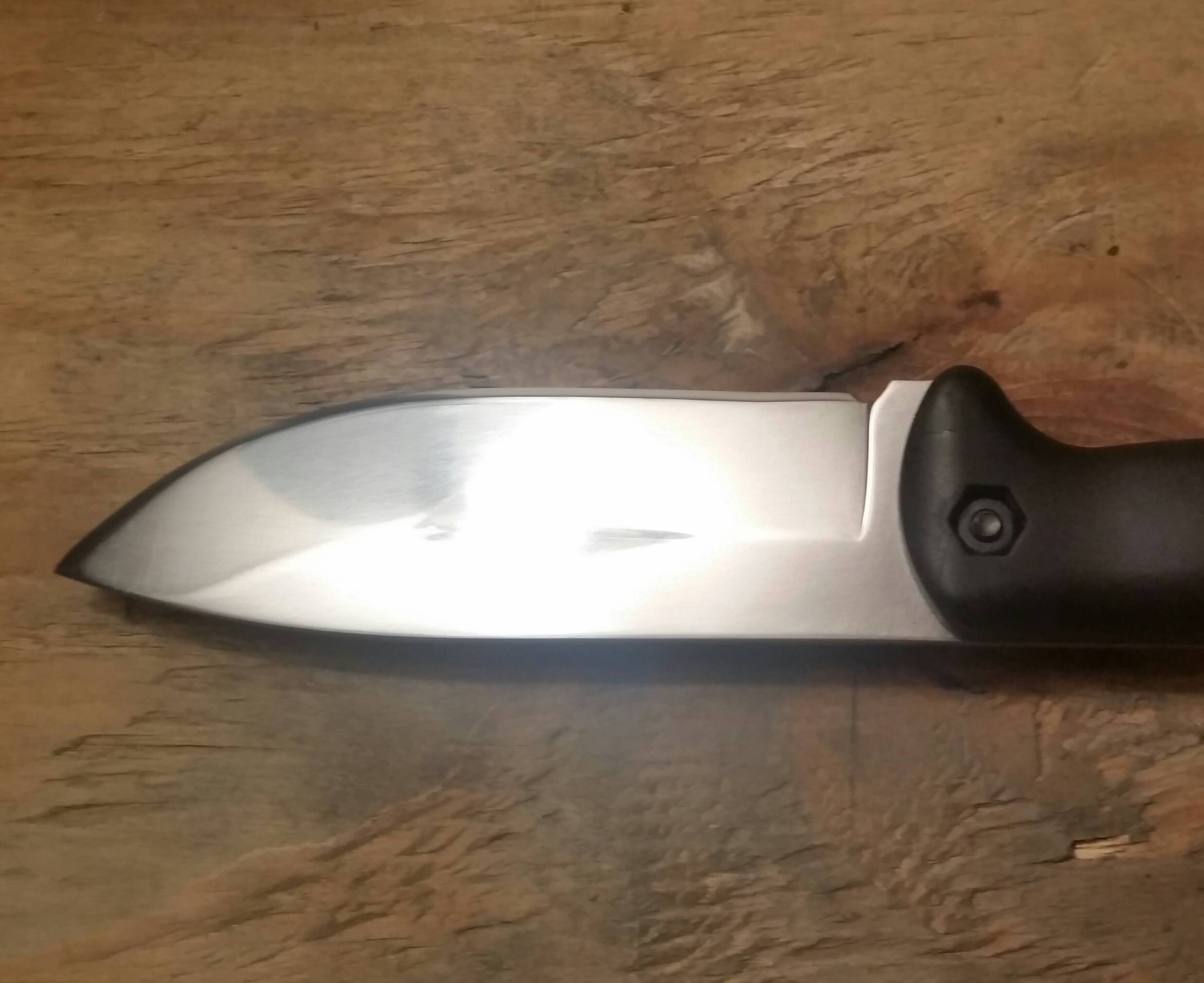

here is a photo of a knife I just did it to.
just make sure you leave the bleach on a good amount of time so it rusts really well, and really deep on the logo.

Electro etching is the best way I have found so far. Gets the nicest crispyest edges on the logo too.
PCB works, but is a pain for sure compared to electro etching. The qtip method works pretty good.
But with no etching at all, the logo will be pretty much gone if you do any sanding or bead blasting after the stripping. Great if you want a sterile knife or to put your own logos or designs on.

No, the lazer etch is not deep at all, just deep enough to penetrate the coating, just discolors the steel, and will not survive any kind of polishing or sanding.
Yes, there are several posts and YT vids on it.
But we do. ;) That simple setup is indeed all you need.
