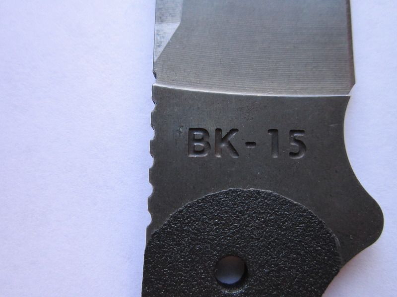

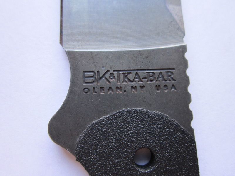

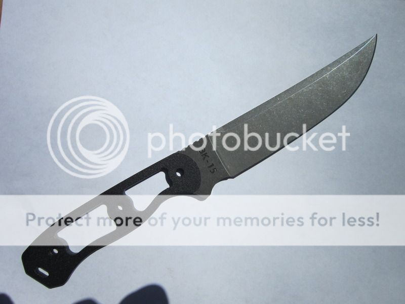

I just did my etching AC and DC
Battery charger on 10 amps for DC etching , 8 Q-tip ends worth per side
For AC I used a colman lantern wall charger: output 12vac 400ma... Worked great for the blackening and one fast pass and it was blackened, piece of cake.
The AC blackening is amazing
Now to strip .....

You are more than welcome. I did the vinyl resist on my 9; the AC blackening will scrub off pretty easily in my experience, tho.
I didn't go that deep, though - it was a LOT of etching to do. Maybe that's why the black is off now - though it did come off pretty easily.
Here's the thread: Celtic Pattern etching my 9
I scrubbed mine after I finished with a old tooth brush and a bit of toothpaste,,,put a finger of baking soda on there too and rinsed with water to neutralize any acid... I think it polished off alittle ac black on the 'T' or I thought it wasnt completely blacked. So I just hit it with a AC Q tip a bit more
Nice job man!!
That came out fantastic.
Did notice the little A's lost the inside. They are tricky for sure. Have to be super carfull not to Touch or flake off the little bit of coating there, and even then you wil lose them most of the time.
