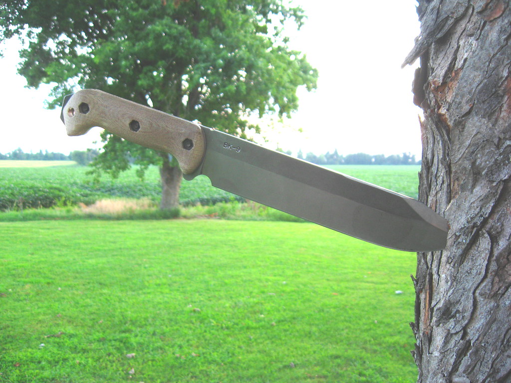

I put jimping, a firesteel notch (works pretty decent, my firesteel is crap) and a billy can lifter notch on the blade and made a leather sheath. It's the second sheath I ever made, and I think it turned out pretty nice :D

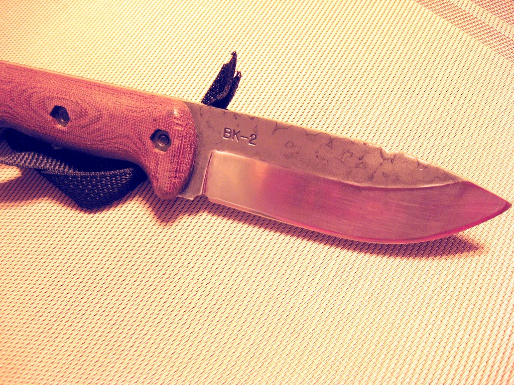

Here's my 2 stripped, convexed, pot lifter notch, patina, micarta stained and tru-oiled. Webbing lanyard lets me flail the hell out of wood without "Maethoring" a knee.

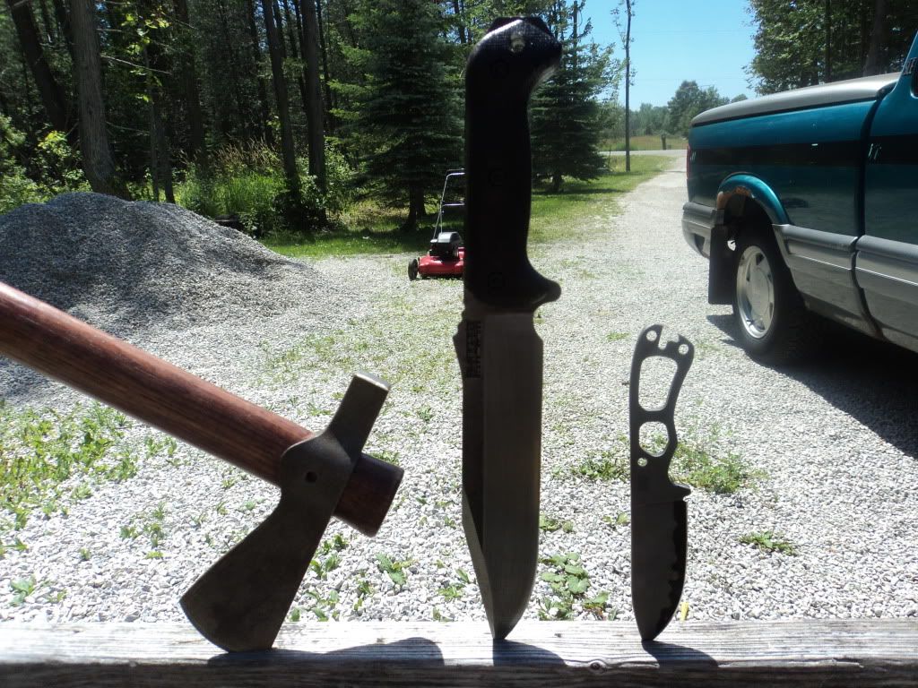

BK9 Fighter project:
Started with:
Stripped, Clip sharpened, Thumb ramp removed:
Blade fuller milled:
Customized micarta, Jimping added, Cold Blued, Stainless hardware, Pommel reshaped:
Sheath fitted with a large teklok and added plastic cable clamps to mount a firesteel (Warrior's idea).

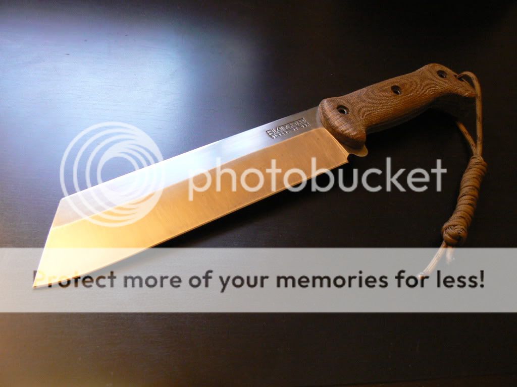

Jimping on a BK2, done with a dremel, and a small diamond file.
