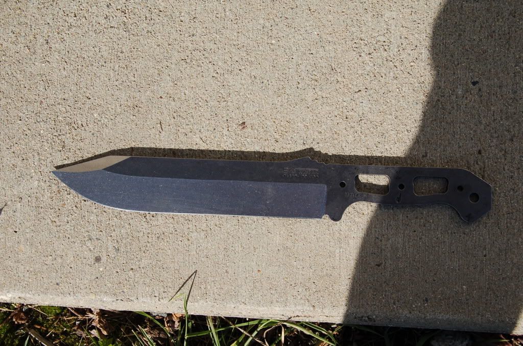

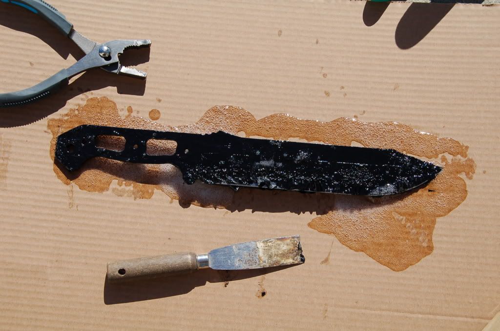

BK9 stripped, acid & stonewashed, convexed. Stonewash was via the dryer using 6" PVC and mini river rocks, had to stop at 45 minutes due to almost killing said dryer.

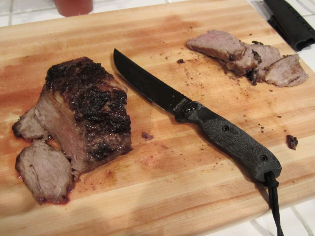

Eskabar. Stripped the finish, gave it some jimping, convexed it, and added the factory handle slabs and a simple lanyard...
Then I convexed another one, left the finish, added the orange handles, and a simple lanyard...

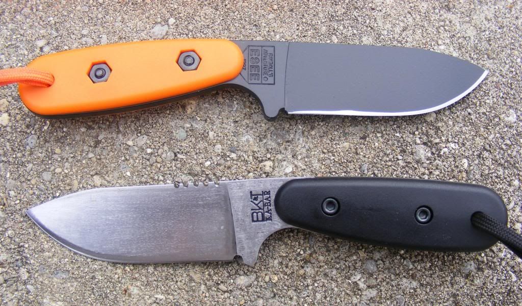

Then I had to add the Eskabar's handles to an Izula...
Been wanting to do this forever, and finally had the time this weekend. Jimping is still to be added, gonna touch up the edge, and I'm working on a new sheath.

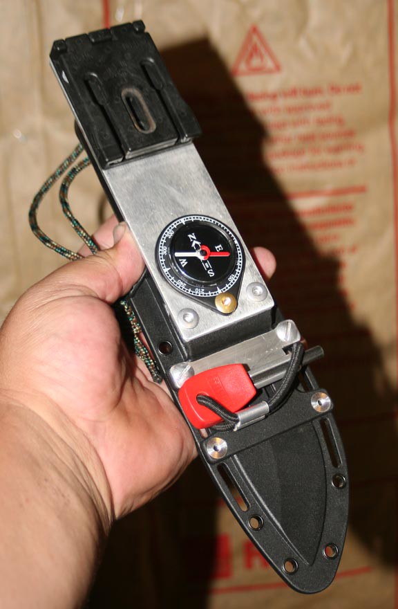

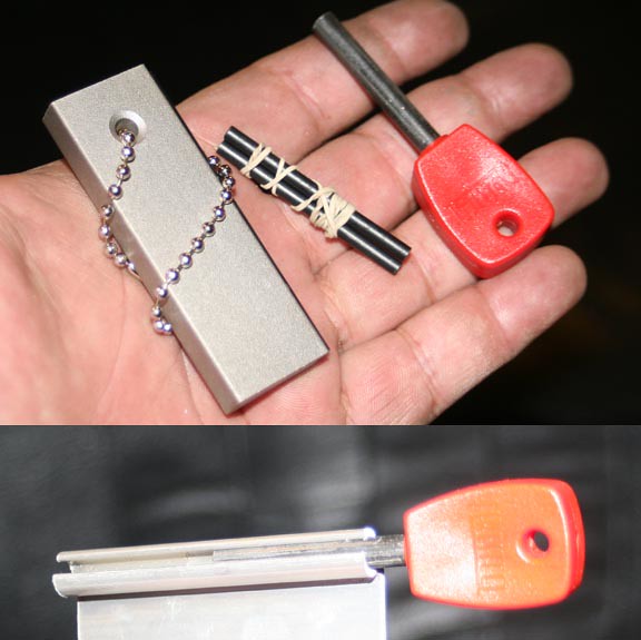

Some pics from user Echo2 over on BCUSA I snagged. Thought this was a very ingenious use around Floppy Sheath Syndrome that is common with the BK2, as well as his method for holding a firesteel.

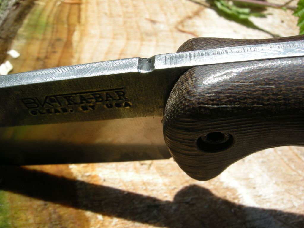

BK4, stripped and fitted with homemade blue and brown canvas micarta scales.
I used Bondo brand fiberglass resin and bought my canvas at Walmart. I only sanded to 220 grit because I wanted a really grippy handle for a sure grip through rain, sweat, fat, blood, snow, and ice.
