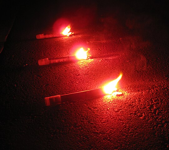

The last time I started a camp fire I used one of these:
Is that cheating?
I also want to say that this sounds like a great idea. (if I can get off my lazy butt!)
Not at all. I've been thinking about putting a couple flares in my winter trekking kit should I ever break through the ice. Its times like those that you need fire NOW.
If you use a flare make sure to have some larger (larger than about 1") wood on hand. I had a bunch of small stuff that burned up extremely quick with the heat from from the flare.

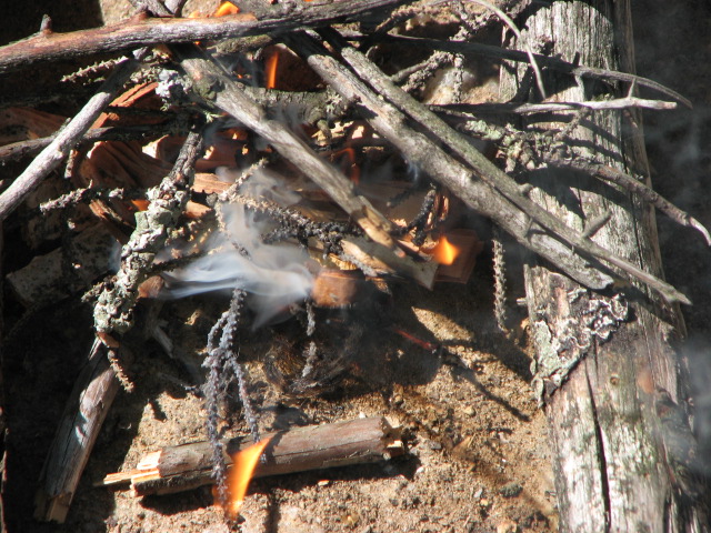

This one was on a drizzly, snowy spring day. It started hard but some dry leaves I scavenged from under an eroded tree root system did the trick? You can see the ground is pretty damp.
I look for dry pine needles, leaves, hanging dead branches,
It took a few tries, but it caught,
If I have problems it's usually in the transitional stage.

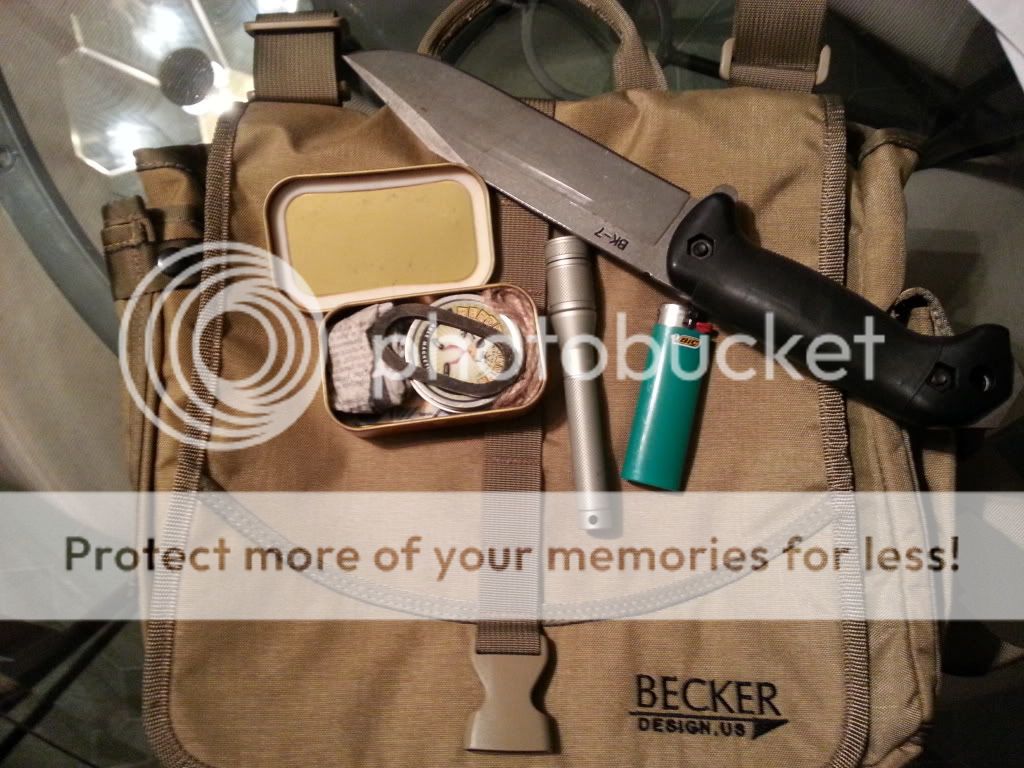

I don't really have any tips or tricks except what I've learned from here. I keep PCB in my go bag along with my camp bag.

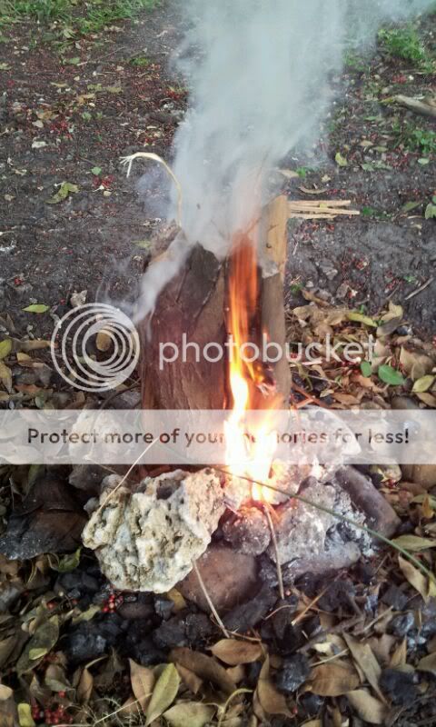

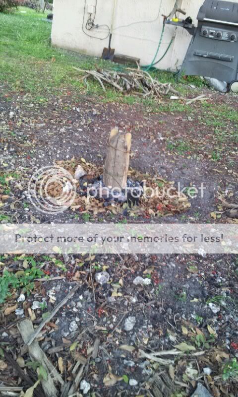

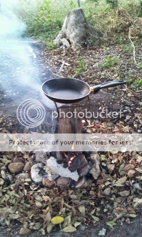

I don't know if it is the right name, but I know it as a sweddish stove. It works best if you have a saw and can get straight edges on a thick log. Split the log in half, then halve the sections. Tie loosely in the original form with cord or vine and stuff tinder between the sections. Use your preferred fire starting method to light up the tinder, and you have a stove as the wood burns from the inside
That chicken came out pretty good! As for fire making I like to keep firestraws and fatwood shavings close at hand, rods, lighters and waterproof matches. Recently bought a fire piston and still trying it out, will definitely try to do the bow drill with moose's tutorial

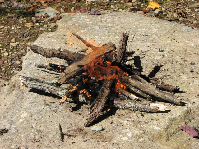

FIRE BUILDING
Fire is so important to survival, just think of where we would be today if we didn't have fire. For me practicing building a fire is different than making a flame. If your young scouts only practice firebuilding as having a flame you are only teaching them half the process of firemaking. I see a lot of scouts get the flame and not prepare the firelay or have the extra fuel needed for the fire only to have their flame quickly burn out leaving the scout without the feeling of complete success.
First to talk about ignition sources, ways to make a flame. In these methods you will see me use the frayed parts of a natural fibre rope and charred cotton cloth (charcloth).
A type of magnifying glass - this one is part of a compass. Focus the light through the magnifying glass into a concentrated spot and you wll see it begin to glow.
Wrap it in the nest loosly and give it air and you have flame.
A modern "flint and steel" set. (The striker is also a whistle which you can use for SIGNALING). First set up your tinder bundle withe the nest and charcloth in the middle. Scrape the steel
down the flint rod to throw sparks on the charcloth.
Watch for one of the sparks to develope into a glow in the charcloth. When you see the char cloth glow wrap it in the nest loosly and give it air and you have flame.
Matches in a waterproof case. For me this is two ways to start a fire. Inside the match case I keep matches, the strike plates (torn for the side of the match box) and some cotton balls. Also in my pouch I carry something for chapped lips. I carry the kind that is like vasoline because I can also use it to spread on the cotton balls to help them to burn longer. I'm not going to make a fire using the match because hopefully you guys already have this concept down.
However what I am going to talk about is the matchcase. On the bottom of most of these waterproof match cases is a small piece of flint, when you also have a knife you can throw a spark into your catton ball with vasoline, wrapped in your nest.
When you see the cotton ball begin to burn wrap it in the nest loosly and give it air and you have a nice flame.
The Magnesium firestarter..a bar of magnesium with a flint striker on the other side. On the magnesium side use a knife to scrape a small pile of shavings (about the size of a fifty cent coin). The problem I always found was keeping the shavings together without bumping and scattering all the shavings...the trick is to spread some of the "chapstick" vasoline onto a cotton ball and the shavings will stick to it and not scatter into the four winds. Also magnesium burns hot....but real fast... so you have to be ready for the quick flame. The cotton ball also cures this problem because the magnesuim will light the cotton ball. Once you have the pile of magnesium, turn the bar over for the striker and strike it into the magnesium pile.
Don't forget to wrap it into your birdsnest. When the spark hits the magnesium you have flame.
The disposable Lighter. Three points about the disposiable lighter. One- some of them come with a flame adjustment on the back, some don't and just produce a small flame. Try to get one that you can adjust into a larger flame. Point two - a lot of people try to light a campfire with a disposable lighter and the hold the flame on for a couple of minutes to light the fire only to find that the extended time they kept the flame on has melted the plastic workings of the lighter and now you may throw away of the lighter with the full amount of fuel left in the lighter. Third point is just because it runs out of butane it still can throw a spark, sparks as you know can start fires.
One thing I tell my guys is carry a candle. A match may last 10 - 15 seconds but if you light the candle it will give you 20-25 minutes to get your fire lit. Also in the photo are some pop bottle cap firestarter. Place a cotton string in the cap and fill with wax. When it comes time to lite your fire lite your wick and place the whole thing in your firelay.
Alcohol based hand gel is an excellent fire starter. Squirt some in your tinder bundle and all it takes is a spark to get it going.
As we talked about previously, the flame is only part of the fire making process. The young scout should remember that before trying to get the flame they must have a shelter for their flame to live in to grow into a nice warm fire. Also to grow their flame will need to be fed small sticks then when it gets bigger it can have bigger sticks.
Just like people build a sheter for themselves they will need to build one for their flame. These shelters are called firelays.
By pushing a stick diagionally into the ground and then beginning to build the sides up with small sticks and then larger ones. The young scout will find a shelter much like the debris shelter he built for himself, only using sticks instread of so many leaves. Once built you make your flame place it in the shelter you have made for it and with care it will grow and help keep you warm and safe.
Another firelay is the traditional teepee firelay. Lean the sticks into each other like a teepee and you have another shelter for your flame to grow into.
The third is the lean to type firelay. Find a big log and lay the sticks against it. Remember use small sticks first because a flame must eat small stuff first before it can grow and eat bigger sticks.
Fires like to eat, just like we do. If you do not feed them they die so have plenty of sticks ready to feed your fire before you make a flame.
