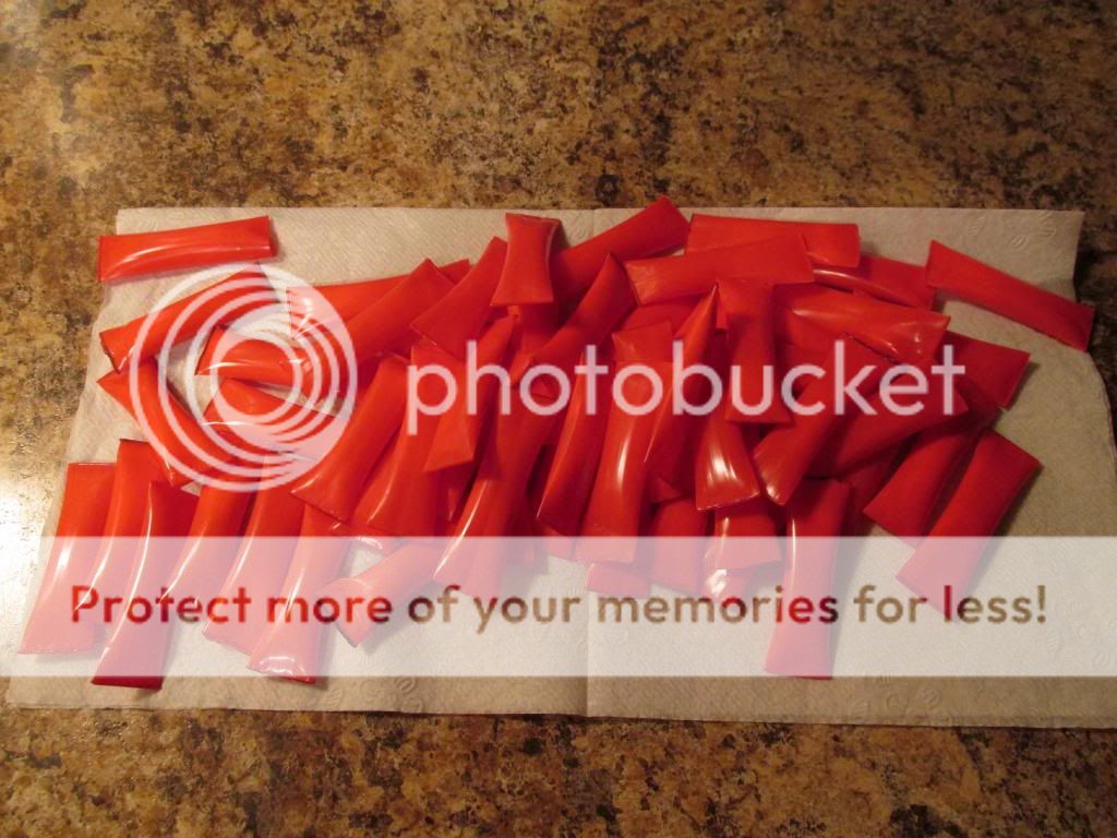

Fire straws are a convenient way of carrying waterproof tinder. For this post I am showing petroleum jelly and cotton balls but you can add whatever you want on them. This method is even good for packing spices and stuff for cooking in the woods.
First you need 100% pure cotton balls and petroleum jelly. I like the jumbo size because I make petroleum jelly cotton balls without the straws too.

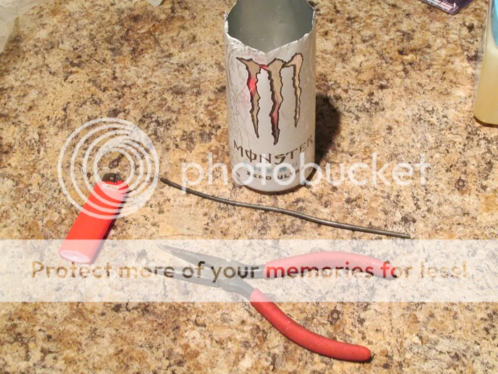

Tools to help making the fire straws. A can with the top cut of to melt the petroleum jelly, a stiff piece of wire or something similar to help stuff the straws (long thin tweezers will works to), and a lighter and needle nose pliers to seal the straws.

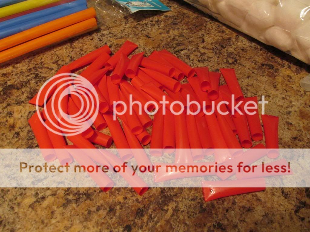

Cut the straws to the length you want and hold in the pliers like this. Then melt the end with the lighter and either wait till it is cool before you let go or dip the end in water to cool it faster. Do not dip the entire straw because you will trap water in with your tinder defeating the purpose of the straw.
You should have a pile like this. I use fat milkshake straws because they hold a lot more and are easier to work with.
Melt the petroleum jelly like this. Put a big blob in the can and set it in a small pot of water on the stove. Heat slowly and wait for it to turn into a liquid.
Pour the melted petroleum jelly onto the cotton balls and mix. You can also dip the cotton balls in the melted petroleum jelly and then stuff the straws.
Seal the other end up and your done. Be careful though. If any petroleum jelly oozes out clean it off before lighting the straw to seal it. it will catch on fire.
To use them in the field cut the straw open and fluff the cotton out of the straw, then hit with sparks from a ferro rod or an open flame.

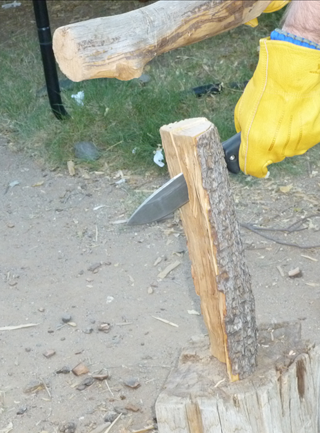

A lot of this is going to be obvious to folks here, but I cannot believe the number of people with whom I camp that don't know the basics. It usually starts when I break out a knife or axe and they say, "What are you doing? I usually just pour a bunch of lighter fluid on the logs and go."

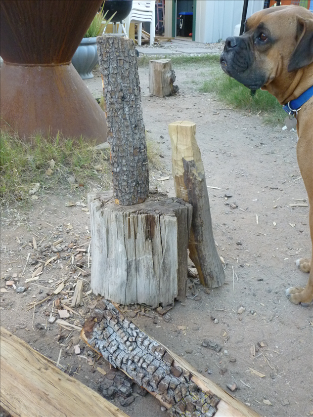

Get yer tools ready. Find a stump or some wooden anvil on which to split the wood. #2 son fashioned the baton about a month ago. I haven't yet told him that baton is French for 'last log in the fire.' The boxer is providing overwatch.

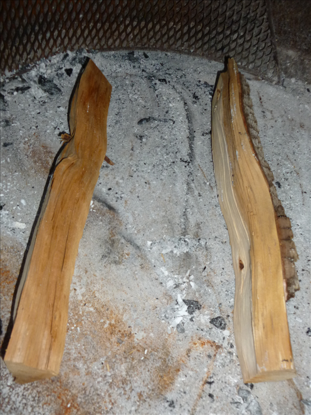

Wear gloves if you have them. Take your time splitting the wood into appropriate sizes. Then split a bunch of extra wood to feed the fire after you get it lit. These are small half-logs, about 18" long. I like to have forearm to wrist size for the fire base. Know the limitations of your tools.
I look for wood with a nice, straight grain for making into the small stuff.
I split a bunch of finger to pencil sized pieces. I prefer split wood to sticks and twigs, as it lights better.

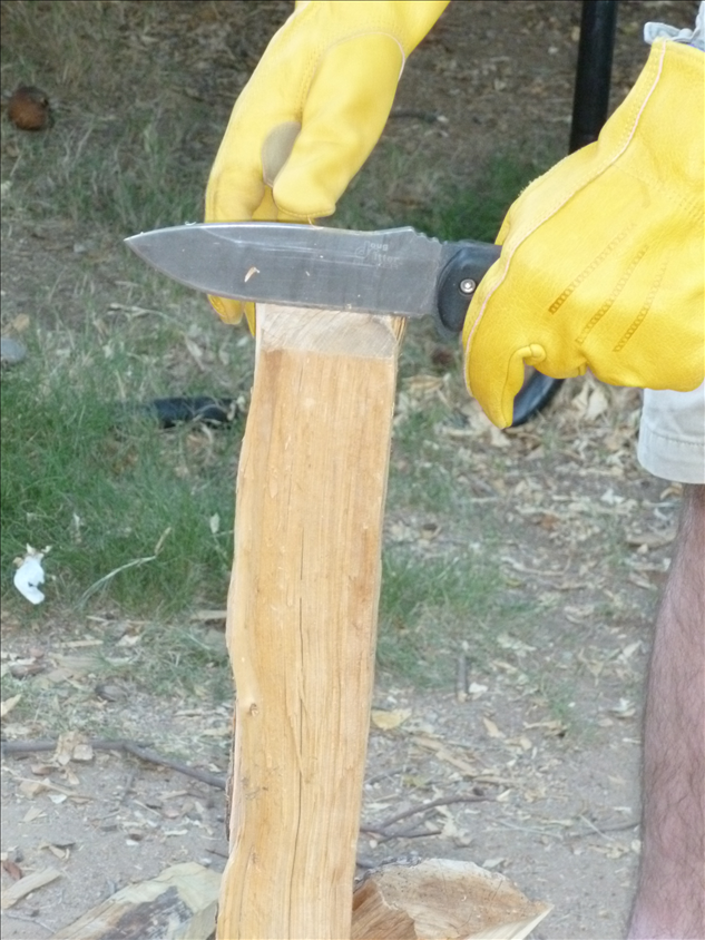

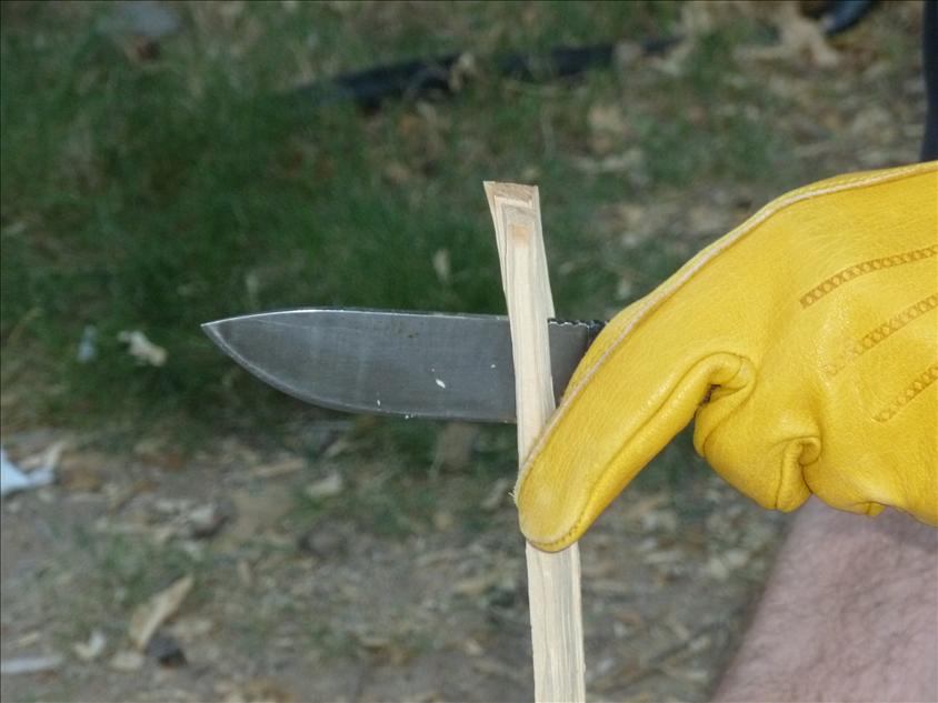

For pencil and smaller sizes, it may be easier to use a thinner blade. But in the woods, you run what you brung.

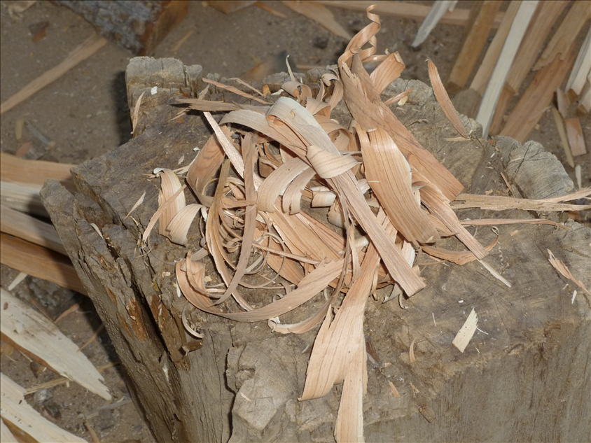

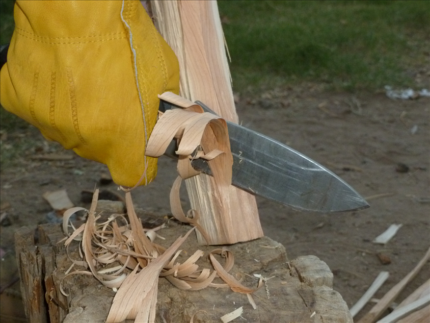

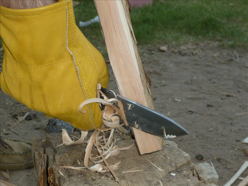

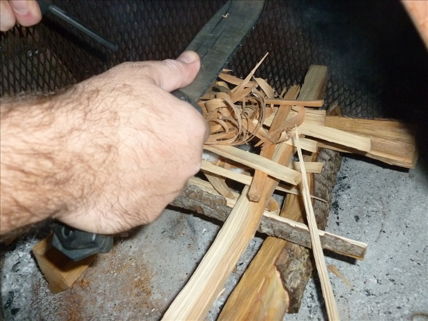

Shavings are important. I can't cut pretty feather sticks worth a damn, but the Beckers all make nice shavings. I run the blade up and down a bunch, then slice off a set of curls. It's also good to keep the curls in one place, not all over the campground. This is why I don't have my kids make shavings for me. They're regular beavers, but you need a rake to collect the shavings.
More shavings. Here, I'm using the 12 and they are nice, thin, and wide.
A decent pile of shavings. More is rarely a bad idea.

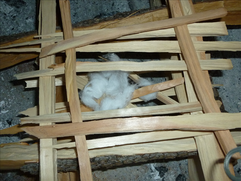

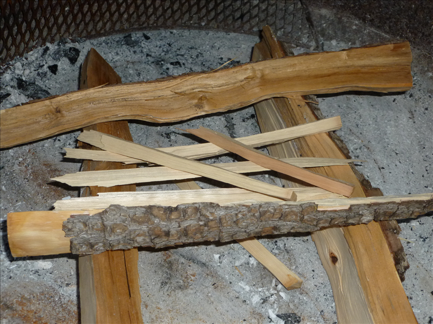

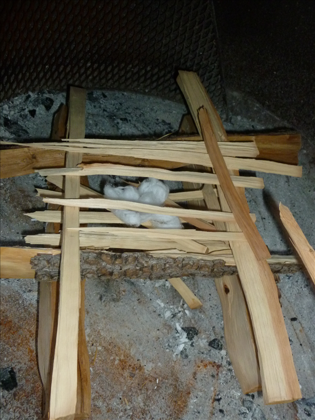

I do this weird hybrid of a log cabin and tipi lay. It starts like the cabin. Wrist+ size for the base. This keeps the tinder and small stuff off the ground where the dampness and cold can suck the heat. A lot of people don't understand the fire triangle: Fuel, Oxygen, and Heat. Elevating the wood also provides airflow underneath.
I go crosswise with slightly smaller pieces, then finger to pencil size in the center. This is the level on which I'll lay my cotton or jute.
About inch-thick pieces on the outside again, then pencil and smaller over top. Be careful not to completely occlude the tinder. You want space to throw that spark.
Another set of crossbeams. Notice this gives lots of space for air.
Shavings on top. The pencil- and shavings go above the tinder because heat rises. Make sure you don't block access to the tinder.
Once it's set up, go split some more wood if you need more for feeding the infant fire.
It might take a few strikes, but I can often start the fire with the first one. I have filed a flat spot on the spine for this purpose. I put it beyond where my thumb might land on the spine, but still as close to the handle as possible.
I leave the knife stationary and pull the striker back. This way, I don't knock into my fire lay. This pic captured my stroke, and you can see the smoke already rise from the cotton. The cotton is dry, not petroleum-impregnated. That isn't a recommendation, it's just what I usually do. I prefer cotton to jute, because you have to spend more time fluffing the jute and making a bird's nest. Jute also seems to burn up faster. Still, I regularly carry both.

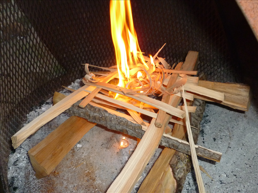

The cotton has caught the small stuff above. Get ready to start feeding it more.
Feed in incremental sizes. Too thick, too fast, and the whole thing will smoulder, perhaps even go out.
Here, it begins to look like a tipi. I like to lay the pieces this way so they can get heat, but not suffocate the stuff that's already alight.

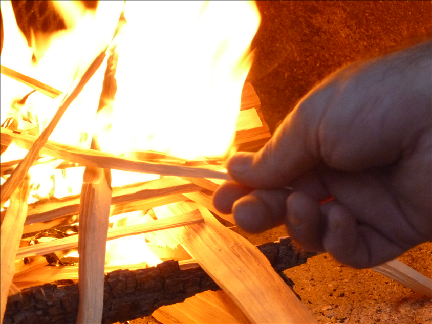

I've switched to welding gloves 'cause it's really hot. I've got more pieces on deck in my left hand.

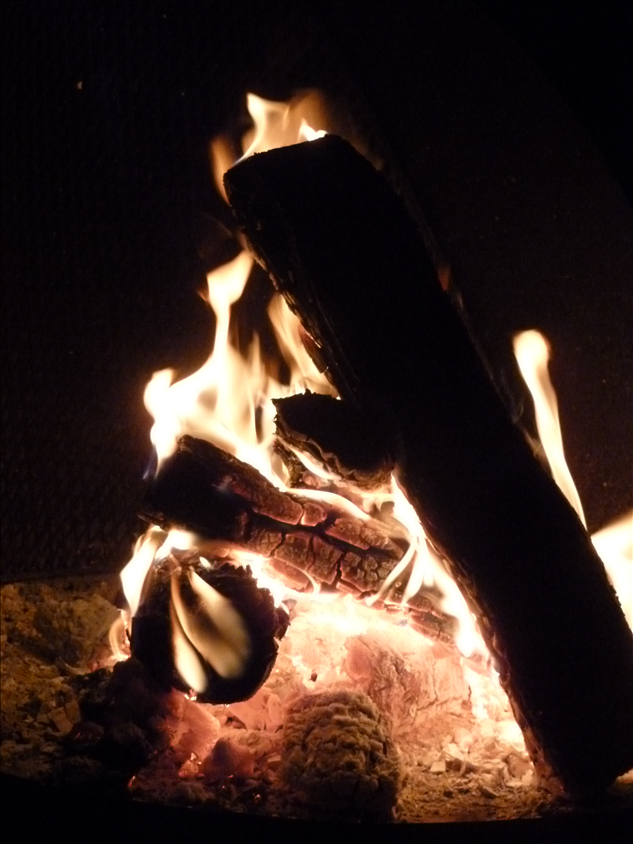

This is after a while of burning. Those coals are amazingly hot. I continue to lay new logs in the tipi format.

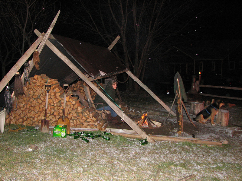

Fire Good,
Big Fire Better,
Make much light and heat,
Sometimes it's just nice to have a big fire,

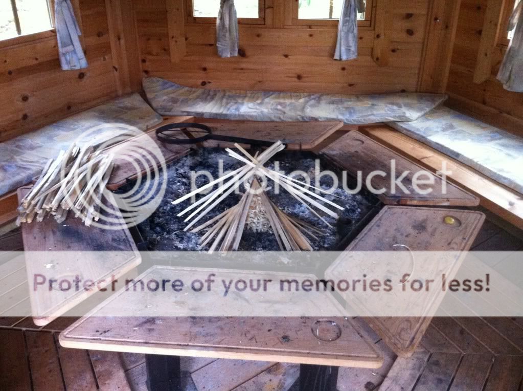

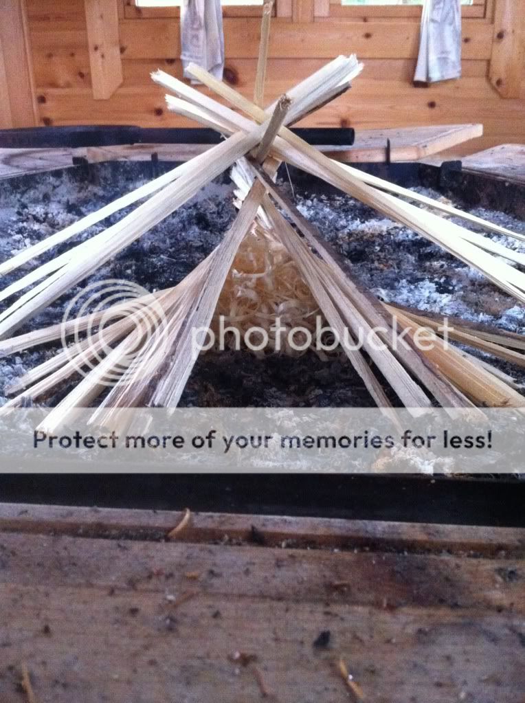

Just a couple of thoughts other than tis is a great thread.....

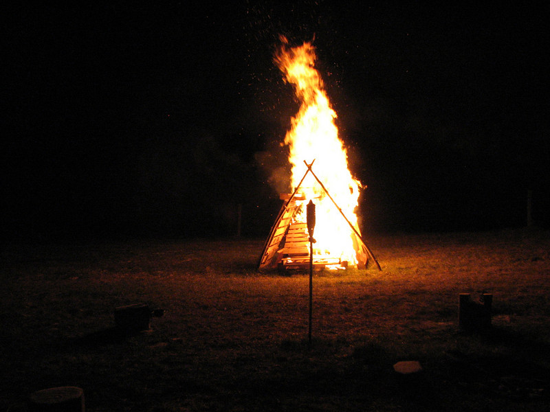

I always try to work against a largish log or a wall of fairly large sticks as fire LOVES to climb and the back log or wall acts as a chimney.......Lean your smaller stuff at a very steep angle with the tender under......
I will try to do a drawing this evening.....
